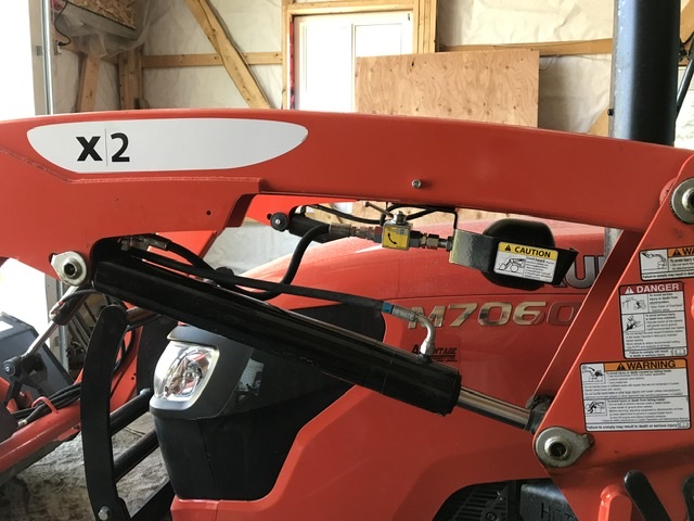

Before the manual valve? And just leave the manual valve in the on position, I guess?
Or you could replace the manual valve with the electric one.
   / Kubota "Shockless Ride", SoftDrive or equivalent accumulator? #12
Why would a person need to shut it off? Any drawback to leaving it on all the time?
   / Kubota "Shockless Ride", SoftDrive or equivalent accumulator? #13
May need two accumulators to cushion in a broader range of pressure/weight?
I have W.R. Long's aftermarket "Comfort Ride" on my Kubota L3560.
I like everything on my tractor as simple as possible. The valve is open 99% of the time. The other 1% I manually close the valve when lifting absolute max weight logs on Pallet Forks if I will be traversing very uneven ground with the load. (This means 1,200 pound Disc Harrow as counterbalance on the Three Point Hitch.)
While the pump is ~~2,300 psi max, the transient pressure of a bouncing load is 3,000?, 5,000?
I do not see the need to turn the valve on/off with an electrical switch when it is open 99% of the time, at least on Kubota LA805 Loader with 1,700 pounds lift.
I'll speculate the two offerings from Long involve different diameter orifices and nothing else.
One installation has been ample for my applications. There is only one set of hydraulics to the FEL. Where would you install a second hydraulic damper?

It looked like either system uses two accumulators connected together instead of one bigger one. Yours only have one?
See photo in Post #4. If the bulbs are accumulators, my Comfort Ride has two, at right angles.
