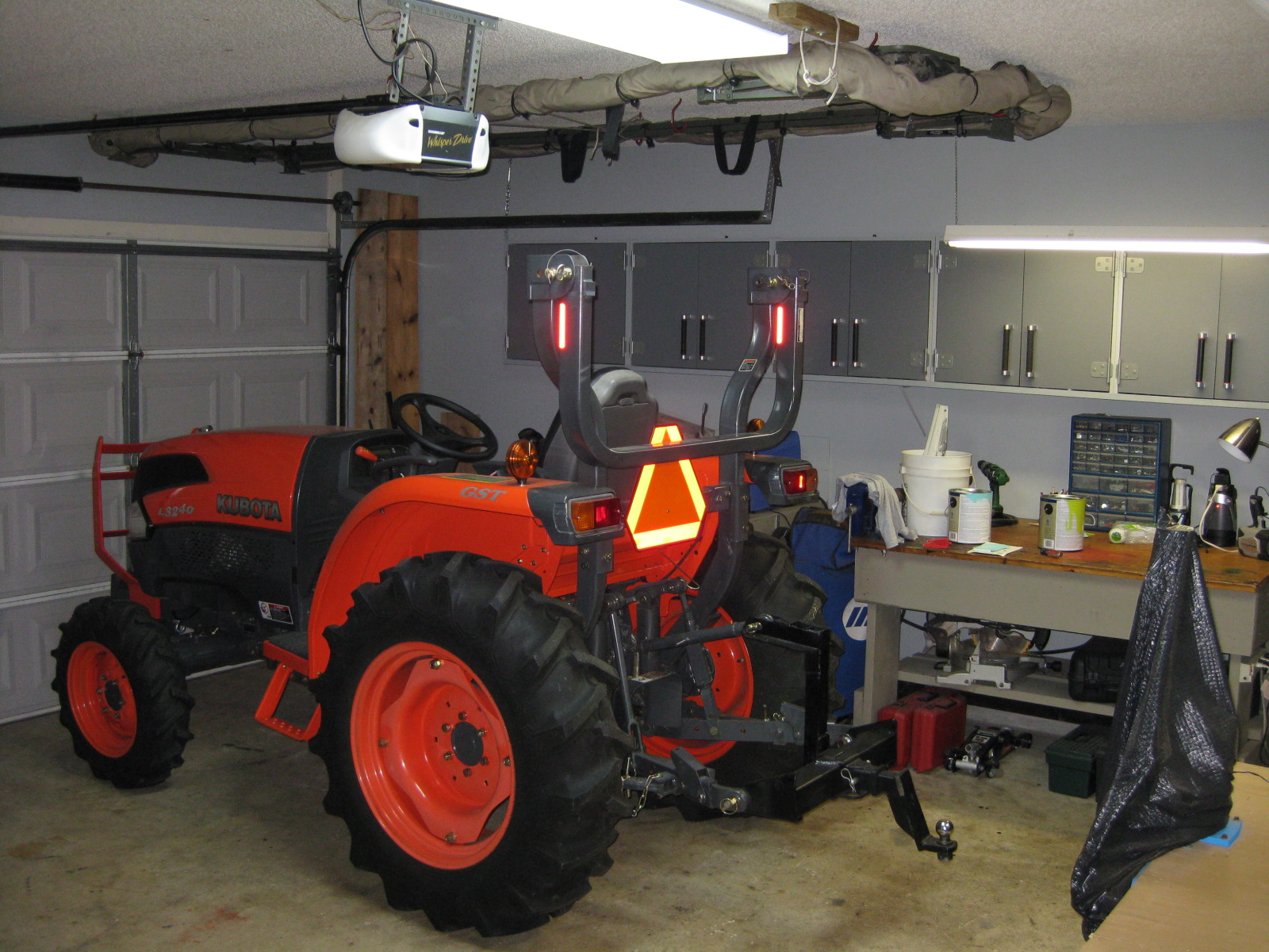

Well, now that I got your attention.. This is what I did today, instead of Kubota seat time. :mad: My 10yr daughter had to have her room painted so I painted this afternoon-evening. What we do for our kids:confused2: The 2nd picture is the Kubota all by her self in the garage. I had to take a picture of her so she would not feel neglected:confused2: Now Saturday Sunday I am going to our farm to finish so cutting- if I get the painting done:thumbsup: Can not complain to much the tractor is in the garage and the wifes car is in the drive way:D

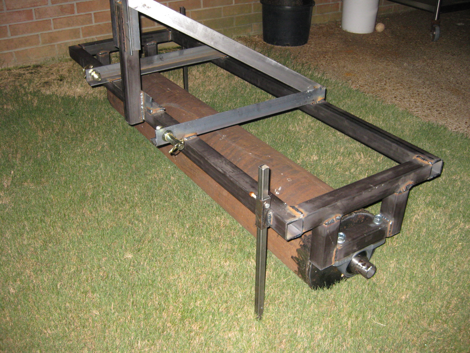

Hello again Andy !
Just wondering:Hows that home-brewed"Rocky Top"cultipacker been working out for you ?Had a chance to try it out?

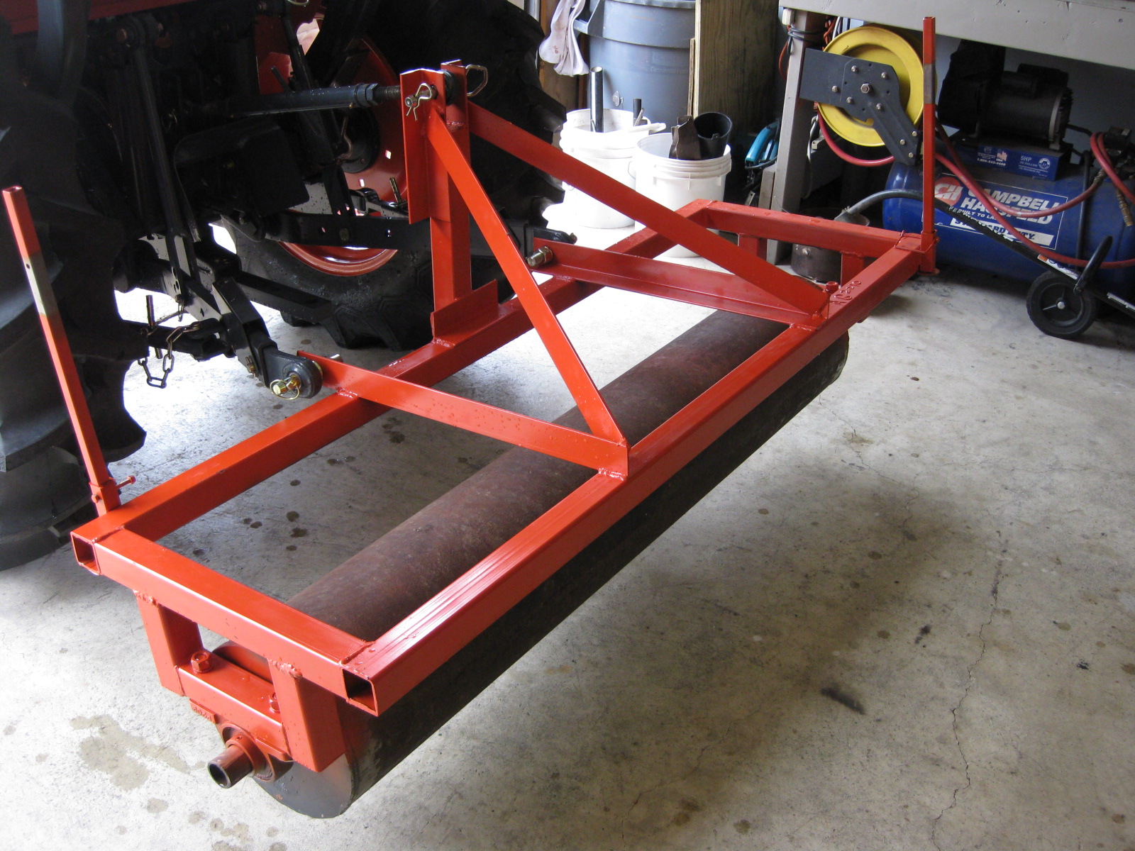

Hey Bull,
Cultipacker worked great- I think? What I mean is that I got all my plots in and used the cultipaker on them. Looked great- rained the next two days and everything came up perfect:D and then it didnt rain again that was 6 weeks ago. Went today, got some real seat time and the plots are gone. Everything died- with no rain and the heat they just didnt make it:mad: Now the good part is that I traded the cultipacker for a 6ft box blade.. Going to improve the design and make another one. I know people said the solid roller would not work but it worked great. It was heavy enough to break any dirt clods up... Do not know if I sent a final pic of it after painting...

I have a new L2800. I have had it three weeks and only got to mow with it once and spread some road base on the driveway.
I didn't get to go to the ranch this weekend and it is killing me. Where did you get your hitch? I need something like that.

Z55,
A friend of mine's sone was rearended and I got the reciever hitch off his chevy. Then I cut it to 24in. welded the frame wings back on but turned them upside down. Then simply welded a top linl peice on it and there you have it. Pretty cool for moving trailers around- don't have to get off the seat:thumbsup:

Agrantina, just curious where did you get the wall cabinets for your garage? Very nice.

Thanks for response!
No don't believe we saw pic of packer painted.Glad to hear you did some horse trading for boxblade.Can't wait to see next improved packer.
Will it still be 5' to make it through narrow path to food plot(s)?

Hey-- new improved packer will be 6ft, along with a few other adjustments:thumbsup: But I like the way it worked..
SRS,
Actually I got them at Lowes- discontiuned. They were only rated at 40 lbs so I ran a piece of 1in angle under the front and hooked that to a turn buckel to support the front so they would not sag down. Seem to work great so far.. not bad for 29.99 for one 2 door- I bought all I could find, then for the other side I bought unfinished ones and painted same color and called the fatory and ordered the same handles so they almost match:thumbsup:. I did the entire garage for less then $300.00 and thats about 15 ft of cabnets on 3 walls...

Andy, thanks for your reply. I'll have to check out the box stores.
