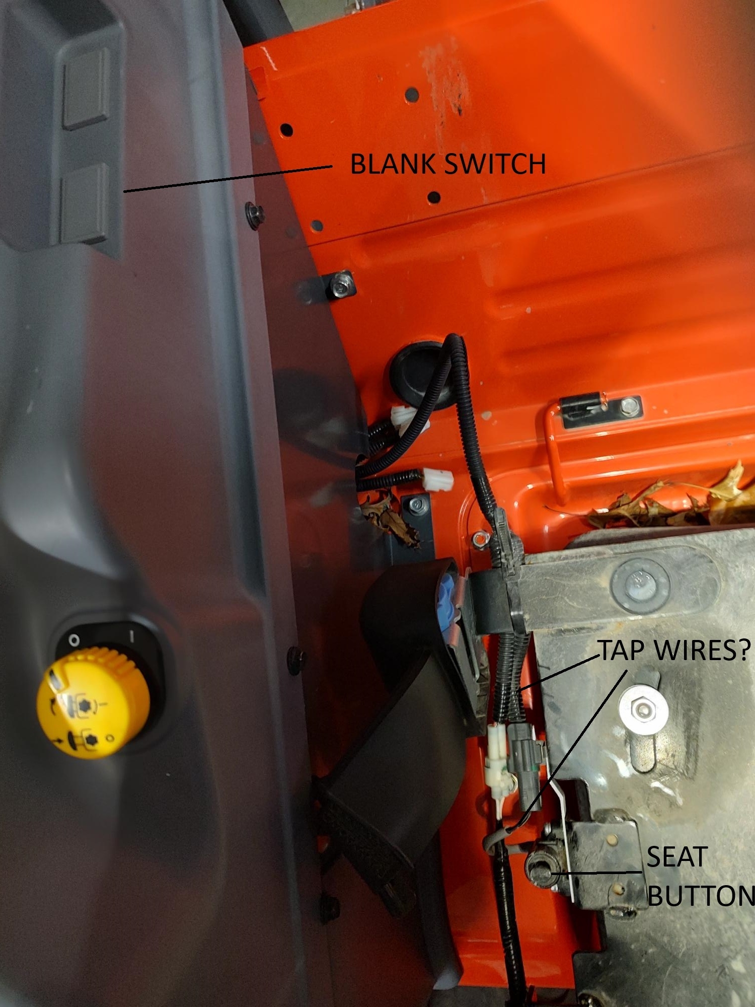

I would like to install a bypass seat safety/cutoff switch for my 2023 Kubota L4060 ROPS tractor. I do not want to permanently disable it, just be able to switch it off under certain limited circumstances, but keeping it engaged most all the time. I have attached a photo showing the wiring and location of the plunger style disengagement switch, and the blank spot to install a bypass switch. My question is, where do I tap into the wires... just after the plunger switch, or after the gray connector in the line...or do I disconnect the gray connector and jump it over to the bypass switch? Thanks.

The reason I'd like to have a bypass switch is not about using the PTO. If I am hooking up implements, either on the front or back end, I have limited visibility to get things lined up properly, but I do have a better view when on the ground. I used to be able to move the HST pedal by hand to accomplish this on my previous Kubota, but that is because I had permanently bypassed the seat switch. I don't want to go that far with this new tractor. As it is I have to get off, the tractor dies, I look at the lineup, get back on, start up the tractor, move it, get off, tractor dies.... This is not a PTO issue with me, I don't have a chipper or a generator, or the like. So page 89 is of no use to me. But hey, if there is another page I'm missing I'll be happy to go there.

You are correct, the tractor does not shut off when leaving the seat with the PTO off and HST pedal in neutral. However, if out of the seat and you attempt to move the tractor with the HST pedal it will shut down. So, I believe all the safety switches are working as they should and aren't the problem. I just want to be able to inch the HST pedal/tractor when not in the seat, and then disengage any bypass switch I've installed so all the safety switches are working while I am using or traveling the tractor. All I'm looking for is input on how to install a manual bypass switch, or even if it is not possible (I already know it is not recommended).
/ Kubota Seat Safety Switch #14
I would tap into the two wires just after they leave the seat pushbutton switch. Run your two new wires up to your remote switch location and connect them to your new bypass toggle switch. That way you are leaving the existing circuit intact. You will then have two ways of moving the tractor via the HST pedal - by sitting in the seat or by using the new remote switch. Turning off the remote switch reverts back to the original safety design of having to sit in the seat in order to not stall the engine when pressing the HST pedal.
Thank you, that is the response I was looking for.
