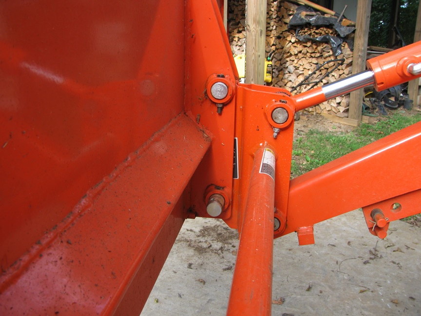

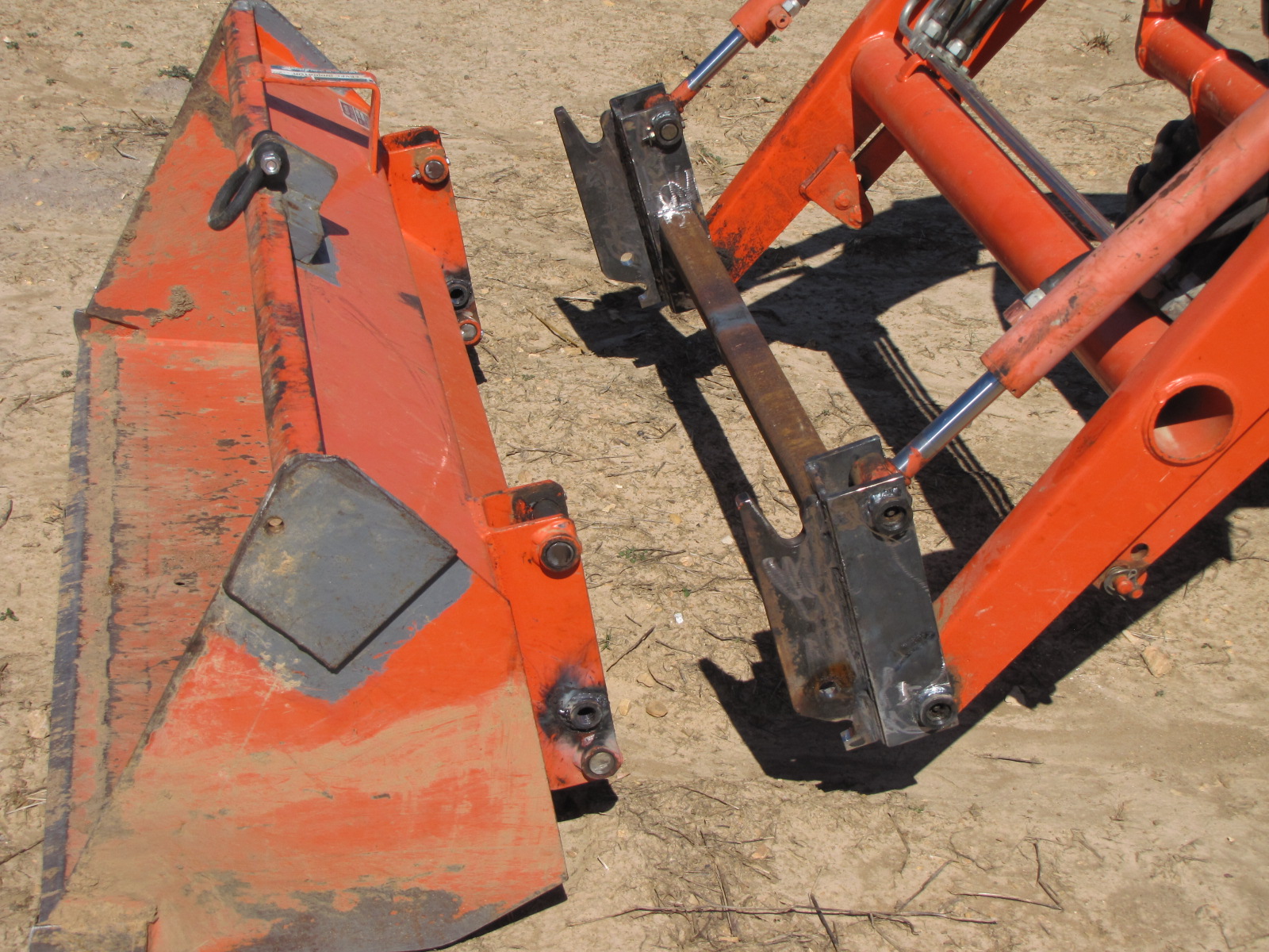

Well, I've searched and searched... But can't find a seller for a pin on style quick attach system for my b7800. I want to swap between forks and bucket easily, and my searches come up with nada. Any help? Yhanks!!!!
/ Kubota quick attach for b7800 #2
I made this set up for mine. I use it for the bucket and forks, I like it better then the one on my L4240.

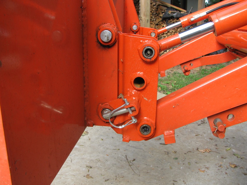

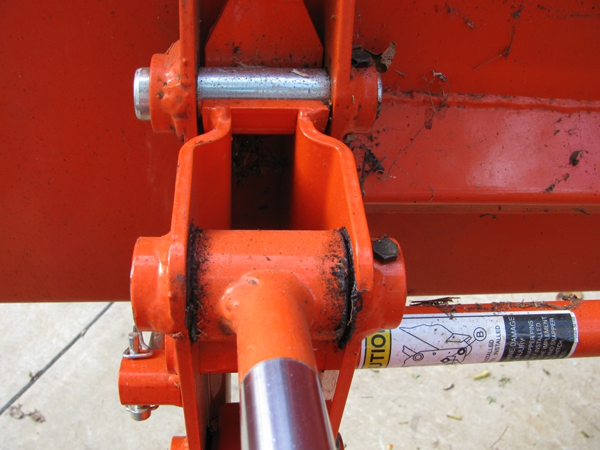

Kubota makes one for the LA504 and I believe it also fits other pin mount attachments. I have one on my B3200 and my neighbor has one on his B3300. If you want to compare mounts, I can take some measurements for you. It is Kubota P/N B1658. Not sure what other loader frames it fits but I suspect it also fits others.
John
KD4FTA
/ Kubota quick attach for b7800 #5
Here's some pics of my B1658 QA. If you call Kubota, don't ask the parts dept. They won't know what you're talking about. Contact your salesman at the dealer.
