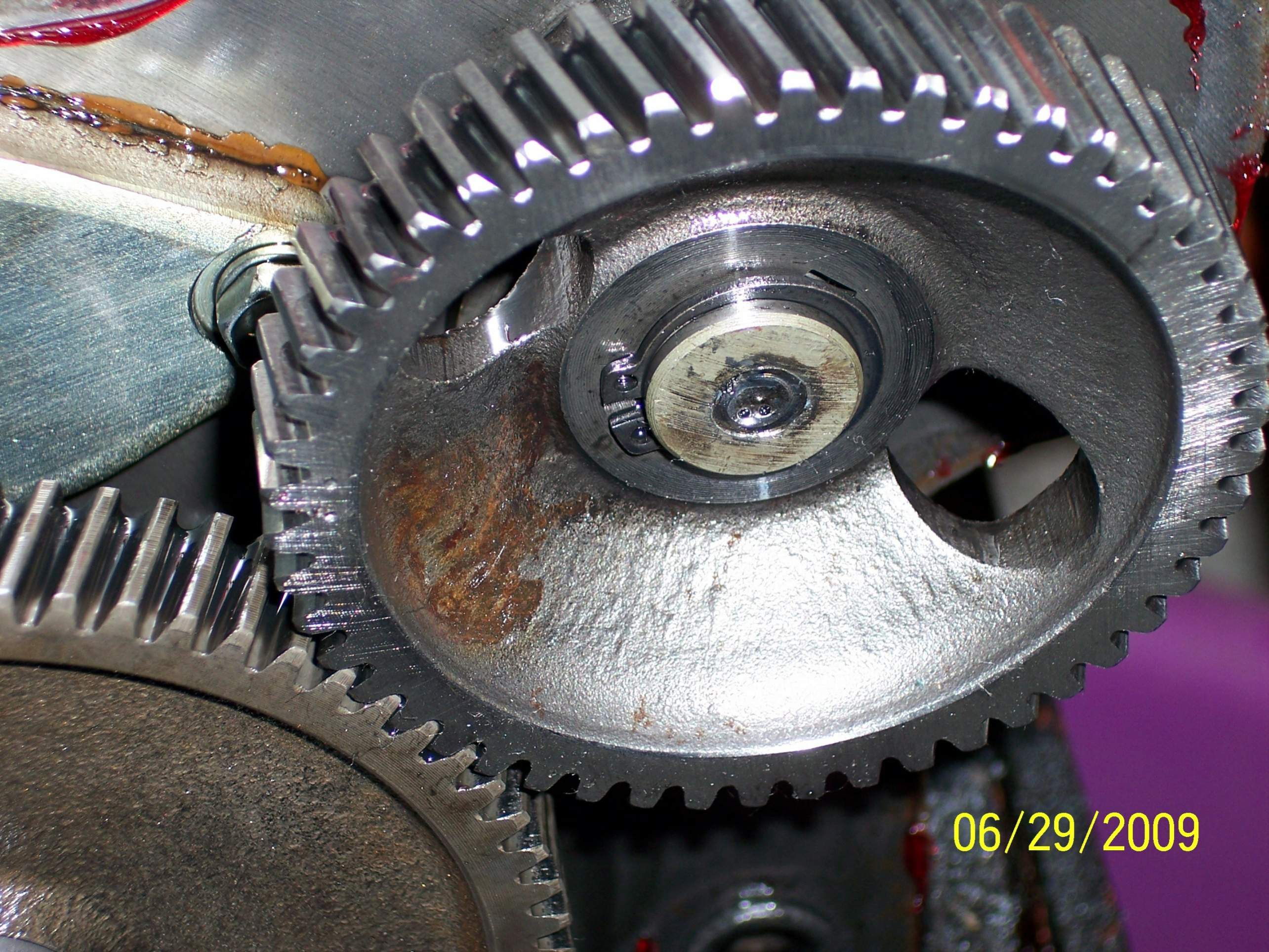

I've searched this on this site and have seen the problems with the plugs in the ends of the cam on the older Kubota B7100d. Mine is a 83 and has lost oil psi. It has 1300 hours on it. When you let it set and start it, if you let it idle the oil light will not come on, if you raise rpm off idle the light comes on and stays on. So here is what I have done so far.
1. Changed oil and filter
2. Cut top off old filter and looked inside, no metal
3. Removed front cover to have a look and see if plug was in front of cam, it is.
4. Removed oil pan and had a look in there no metal and is clean. Had a look at the oil pick up screen and nothing blocking it. Gave the rods and mains a shake and nothing seamed loose.
5. Put front cover back on and hooked up a old fuel oil pump to the stub that the oil filter goes on and primed it with oil and turned it on. Oil dripped from the mains and rods. Oil was running back trough the hole in the block from the front cover area. Looked inside the cover from the throttle hole and could see oil squirting from the gear in the center. Was showing about 3 psi on the gauge i have hooked where the sending unit for the oil light goes.
6. Pulled front cover again and had a look inside and looked at the gear that was shooting oil and the hole is a factory made hole. Also noted that there was a lot of oil on the front of the cam so looked closer at the cam and the plug has 2 holes in it.
So here is where i stand, I don't think the holes are supposed to be there.
Also if the front plug is bad should i change the rear also. If so what is the best way to do it remove the motor and go trough the back or pull the head and and valve train and remove the cam that way?
Here is a picture of the cam so you can see what I'm dealing with. Also I've changed the oil bypass valve, no change.

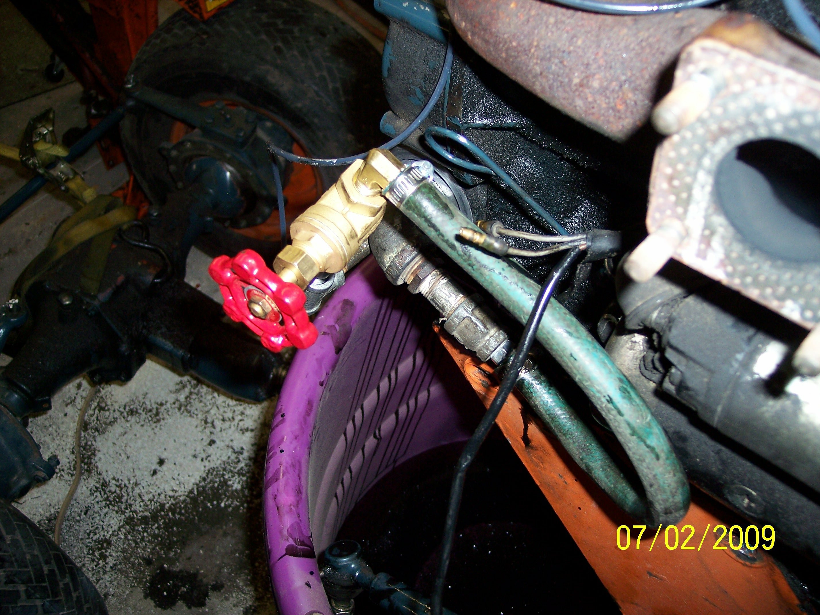

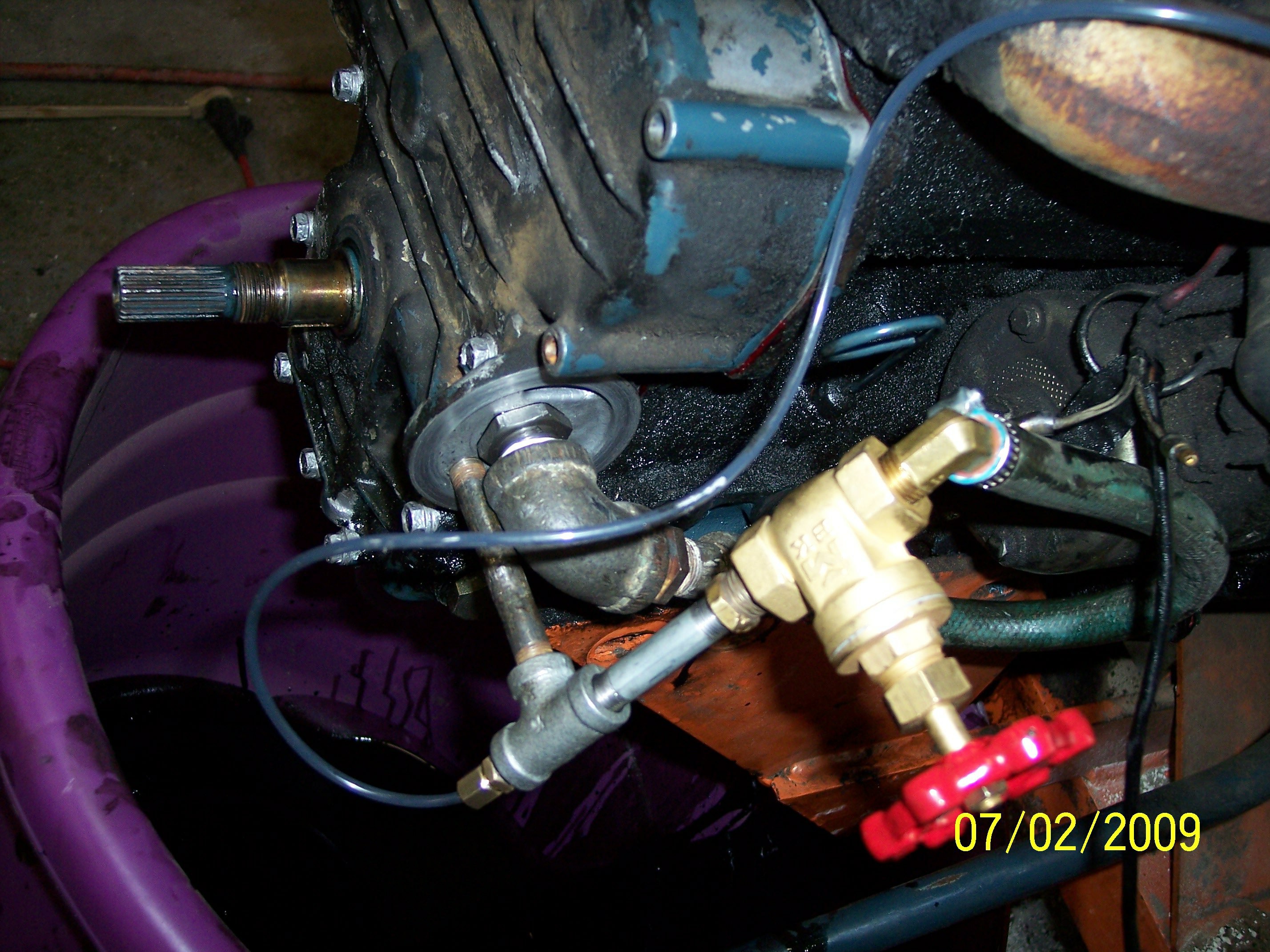

Went over everything today and checked output from oil pump and it was good. Ran a hose from the adapter i made to the oil input on the motor and had 60 psi......hooked things back up.......let it idle for 15 min and the oil psi dropped to 35psi at 1500 was at 60psi.......all that work and it was the oil filter!!

I used a old fuel oil pump and ran it into where the oil filter goes on and with the oil pan off I primed it up with some oil and looked up into the motor to see where the major oil leak was. I didn't see anything that was a big stream so I decided to check the oil pump so here is what i did. Pix 1 and 2 are the by pass that i made up to check the oil pump and see if it was building psi. So I set this up pulled the compression release and turned the motor over, my guage showed 60psi with the valve closed. I opened the valve and let the oil go to the motor and pulled the compression release and turned the motor over and still showed 60 psi. So i moved the oil psi guage to where the oil psi sender hooks up and turned the motor over again and still had my 60 psi. The only thing that was different was the oil filter so i changed it, now i have my oil psi back. I cut the filter apart and didn't see anything wrong with it, The only thing i can think of is it must of had mold or something in it to stop it from passing any oil. I couldn't check the by pass in the filter i wasn't very gentle when i took it apart.

Now I get it. Great technique. Very good thinking on your part. All's well that ends well. I've heard of oil filters being defective right off the shelf but I have never seen it myself. I guess anything can happen with any mass produced product. I'm glad you're back in action.
