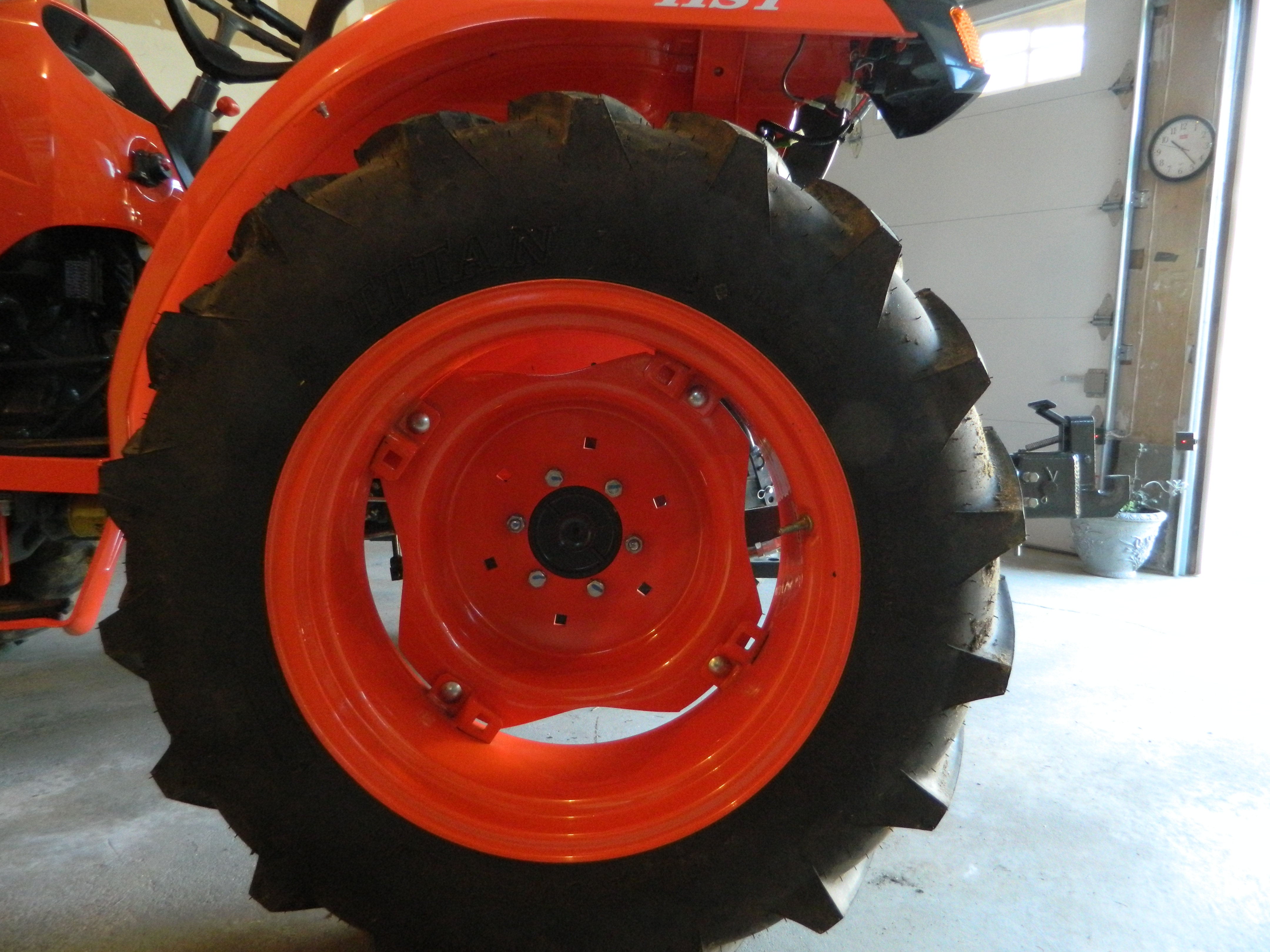

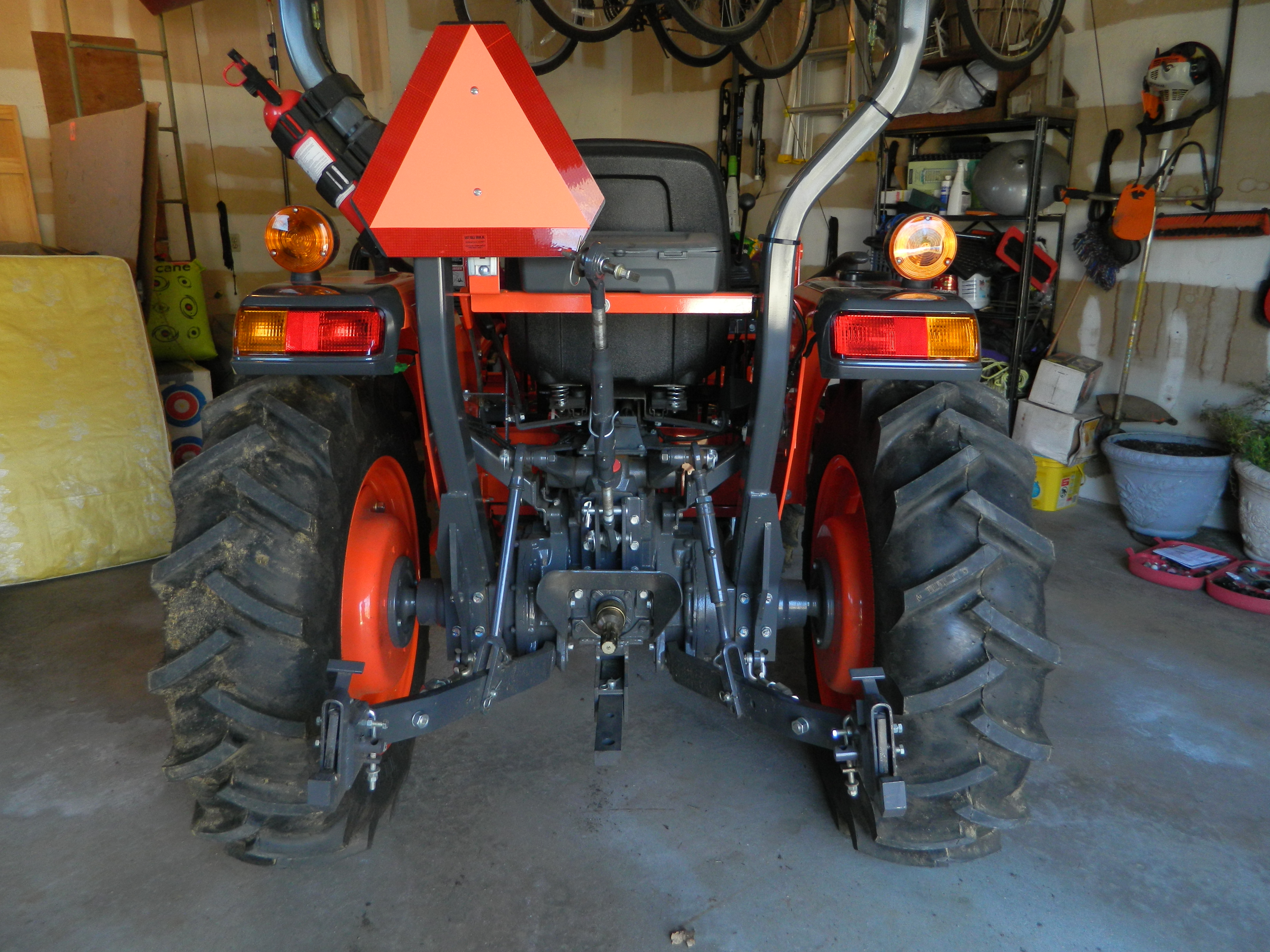

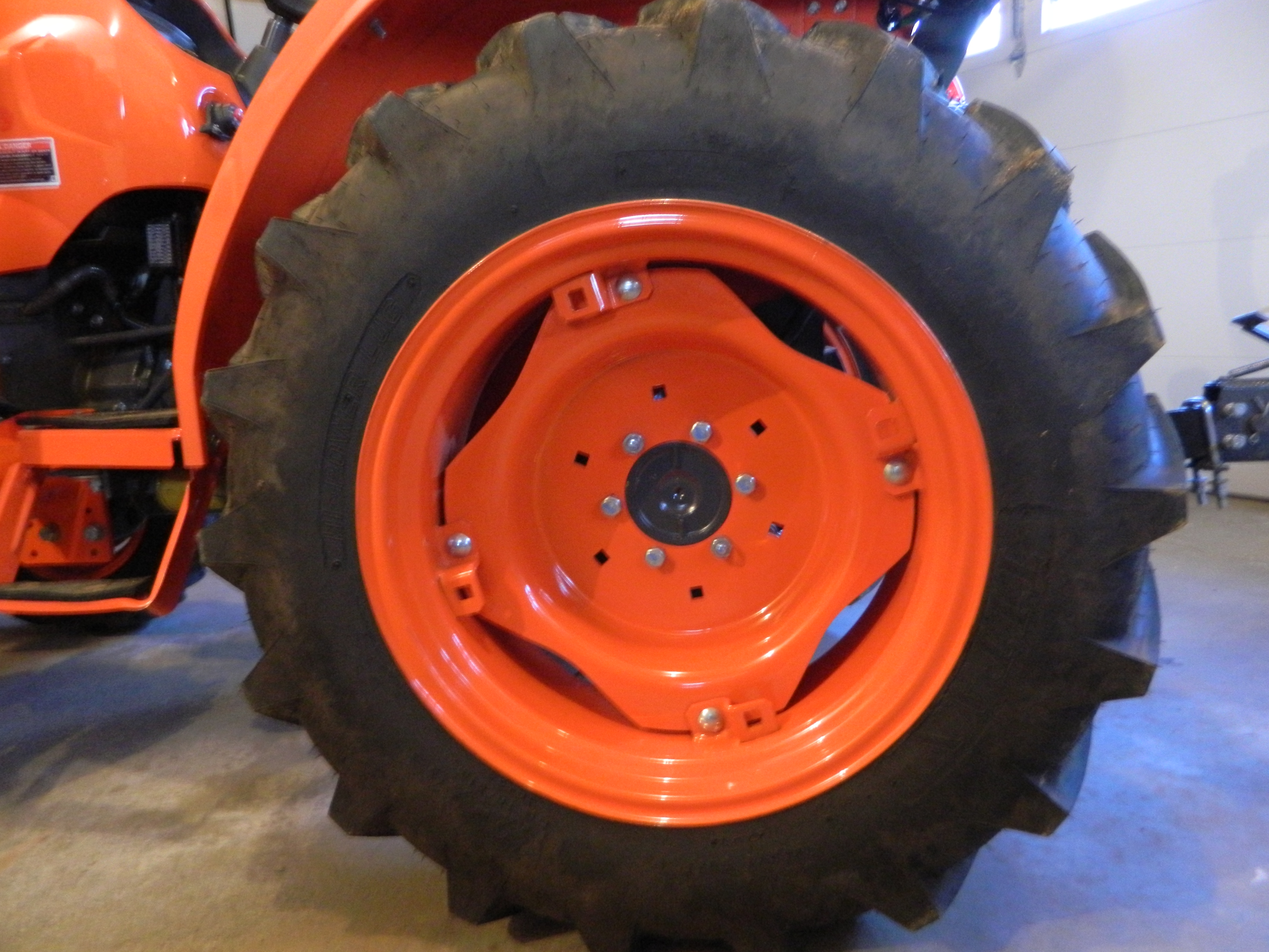

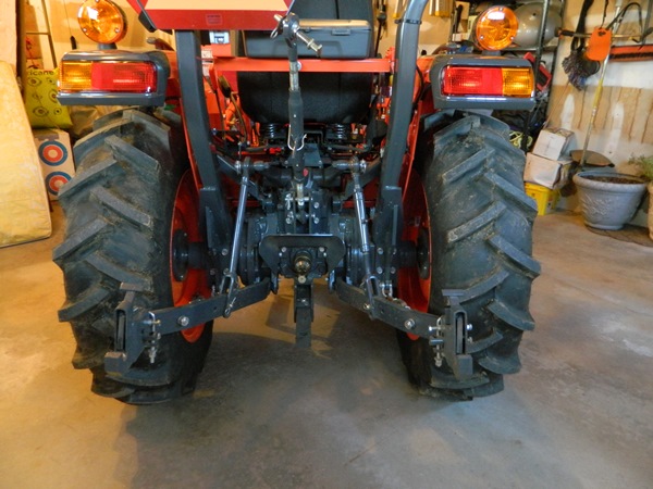

I also have the L3901 HST with loaded AG tires and initially found it substantially more tippy than my old L2205 gear drive. Widening the tires out have made quite a difference.

Deerslayer can you send pictures that show how you have your tires set to be at the widest.
Thanks
   / Kubota Noise and Tippiness #40
Thanks
Sure; here you go:Before and after side view and rear view
Let me know if you have any questions.
