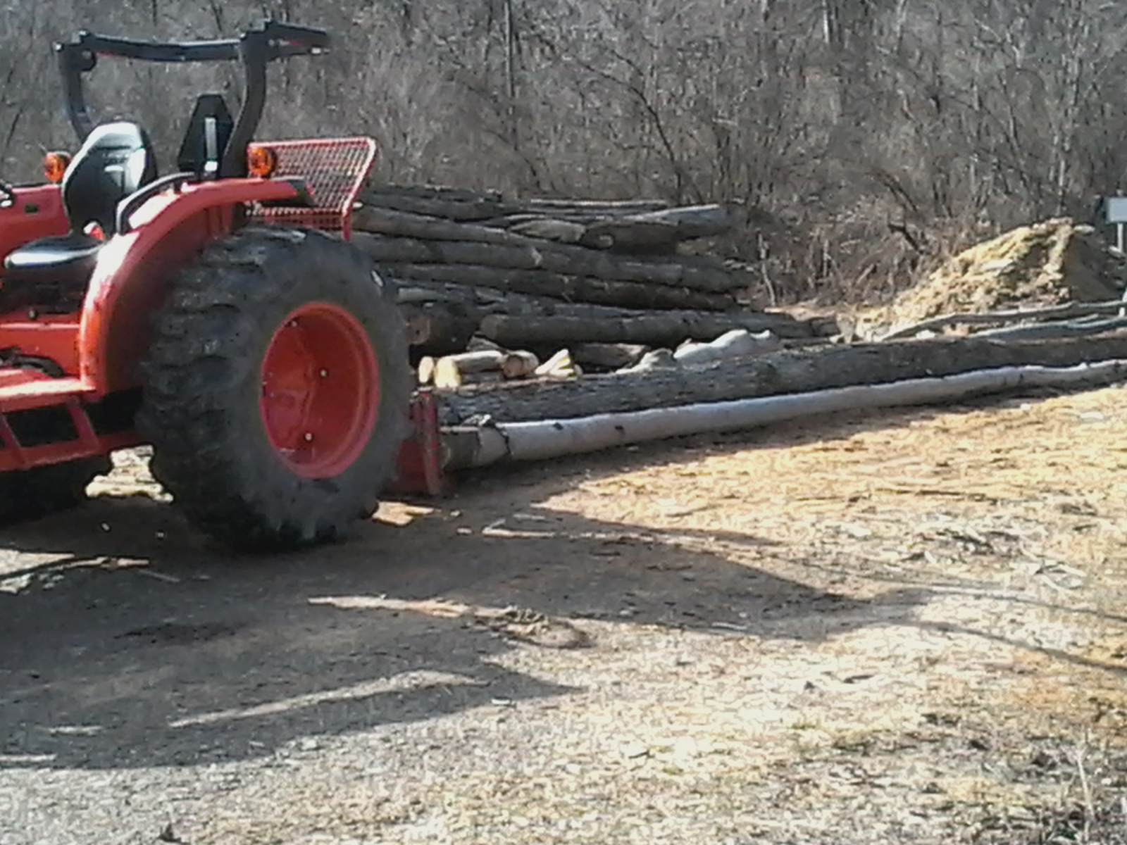

First off welcome to tbn! I just got a mx 5200 for that same purpose. I have a fransfard winch (7600 lbs pulling force) and so far works great. I have only 5 hours on tractor so far and I am really liking it. I have a few pictures here I posted, look for thread "First firewood hitch with mx 5200" in the kubota owning operating forum. I will update you on what I learn as I use the tractor more. I have been doing 400 + face cord commercially for the past 6 years and I expect the larger size of the mx series to really help.
/ Kubota mx5200 #3
Here are some pictures of what I skidded out. 1 large maple, about 50 ft long, 2 smaller beech, between 40 and 50 ft long. I guess about 1.5 face cord and total weight skidded out around 3000lbs to 3500lbs. Tractor pulled them pretty well. I did get hung up going up a small hill in the trail that had a sharp downhill just afterwards. In other words it high centered over a large hump in the road and the tractor spun out. I simply dropped the large maple log and drove ahead past the hump, and then winched the maple log back to the tractor. Everything else went great.

The mx series seems to be the best size/weight to still be able to "maneuver" in the woods, but still have enough power and pulling force to actually pull good size hitches. I actually value maneuverability quite high on my list for what I need the tractor to do. For me any bigger then the mx, the harder to do a lot, such as get turned around in the woods, maneuver on the landings, and transport to site locations.
I am loving the width and stability the mx5200 is giving me over my old b7800. Really makes doing large pulls with the winch much more stable. Add to that the beefiness of the 3 point hitch, I bet I have added about 1000lbs extra pulling force before the winch dozer blade " breaks loose" or the whole unit would slide instead of the log.
I am concerned about the regen emmision system on the mx5200 possible starting a fire in dry leaves, but I dont know for sure yet if I should even worry yet, I havent even gone through a regeneration yet. I am going to put a fire extinguishr on the tractor just because of th regen system, but I should have that anyway. Hate to have a fire on someone elses wood plot and burn it all up.
Another firewood dealer I am good friends with runs a mx5100 (same as 5200, but no emmision regen system on it) You should see what he pulls out! He has a larger winch then me.
Definitly gt the rear tires loaded as I have noticed that the loader sticks a ways out from the tractor and with full bucket or log on forks, and if you travel through bumps, I can feel the tractor teeter a bit or rear end feel light. Just little bit. I actually like the loader out further from tractor as I can load my dump truck easier.
