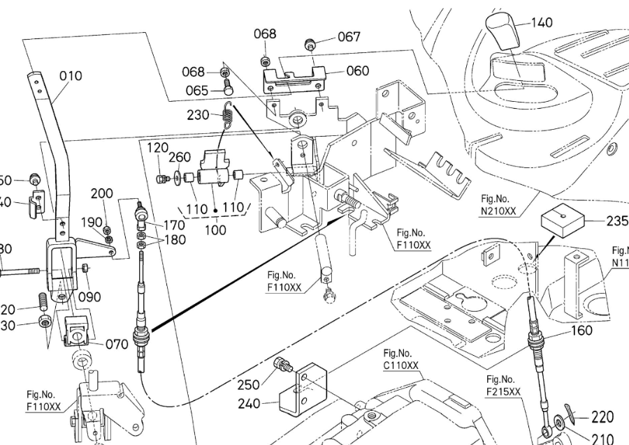

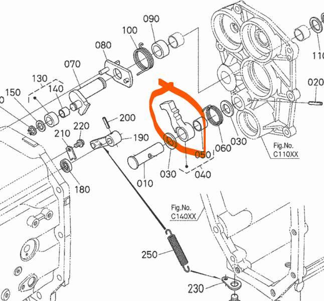

/ Kubota M9540 brakes #7
M9540 parts schematic I viewed listed a hand operated lever for a parking gear that appears independent of axle mounted brakes.

wrong. the M9540 has hyd brakes & a transmission lock that needs to be disengaged before shifting into gear. the older M9000 has the brake pedal operated conventional ratchet ebrake as well as 7040 & lower. 85&95 are different systems that require the transmission lock fully released before shifting into gear..
btw have owned both 7040 & 8540 so am aware of the different parking brake systems, best regards
