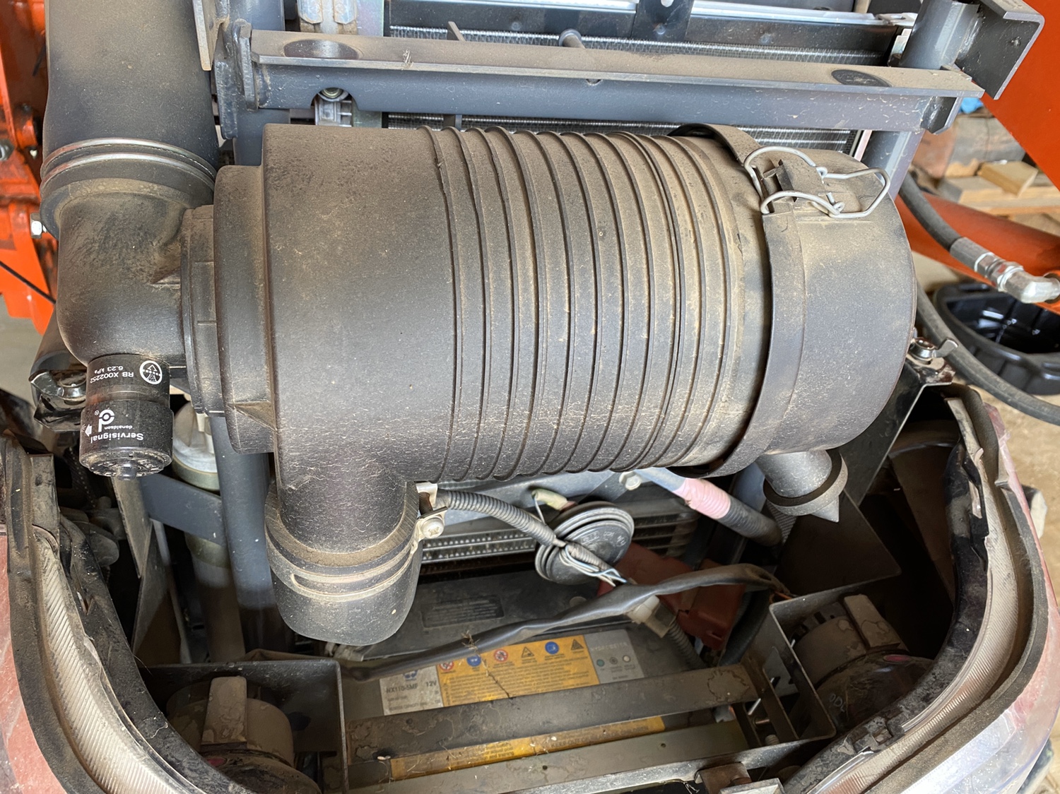

Here’s L3940 air filter housing, air intake is on bottom left.
   / Kubota M62 Cranks But Won't Start #23
My L4060 is more or less the same but mounted in a different spot. The rubber lips thing in the right is a drain you tap to let out dust & other debris that settles to the bottom of the housing.
I'd replace it on mine, but wouldn't wory about a a sheet metal & epoxy fix either. As long as it shields the filter from the worst of the dust & all of the potential water while letting in enough air it will work.
I'm sure the OEM design acts as a bit of a centrifuge to spin dust out of the air & prolong filter life. But basic filter designs with no fancy flow paths have worked for decades.
   / Kubota M62 Cranks But Won't Start #24
Yes, the air intake tube just bends back and is an open tube.

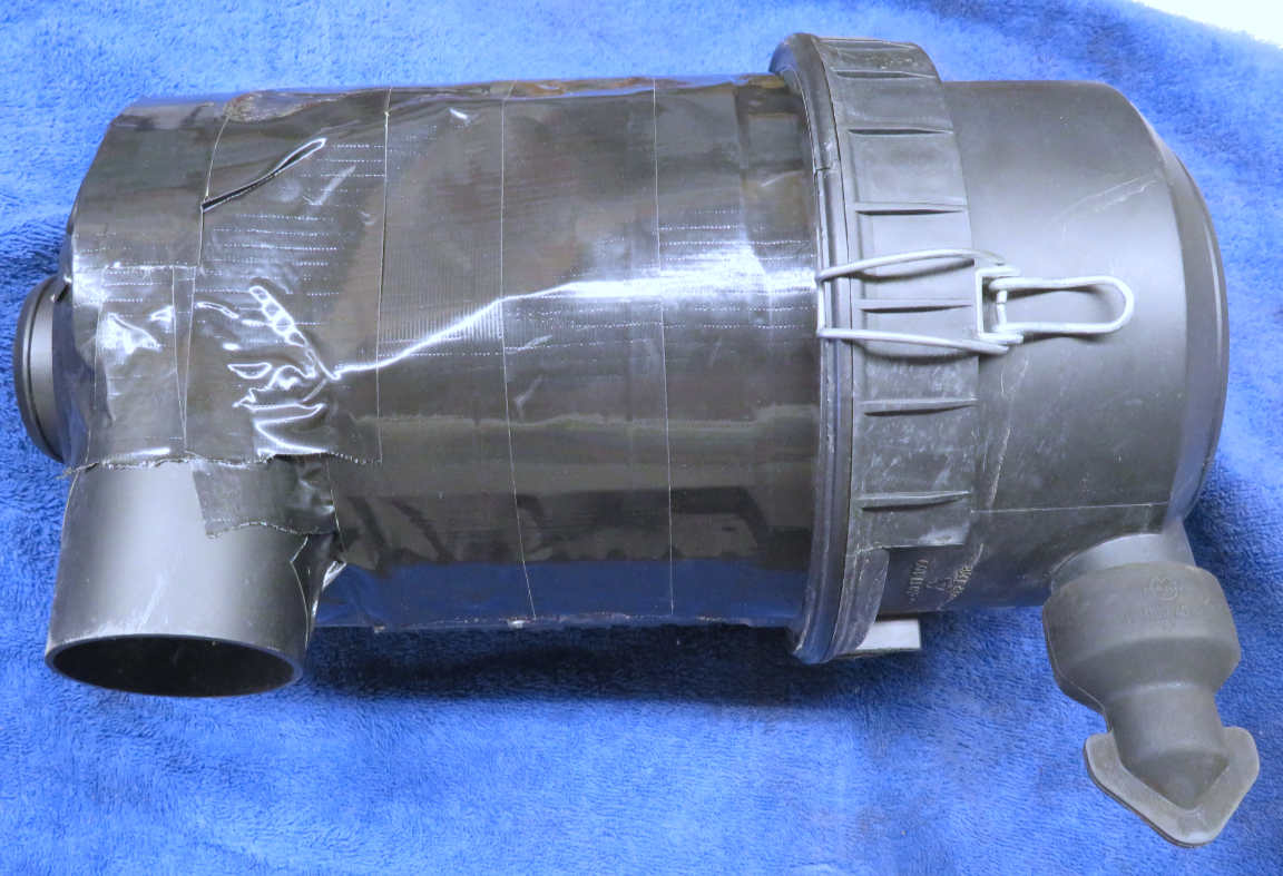

Odd damage. New bonnet? Hope it isn’t starter fluid damage. Something external or internal caused that damage. Easy to see on a routine inspection. Agree a patch would work although I would pony up and get it replaced on such a new machine.

The tractor came to me used, delivered yesterday, with a hole in the front plastic grill, and the damage shown on the air filter housing. No idea how it got there, and of course the seller claims complete ignorance.
The engine and chassis were covered in some sort of brown dust, and it wasn't dirt. When I worked on it yesterday, my arms soon started itching as if I'd been working with fiberglass. So today I got out the hot water pressure washer and gave everything a good bath. About half way through, a ring of plastic about 2" across got blown out from under the radiator. It was the intake snorkel. The contour matched that of the hole in the right end of the housing. So I snipped off that corner of the sheet metal patch and duct taped it into place. Put the cap on and reinstalled the air cleaner, and all is good. So I owe you guys that suggested I'd closed up the intake snorkel an apology.:eek: I taped right over the snorkel hole because I didn't even know the thing had an intake snorkel; it was nowhere to be found.:confused2:

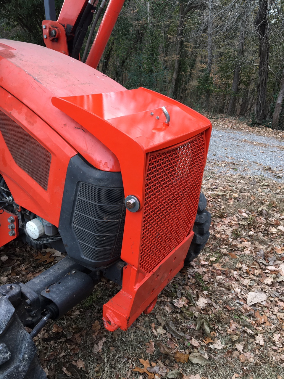

I waited too late before buggering up the grill on mine. Had been gathering materials before I got a unseen stick in the grill.
Now loaded for bear.

"Loaded for bear" is a heck of an understatement, SD! Looks like you could push over a mountain with that grill!:eek: It would be just my luck that the stick would go through the plastic on the side, though. That's what happened on my old Kubota.:duh:

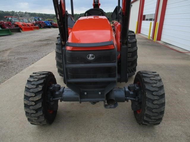

That exterior damage was hard to notice.
Different subject. Is that the exhaust pipe thru the front grill above the axle?
