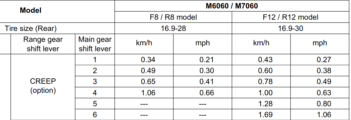

For me the creeper gear is a must have, but it doesn't appear to be offered on the M7060. I would think for many people the M7060 would be a great alternative.
It has the option for a creeper gear. Mine brand new one has it. And it's cheaper than the creeper gear for the M4D by a few hundred dollars.
This is exactly what I ordered.

That's good to hear that a creep range is available. Could you post the speeds in creep range? Can you use the creep for all 12 gears?
   / Kubota M4D-071HDC12-D #19
I was able to find a pdf of the operators manual that gives the speeds. Here's a screenshot for anyone else who might be interested.
