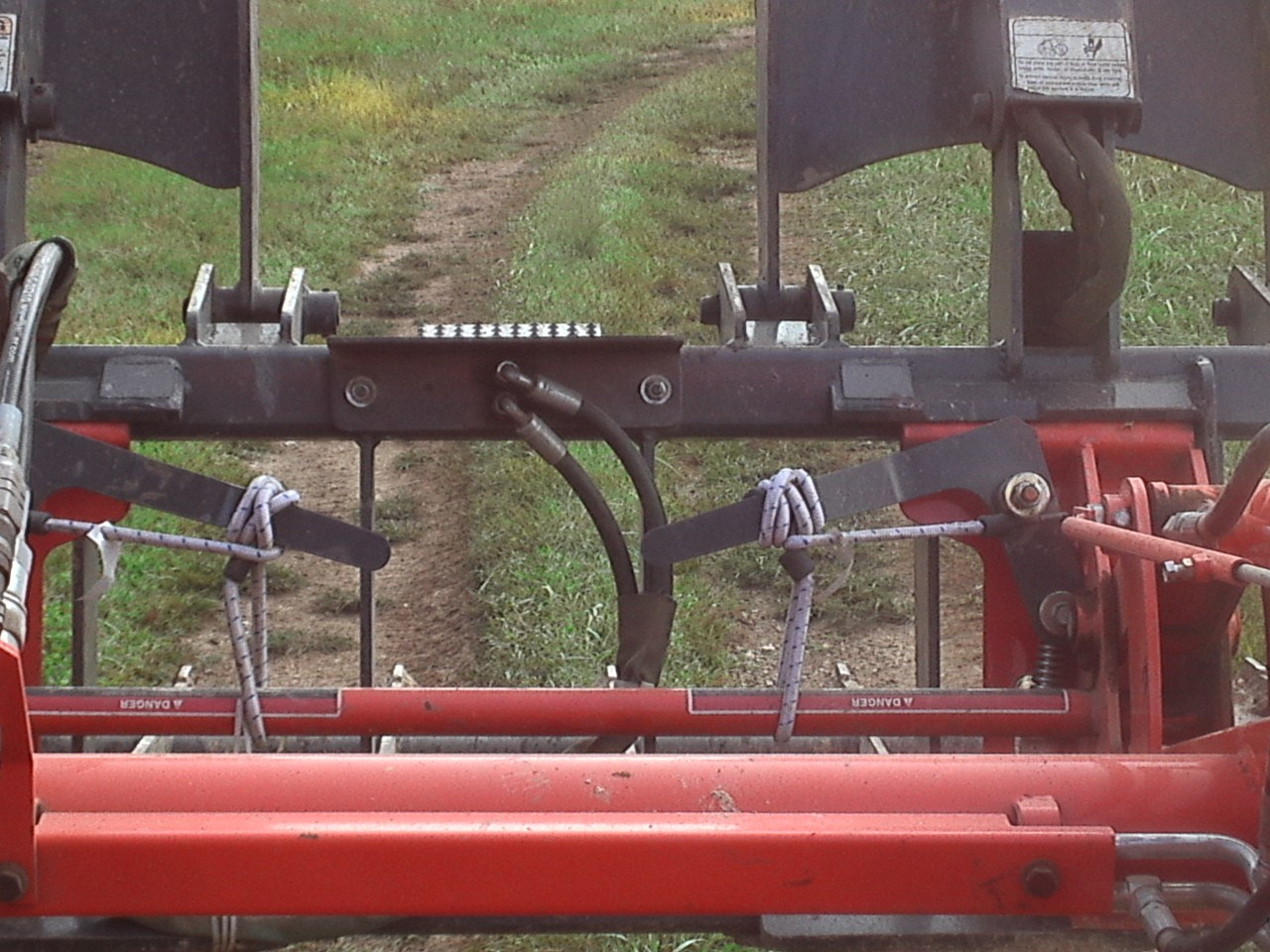

I have never had them come unlatched on anything but a brush grapple. But the one time that happened, it twisted my QA frame when one side came out trying to pick up a heavy log. Now I use two very thick and long bungie cords to lash them down in place. Takes 30 secs more when changing attachments.

As I moved 5" of winter wonder today I had a chance to look at mine. Brainstorming here: 1. Drill a 3/16 hole in each handle and put a piece of 1" flat bar stock between the holes and fasten with a couple of bolts. 2. Drill the same holes and put a spring between the two holes that you can pull over and fasten. 3. Holes again and put a bungie in one handle down around the round bar below, back up to the other hole.
Just some ideas.
