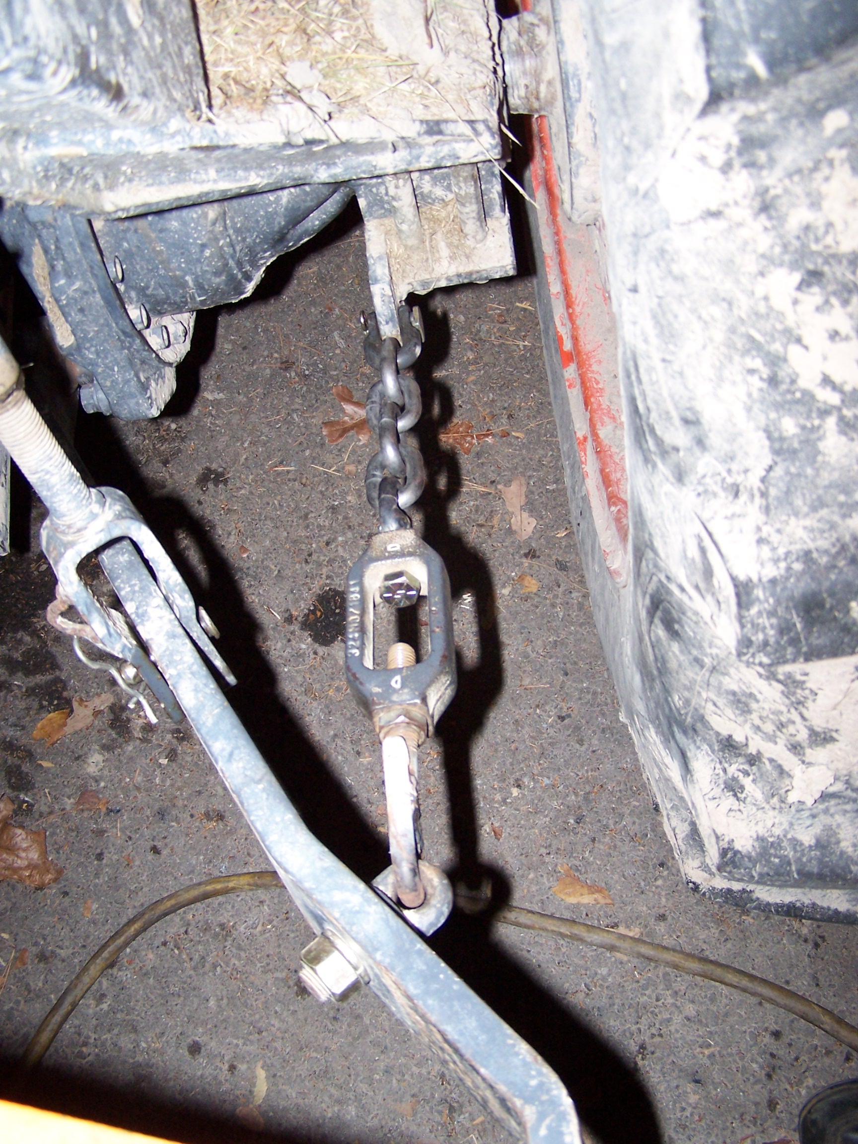

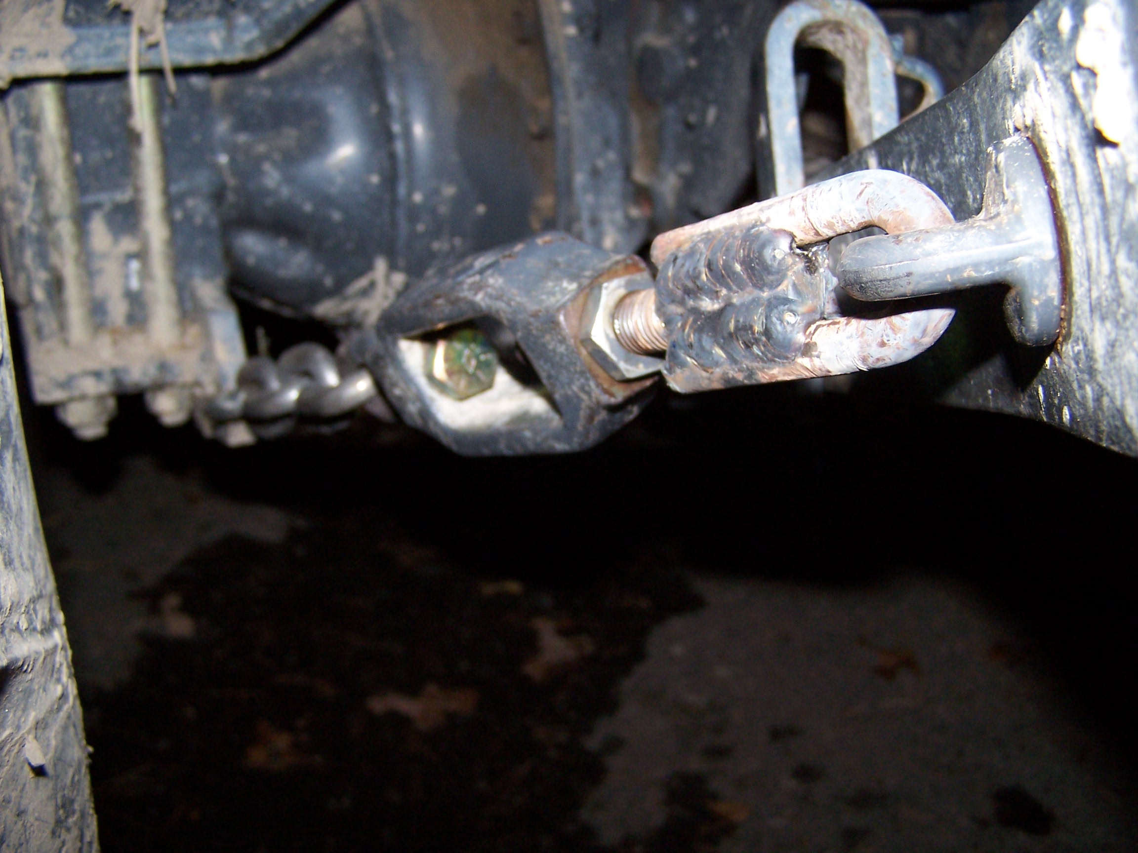

I got tired of bending those cheap Kubota 3PH links. I would fix them and they would get bent again. So I came up with an idea. And this is it!!!!!
Beats the heck out of Kubota's stock and really cheap to do.

Did I miss the adjustment capability or did you get rid of it? :confused:
Troy
/ Kubota lift
Troy
Turnbuckle is still there. shorter solid end and chain on the other. really nothing to bend.
It is still adjustable. It has a 7/16 bolt that is cut so the smooth shank is in what used to the threaded portion of the turnbuckle. It spins on that freely.
The other is threaded and tightens the assembly.
The chain is forgiving when put into a bind where the solid rod was not.
I bent them box blading and going backwards a lot.
This solves the problem by giving free slack in a bind.
Cheap to make and work far better then the Kubota originals.

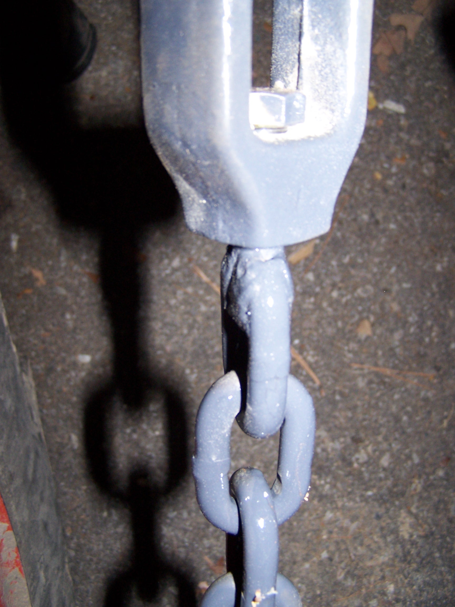

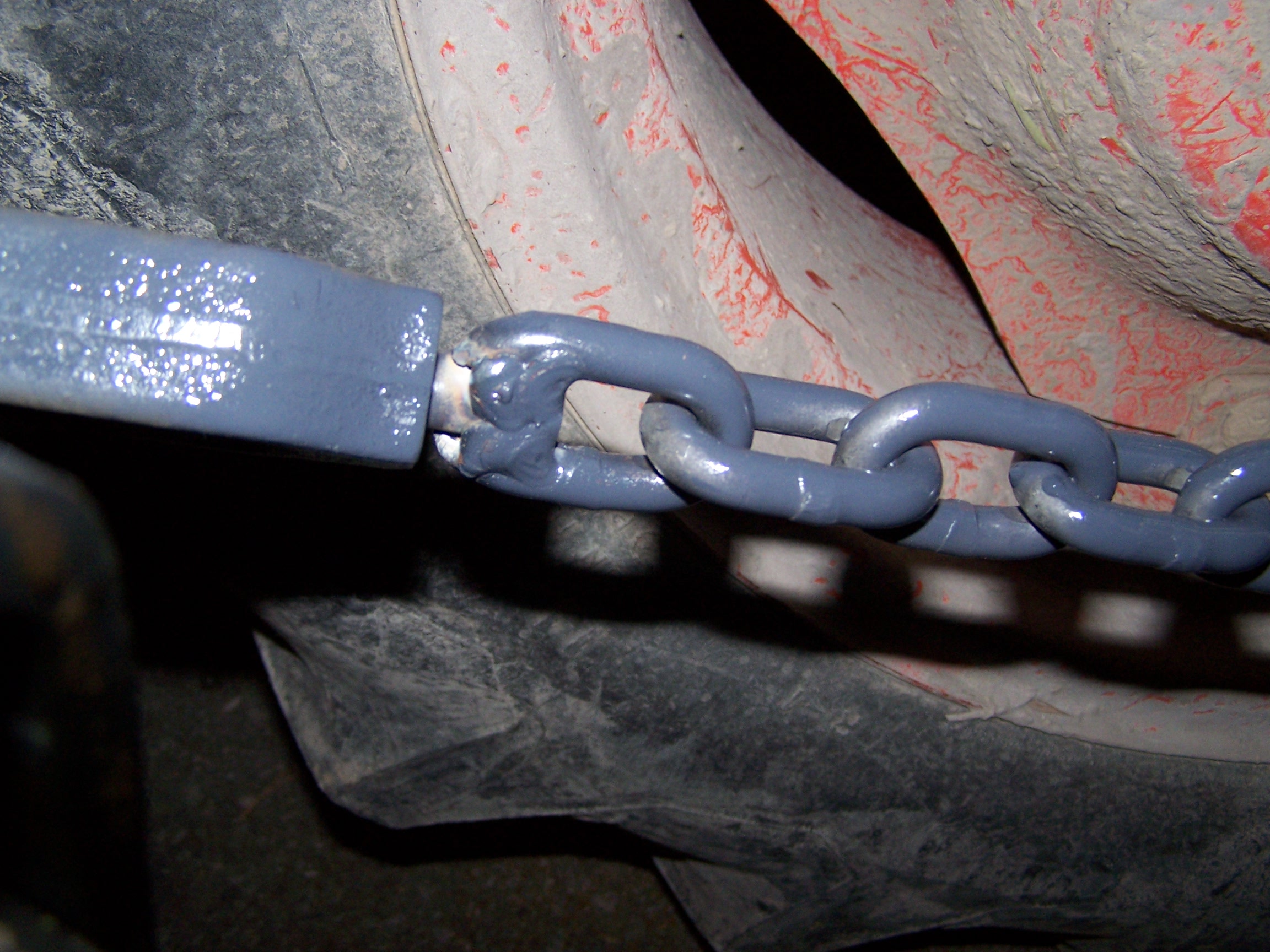

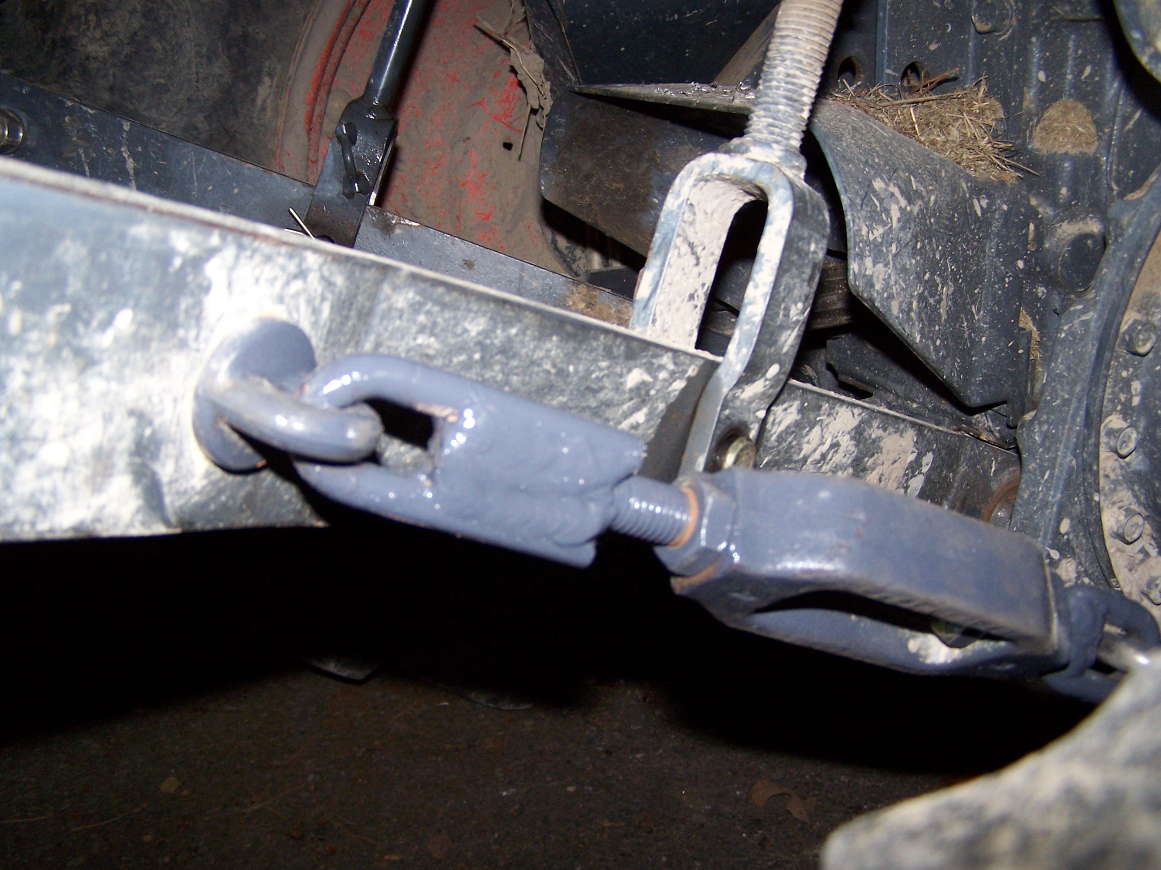

They were simple to make. Remove your stabilizers from the tractor.
Unscrew the old threaded rods. Get you some chain 5/16 or 3/8 and two 7/16 grade 8 bolts about 4" long that have a unthreaded shank portion.
Then ream the end of the turnbuckle that was facing forward on the tractor. Cut the bolts so they will fit into the turnbuckle opening that you just reamed.
Determine how many links of chain you need between the bolt and the shackle attach point on the tractor.
Cut the chain so the bolt will fit into the end that you opened up using a oxy/ace torch or plasma. Weld it together.
Then determine the distance from the lift arm to the shackle that your old rod needs to be and cut it.
Weld it into the long loop attach making sure you have the lift arm attach rod end in the loop.
Paint and attach.
It tightens better then the old ones did and allows slack for implements like box blades and plows.
Total cost was like $20 buck I think.
I looked into the telescopic arms and couldn't see paying say $180 bucks for them and these work better IMO.
My son goes to college at Southern Arkansas University and runs their tractors a lot. they have telescopic and He said this was far better. He works for the Farm for the school to supplement his income and does welding for them. He was going to fix up some of these for them.

That looks like a functional cost-effective solution. You have to tighten the nut to keep the turnbuckle from loosening right?
/ Kubota lift
Yes I just used the original jam nut. I found it easier to hook up and tighten then the original kubota stabilizers.
You can buy one's like this but this was so cheap and easy.
