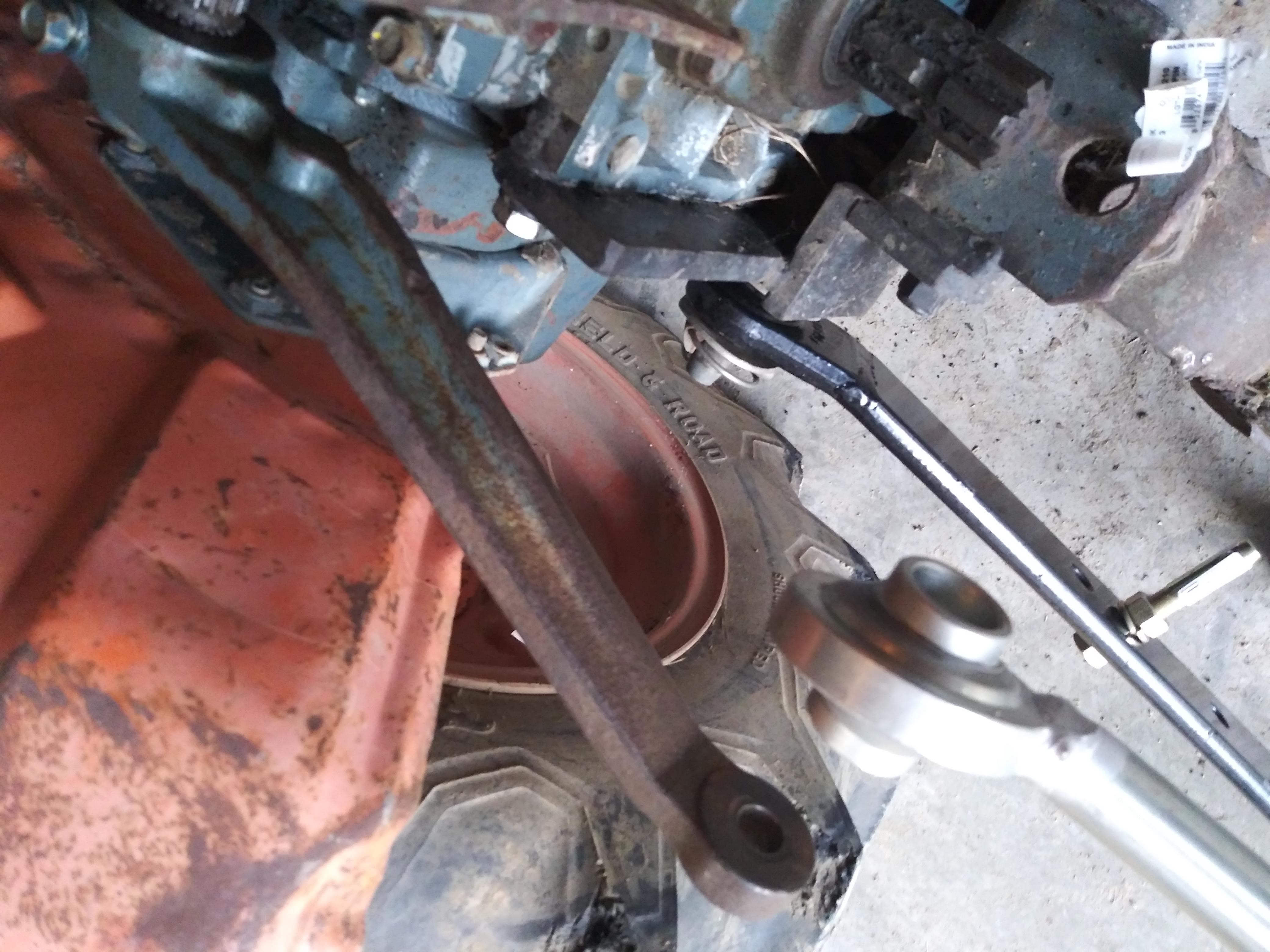

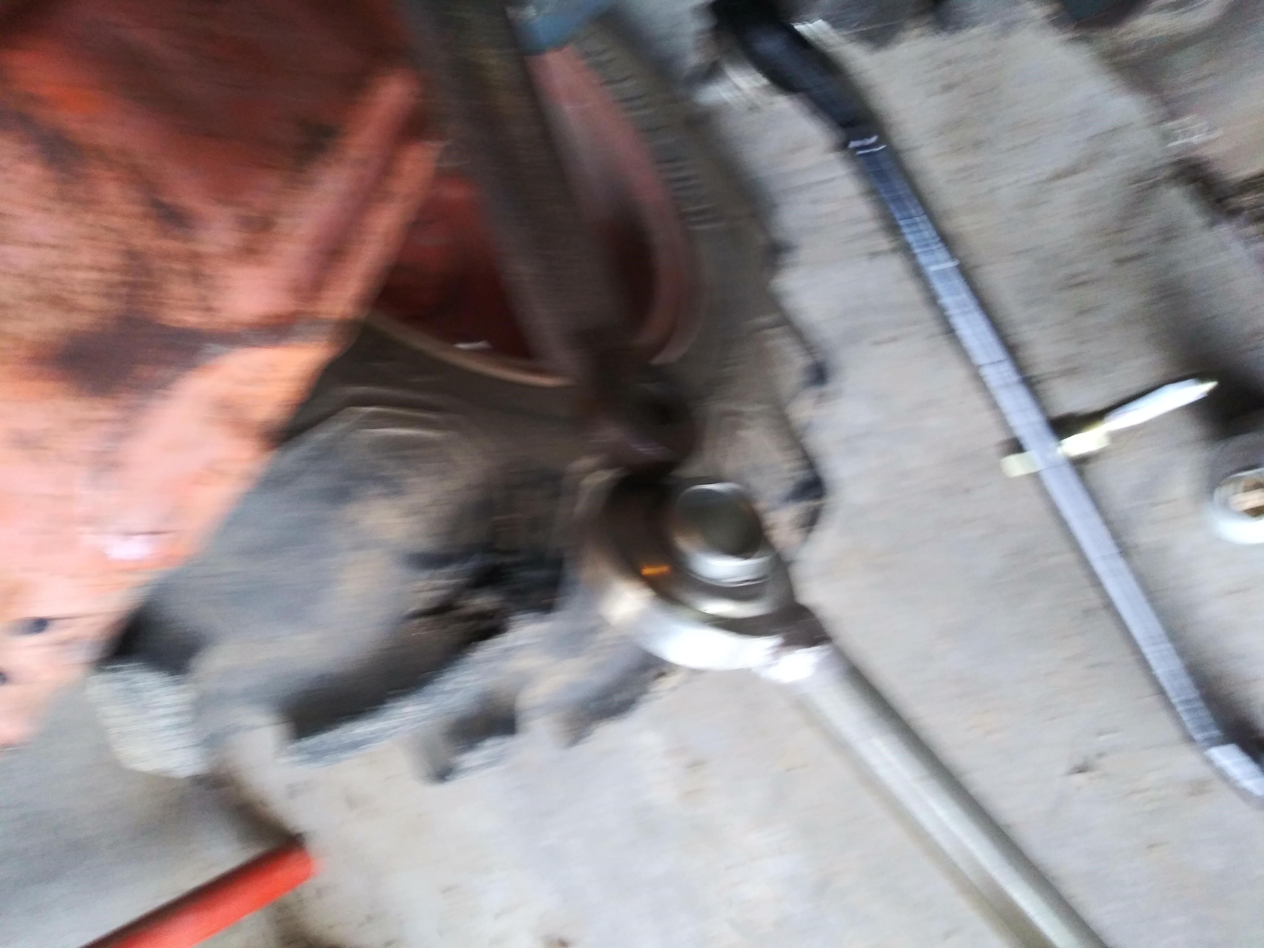

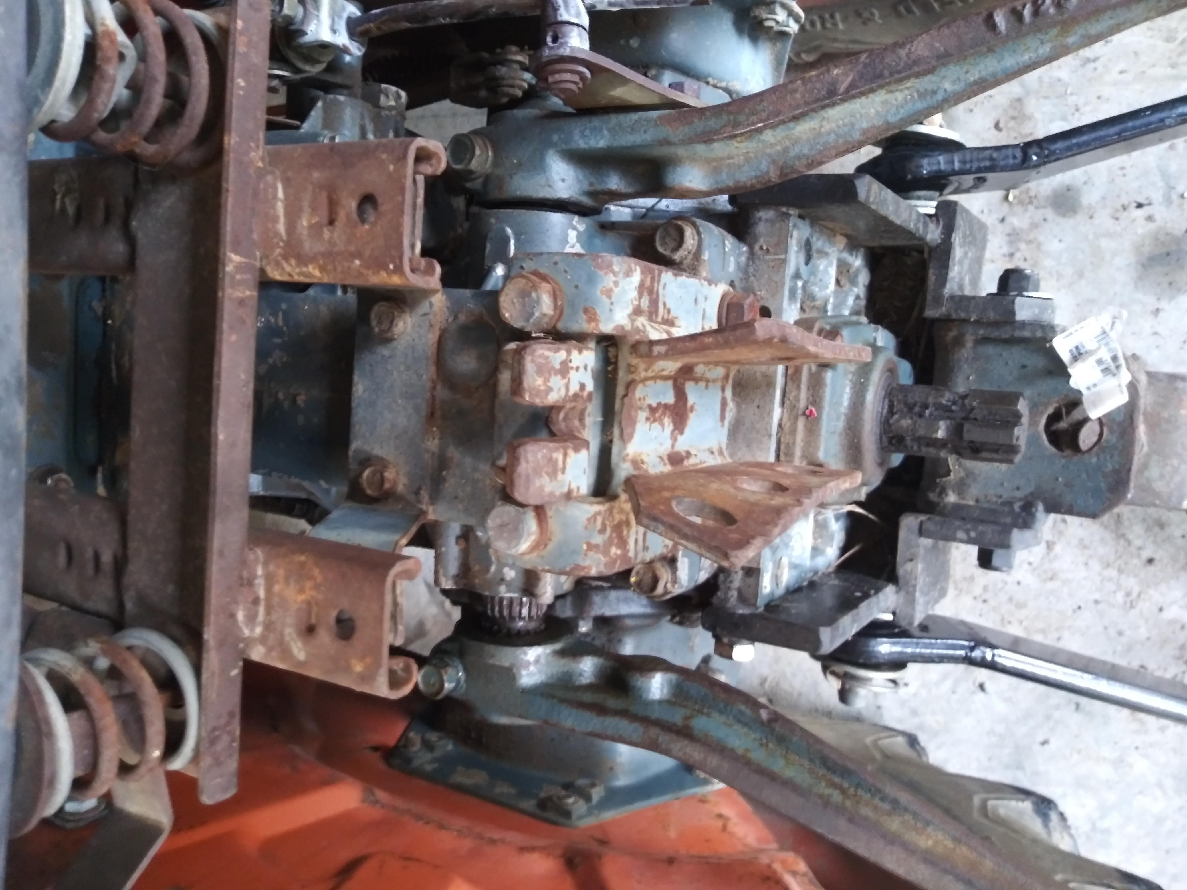

Bought an 82 b7100 hst to help my chores on the 12 acres we bought so the wife could have her two quarter horses close to her. being my first tractor I'm on a learning curve for everything. The 3 point hitch on the rear was pretty much a couple of chains bolted to the lift arms and to the old welded lower arms. I bought a linkage kit for it to get it set up for a brush mower but the upper lift arms have holes in them about half inch diameter all the cat 1 pins I find have 7/8 threads to hook up to the lift arms I'm wondering if the wrong lift arms are on it or are they just blank castings that I need to bore out? I have a small rotary mower coming and I want to be ready for it when it gets here. Any advise or knowledge of my ignorance would be appreciated.

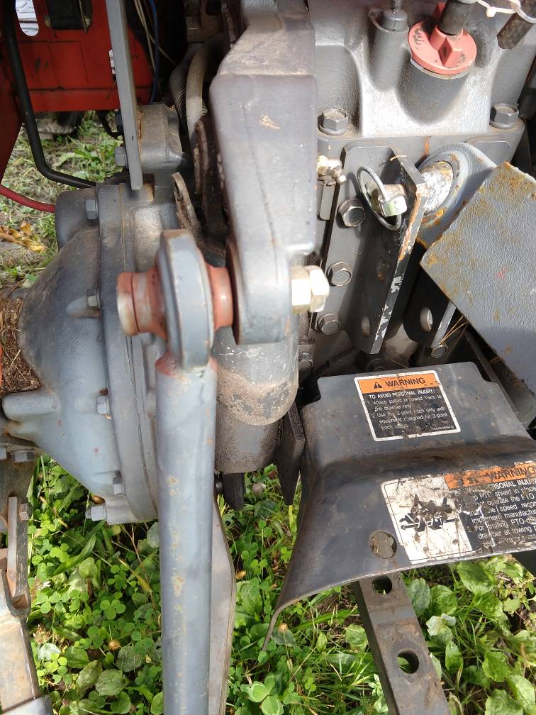

thank you for your response roadworthy yes the mower or my 3 pt blade has the pins for my lower lift arms but my vertical links also have a swivel bearing at the top and a forked yoke to pin to the lower arms the cat1 pin I need is for the upper short lift arms on the top at either side of my top link these arms are my problem because a cat 1 pins threads will not fit through the small holes in them

I think the OP is asking about the connection between the upper lift arms and the side links. I have seen 2 different types of connections. A bolt/pin that connects the side link to the upper lift arm and a U-bracket that goes on each side of the upper lift arm.

I'm having trouble figuring out what you have. If you have a Kubota dealer nearby, the parts tech can pull up a diagram of your machine that shows how the parts connect and get you part numbers for the stuff you need to get operational.

The pin I have on the lower arm is a cat 0 which has a 5/8 thread on it and no not even it would fit in the hole on the top arm I bought a cat0 to cat1 bushing and hooked the side link on upside down. pinned the yoke to the top with a half inch pin but it binds up when trying to spread the lower arms out to fit over the pins on my implement

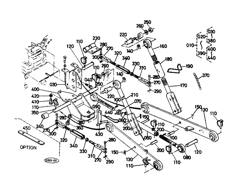

Kubotas are metric for those parts sourced in Japan, inch for most parts sourced in USA.

Do you need a picture of what the kubota arms should look like?

thank you for the part number aczlan hard pin to find found one in Australia found one on messicks online store bought it. If I cant find another one closer I will just have to make one myself you guys have really been helpful I owe yall a picture when I get it all hooked up.
