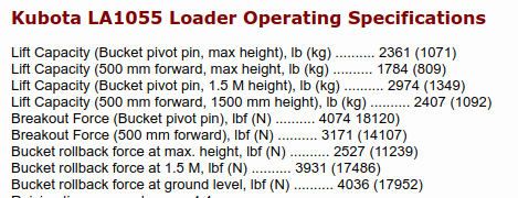

1. Loader capacity: The LA1055 is rated at 1,784 lbs and the old LA854 from the 5740 was rated at 1878 (500mm forward of the pin to full height) Did they change how they rate or measure the capacity? Or is the new loader really weaker?
From what I know of Kubota loaders (ie very little but I do know this), the model number states the capacity in KG at the pins, more or less:
The 1784# you're seeing appears to be the capacity 500mm forward of the pins.
An LA854 would be ~1882# at the pins; I believe you were looking at its "pins" capacity vs the 500mm capacity of the LA1055:

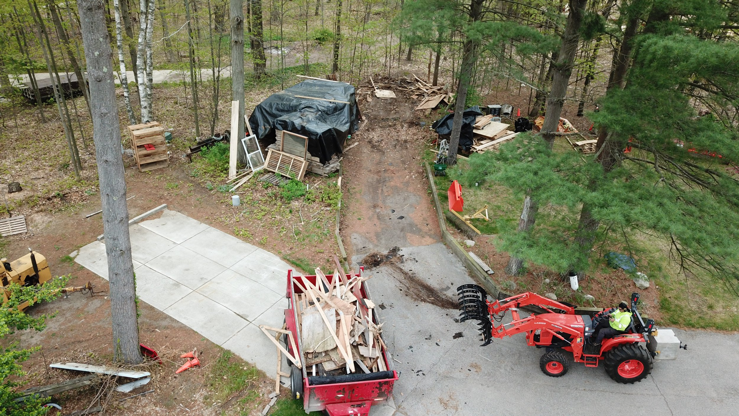

The new machine is great! The loader is definitely stronger than the one on my 5740. So far, I've cleared a lot for a new home, cleaned up my field, done a little light dirt work, regraded a long dolomite path and demolished my old 12'x18' shed. I don't know how I got along so many years without a grapple bucket.
Here are a couple pics of it, before and after. It took less than an hour to have it all loaded up and cleaned up, including sweeping the driveway. I spent more time driving to and from the dump than demolishing it. Now to make use of some of the rough sawn lumber underneath the black tarps to build a new one! Once i get it figured out how to merge two files, I'll upload the video to youtube and post a link.

Loader hydraulics are the weak spot, possibly the front axle. Its entirely stable at max lift when hydraulics go into relief. I couldn't quite lift an alledged 1,700lbs pallet a ways out on pallet forks. Removed 50lbs & could barely lift it. I'd imagine the bigger loader could easily lift pushing 2k or so. Stability might be an issue though.
There are differences on loader ratings. They use to rate things at the bucket lip but now it's usually 500mm infront of the pins. Not sure when the changes were made, but I thought it was before the 40 series.

1. The LA1055 lift capacity is considerably more than the LA723 on my old L3430 but not quite what I'd like. FWIW, the published specs on the LA723 were way overstated. However, I found the published specs on the LA1055 to be fairly accurate. Check the hydraulic pressure and make sure it's at or near 2800#. I know some who boost it 10% or so to get more lift but that can take it's toll on the front axle.
