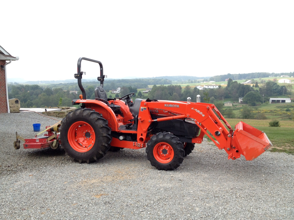

I have the 14.9" rear tires on my 5240, but I think they are a 26" rim. My for has the 13.6x28 tires and the Kubota tires are at least the same height maybe slightly taller when I park them side by side, but I really like the wider tire. I can't remember what my front tires are but 9.5x16 sounds right.
Here is a picture with the 14.9x26 tires for reference.

I would sure check with the dealer, foreman Etexas had bigger tires put on his last M7040, our dealer put the same tires on our M8540 as come on the 9540, we had bigger tires put on our MF375 years ago when we bought it.
