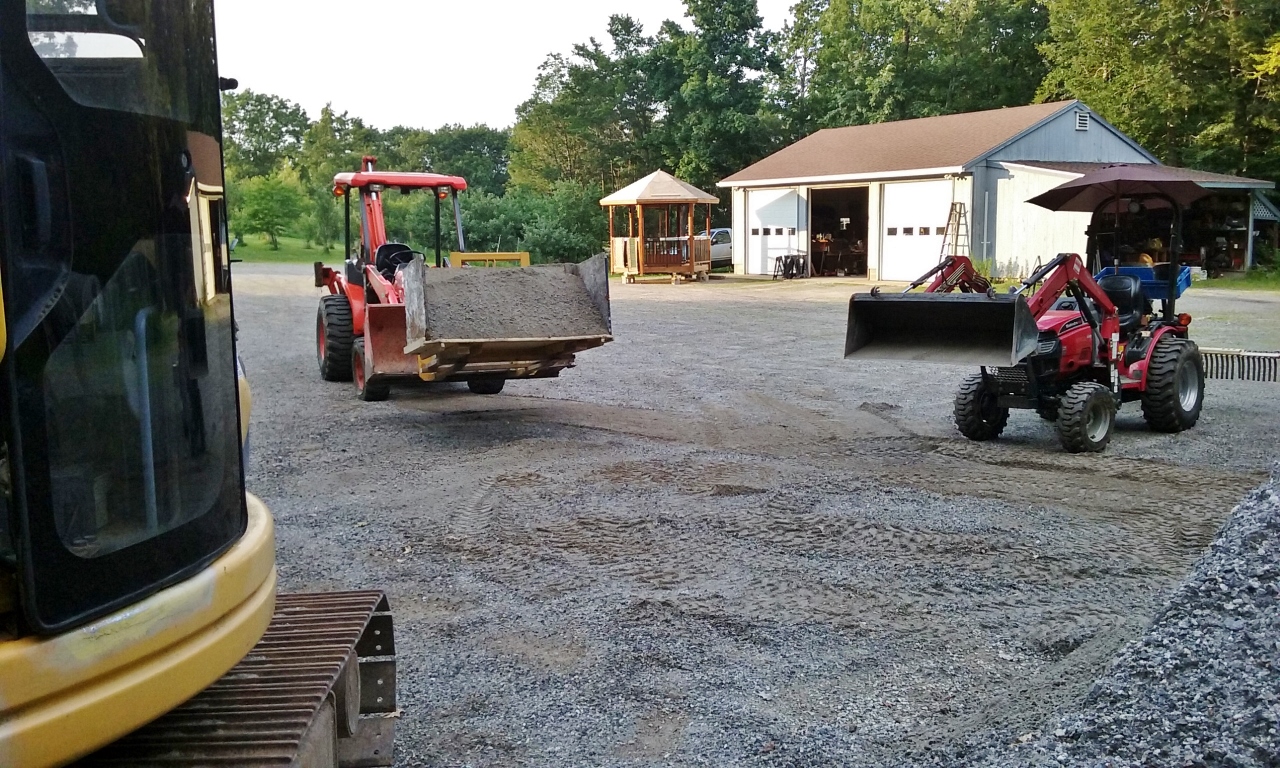

Well, Here is my new ride L48 TLB, I sold the TC30 Sunday, and in less than 24 hours have this beauty sitting in my yard.
I will miss that little blue mule, I owned it 11 years, but I really needed more lifting power, I think this will do the job just fine.
Thanks for all your advice.
MrC.

Beefy Looking Curl cylinders on your tractor, I upsized mine on my L39. I like that deep bucket. I'd like to find an L48 bucket used.

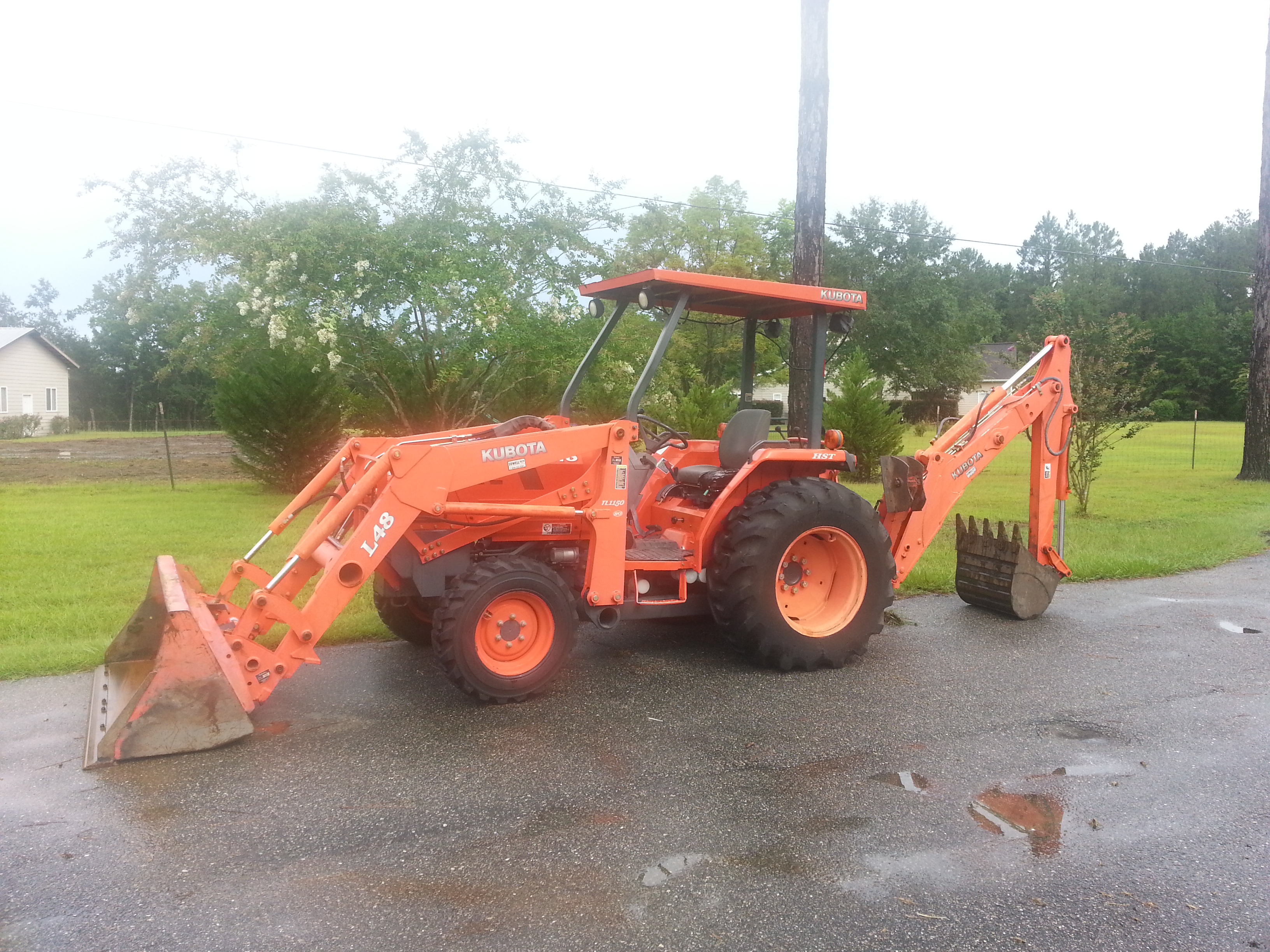

Well I am one of those people who buy something used then go through it for service before I really use it. I do this for a couple of reasons, Since its used, I don't "really know when it was last serviced" and it gives me a chance to really learn about the machine. like how stuff works and what things look like. It also tells me a lot about how it was used before I bought it. I am sure some of you are the same way.
So over the last few weekends, I have serviced engine.
New air Filter inner and outer ( both looked pretty bad)
New oil Filter
New oil (Delo)
flushed radiator, cleaned trans cooler and radiator screen
replaced broken positive battery lug, checked fan belt
check over engine, every thing looks good and seems ready to go.
Drained HST trans, changed all three filters (messicks)
13.5 gallons of premium Hydraulic fluid Napa Brand- This fluid states it is equal to or exceeds Super UDT and regular UDT standards
Pulled hard line found only 1 screen/mesh filter near rear axle looked great cleaned it and replaced.
So far everything is going great only issue is the BH seems weak (boom and dipper) Curl seems strong, also the stabilizers wont lift the rear tires off the ground, they do lift some but not off the ground. Fel seems strong and lifts front end no problem.
Before I go digging into the pressure relief valve (900 hours on machine) I have read that the push pull valve (fluid diverter?) is hard to seat. Is that so?
I did find a small leak, I call it a drip from one of my rear remotes ( the red one ) Are these rebuildable? or can/should I replace it?
Thanks
MrC.
