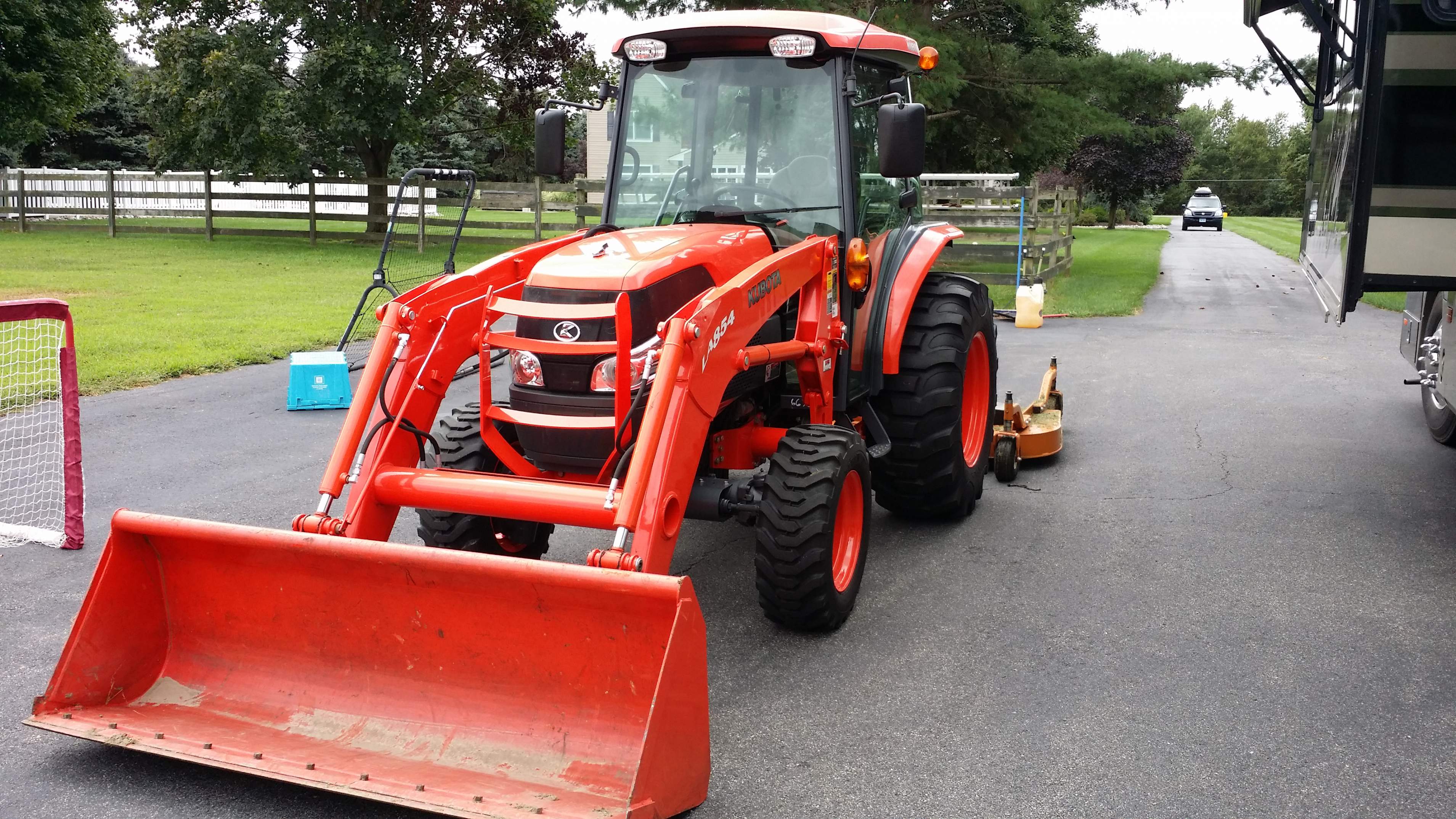

I am wondering if I can put the rear wiper in or is it a waste of time and money also I can buy a ssqa front blower from a skid steer which I believe is hydraulic driven what would I need xtra to run the blower guy is asking 2700 do I need front remotes
I don't believe you will be able to run a hydraulic powered snow blower(not enough flow),they do make Rear Pto powered front blowers,not cheap.
I have a third function that powers my thumb,snow plow angle and tree shear.About $800 from Kubota.
/ kubota l4740 #71
I was told the pump is 53 gallons per minute that's not enough?
whew!.. that would be a real pumper!... Sorry no tractor near this size pumps that amount of flow thru an open center system.. Yeah the 10 gallons a minute not counting the power steering section of the pump sounds about right.. Keep in mind that a 1/2 inch standard AG quick connect is only good for about 12 gal per minute maximum flow rate. . From what I can see you would need about 18 to 27 gallon per minute for a 72 inch blower, which you would need to clear your wheels outside track.. I don't think this is going to work for you without the power pack on the back which is PTO driven to make that kind of flow

Crap ok not enough flow I guess it's plan b
The L4740 can have a "semi independent mid PTO" that could run your front blower. I have not idea what it would cost to install, but that is one option. Or you could still have the hydraulic front blower, but just know that you will also have to purchase the power pack for the rear PTO to make the hydraulic flow you would need to operate it. Of course a rear blower is much less expensive.

Man I need a grapple bucket went to help a friend get rid of a pool the bucket is no match for a grapple do I need anything XT ra after removal of the bucket
/ kubota l4740 #78
From your pics, I don't see a 3rd function hydraulic connection. You will need that to operate a grapple.
Do you have any rear remote hydraulics?
/ kubota l4740 #79
As C4Ranch said, you don't have a third function valve,, it would be on the right side under the floor board and on Kubota OEM anyway, you have to remove the step. An alternate method would be to run lines from rear remotes if you have any, we did that on our M8540. Another is to install a diverter valve, there are several threads on this. It's not as cheap as off rear remotes, but cheaper than the third function.
