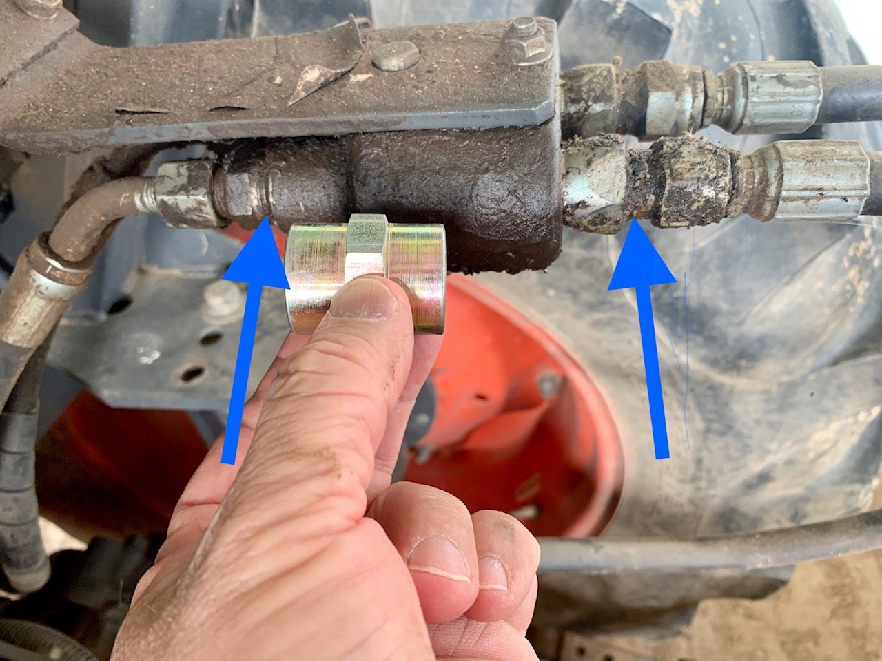

Went out and took a pic of the fitting I plan to install to bypass the quick coupling. The arrows point to where the fitting will be attached. I'm still not sure this will work, but if it does, it will be a cheap modification. Although, it will be a little more difficult to connect than my current set up.

I don't understand how that fitting is going to work for you. Show a picture when you get it in. I jumped the gun a little I do understand now. Why not just put a tee there if you are just using one or the other?
A 'tee' might work too. I had not thought of that. I'll look into it. It may be a while before I try this, because I can still use my other tractor, and just wanted to have this tractor as a backup option if needed.

You do know that is not a direct return to tank. To make return to tank you would have to move lever one way or the other and that would put pressure on the other.
   / Kubota L4740 return to sump #29
I don't understand what you are trying to tell me. I do move the lever to one side and lock it in place with a rubber strap. This provides constant pressure to my blade.
Is the 'tee' not a direct return? Or is the fitting I showed not a direct return to the tank?
   / Kubota L4740 return to sump #30
Yes it would be then as you are tie off your lever.
