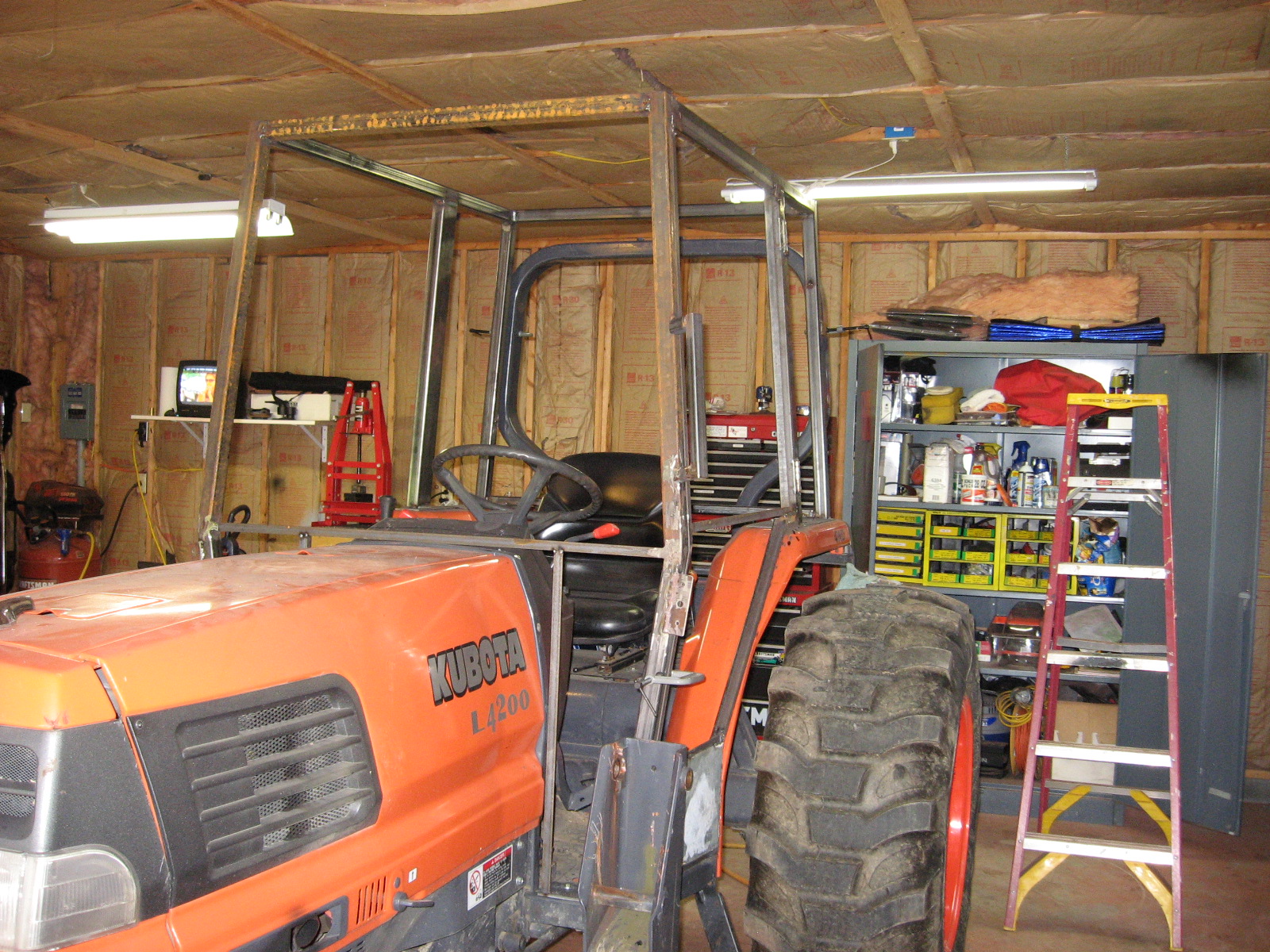

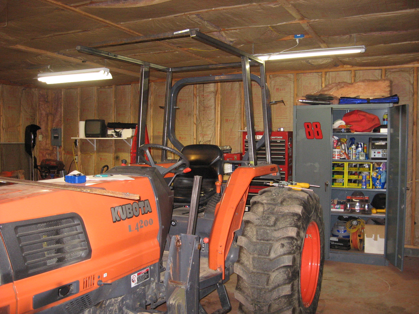

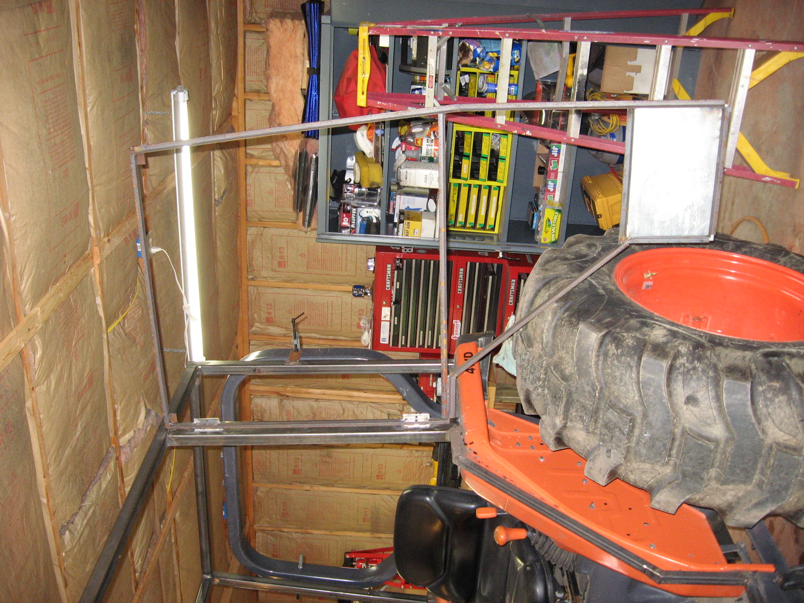

Hello Everyone,
I hope no one minds me opening a new thread on this project but after my initial mock up I discovered some flaws in my design so I tore it down and started over, I now have a good looking cab that is progressing nicely.
I also am set on using glass for the cab, I looked into the Lexan MR but I dont think I will be happy with the results, I had a rep from a local glass company come up today and he took some initial measurements and will work up a quote for me, I will let you all know the costs.
As of today I have a little over $400.00 in materials and around 24 man hours invested.
Below are some pics of the build as of today

Looking good, please keep the pictures coming. I think you'll be happier with glass in the long run.

Looks like a nice start but does Kubota have a canopy top that you can buy without the rops framework? I know that Deere sells the top separately from the rops and is about 400 to 700 bucks. It would seem that this would be the easiest way to go but would require the proper dimensions be planned for from the start.

I looked into the factory top as you mentioned, but it was near a grand, so I quickly scratched that idea, I have planned a custom fiberglass top that I can put my heater core in and all of my switches, and most importantly my radio :D

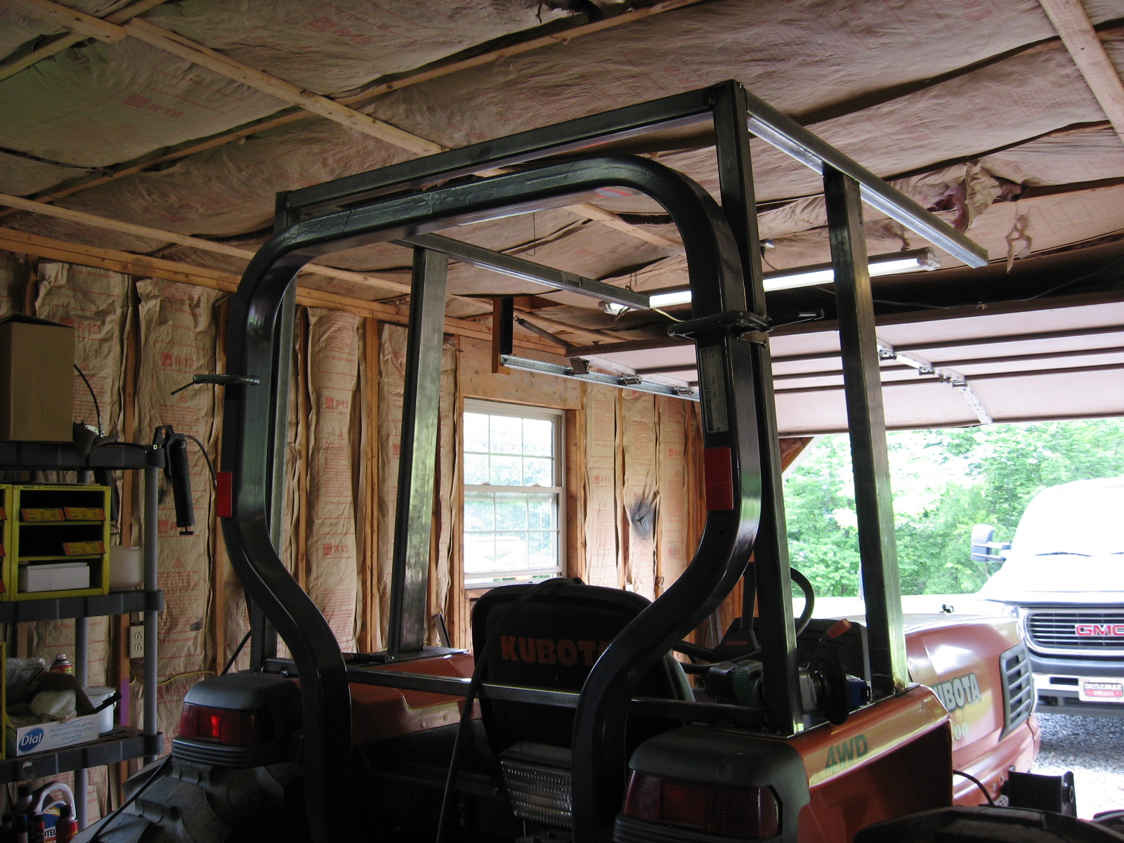

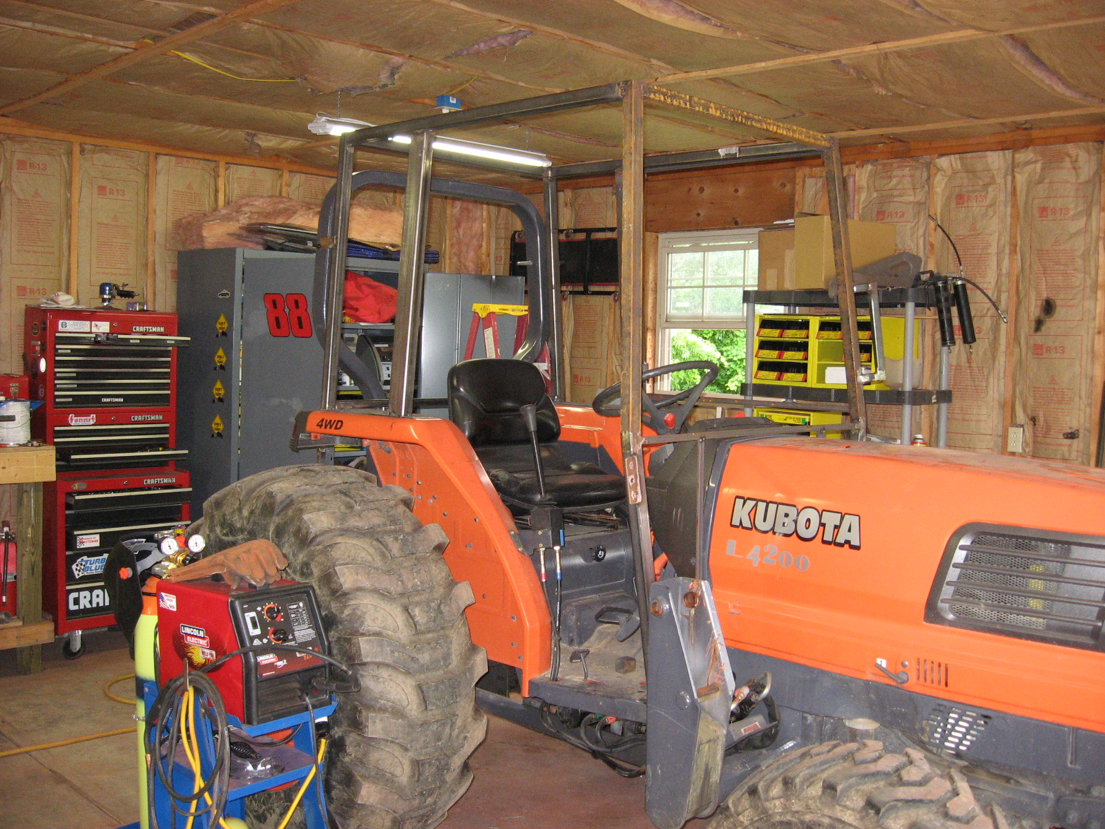

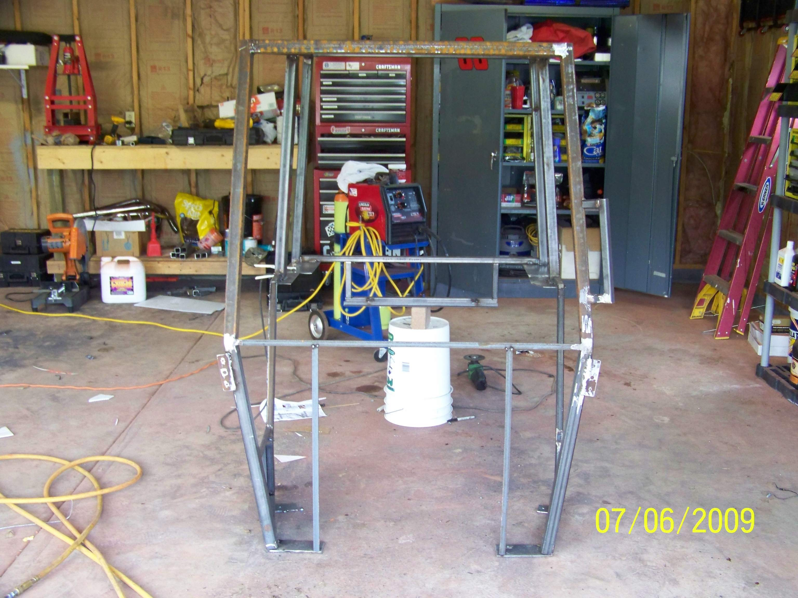

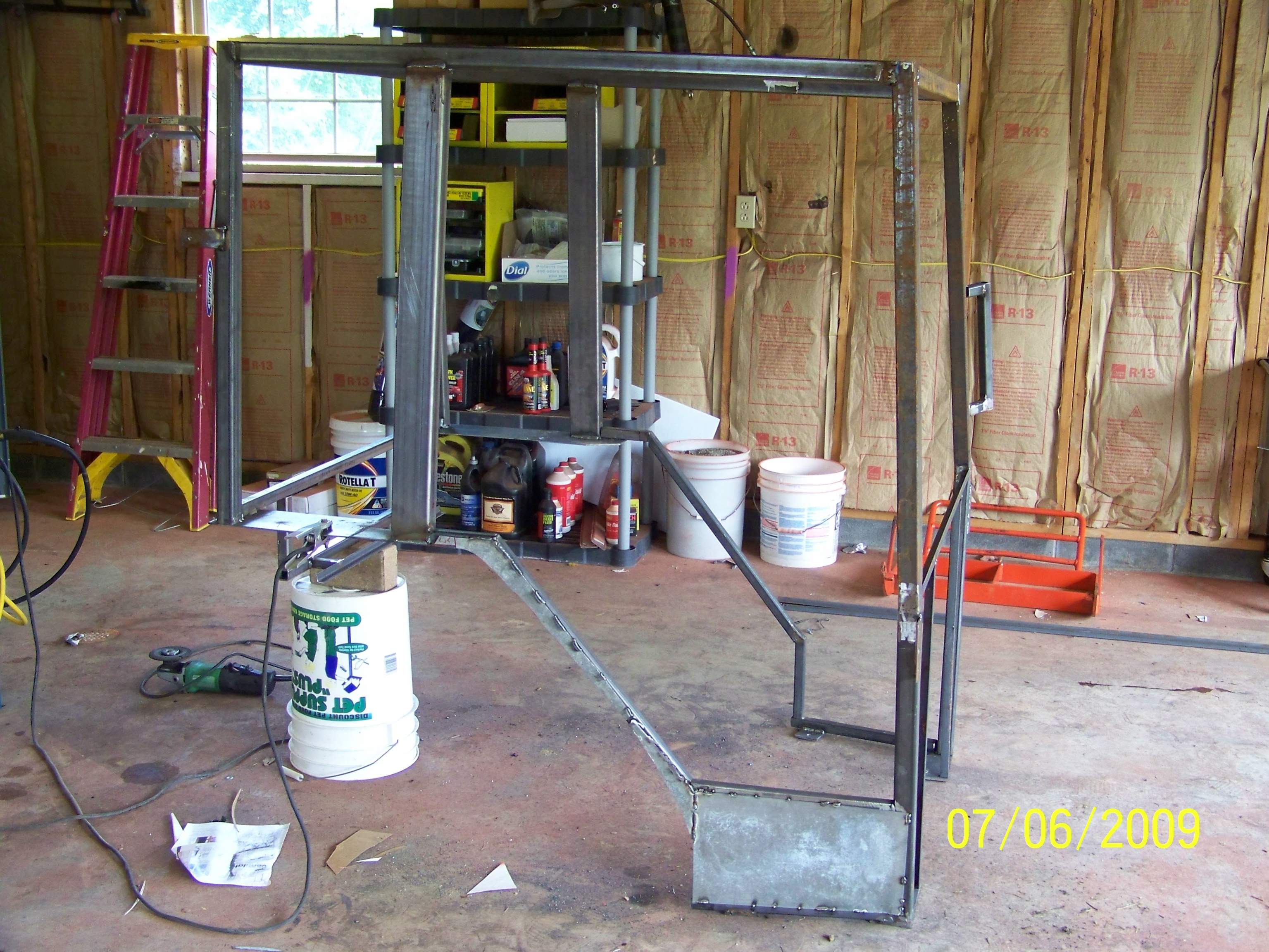

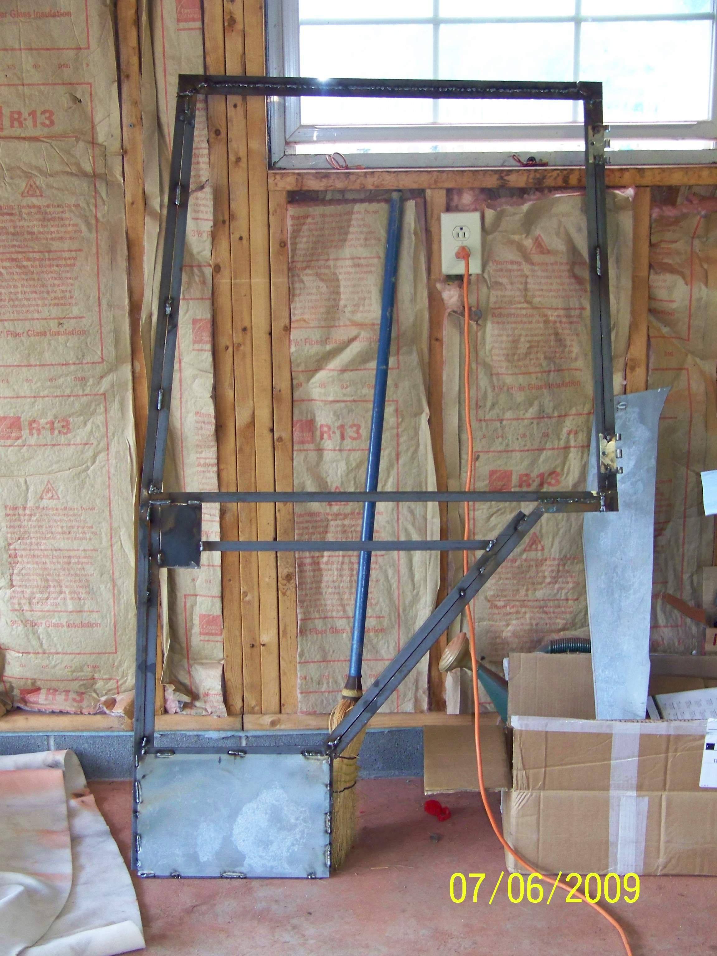

I worked on the cab yesterday for about 8 hours finishing up the initial fabrication and fitment of the door, and started skinning in the parts around the fenders, I also as you can see from the pics lifted the cab off to make it easier to do my final welding and to start to build the top, I am pleased so far with how it is coming along, it is an involved project but I know it will be worth it when it is 10 degrees outside :D

I was able to put a few hours in today on the cab, I finished up the welding and am begining to grind to prep for self etching primer and some bondo work, I will post pics asap.

Nicely done. Ive been wondering, are you going to have the loader joystick come through the glass?
/ Kubota L4200 Cab **Updated Thread**
#15
Johndeere3720,
No I just installed a new remote cable valve prior to starting on the cab, I did not like the loader mounted stick from day one so when I decided to build the cab it was my excuse to go with a new loader valve :)
I am off tommorow and will post pics of my updated progress.

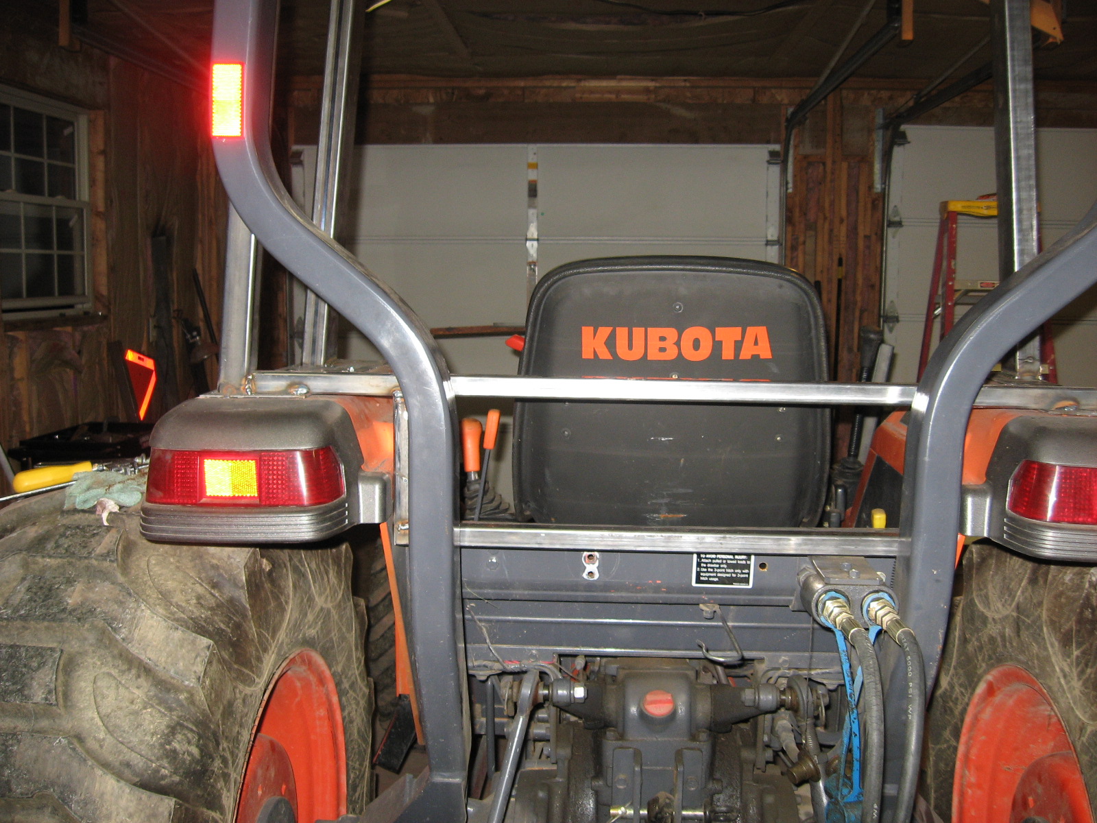

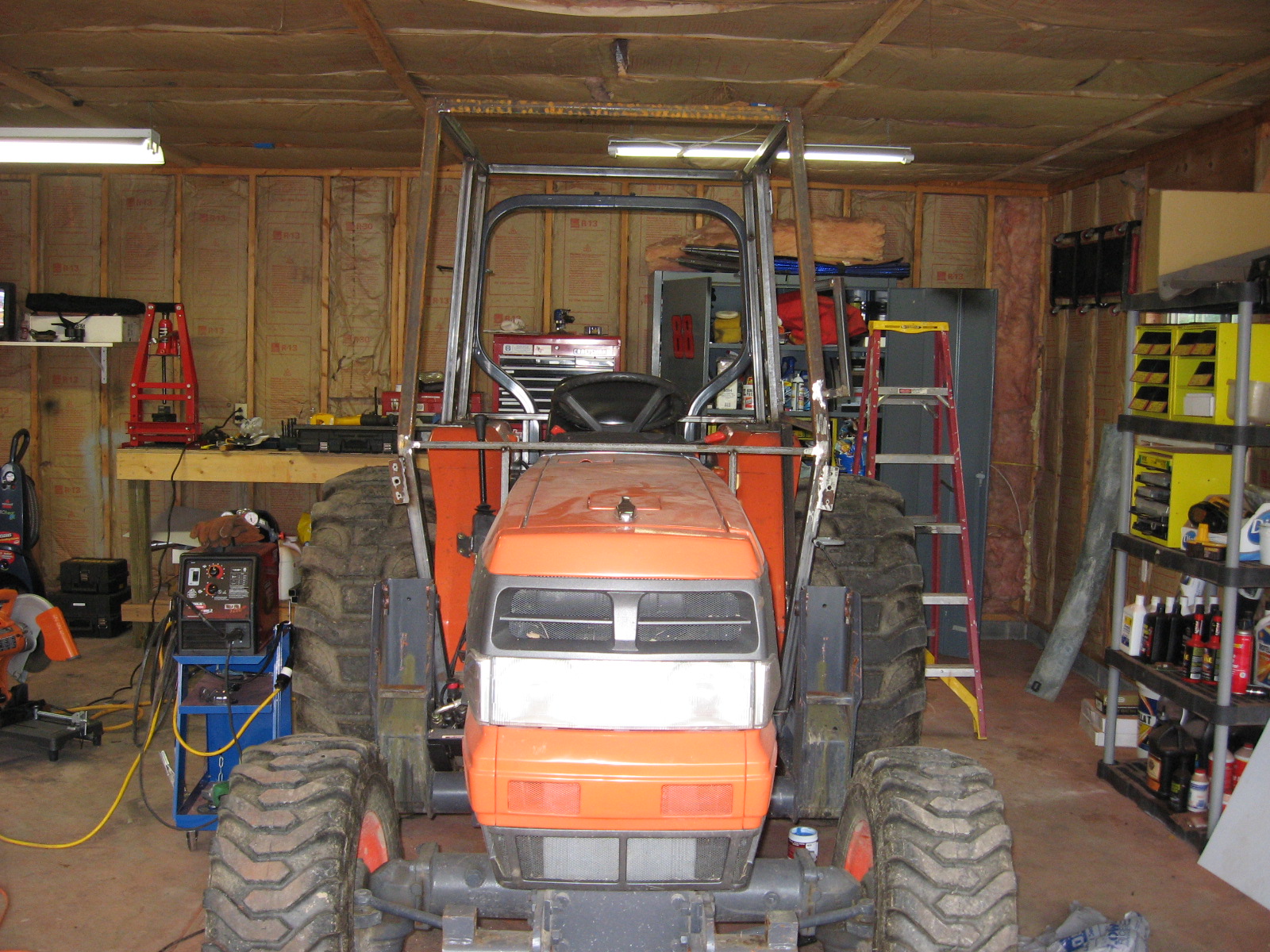

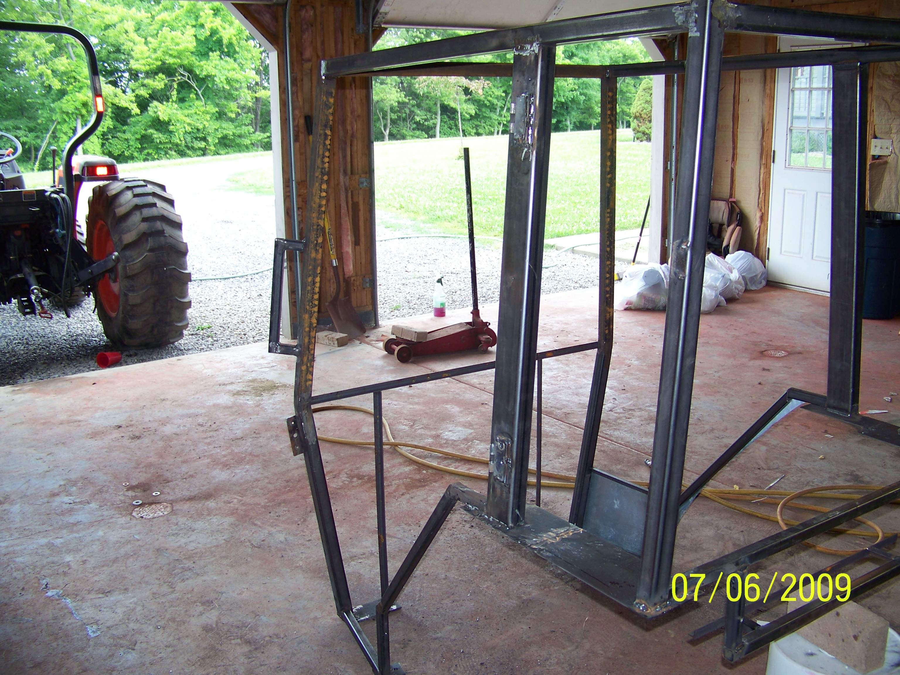

Here are some recent pics of my cab build, I have not been able to spend the time I have wanted to on it due to work, but i am getting there, Hopefully I will be painting it on Monday.
-Mike

Comming along very nicely! I enjoy your enthusiastic updates! Looking forward to the finished product! Think a guy could make one in Green? :D ~Scotty
/ Kubota L4200 Cab **Updated Thread** #20
I like it that you took the time to grind the welds flat as that definitely makes for a more professional appearance.
