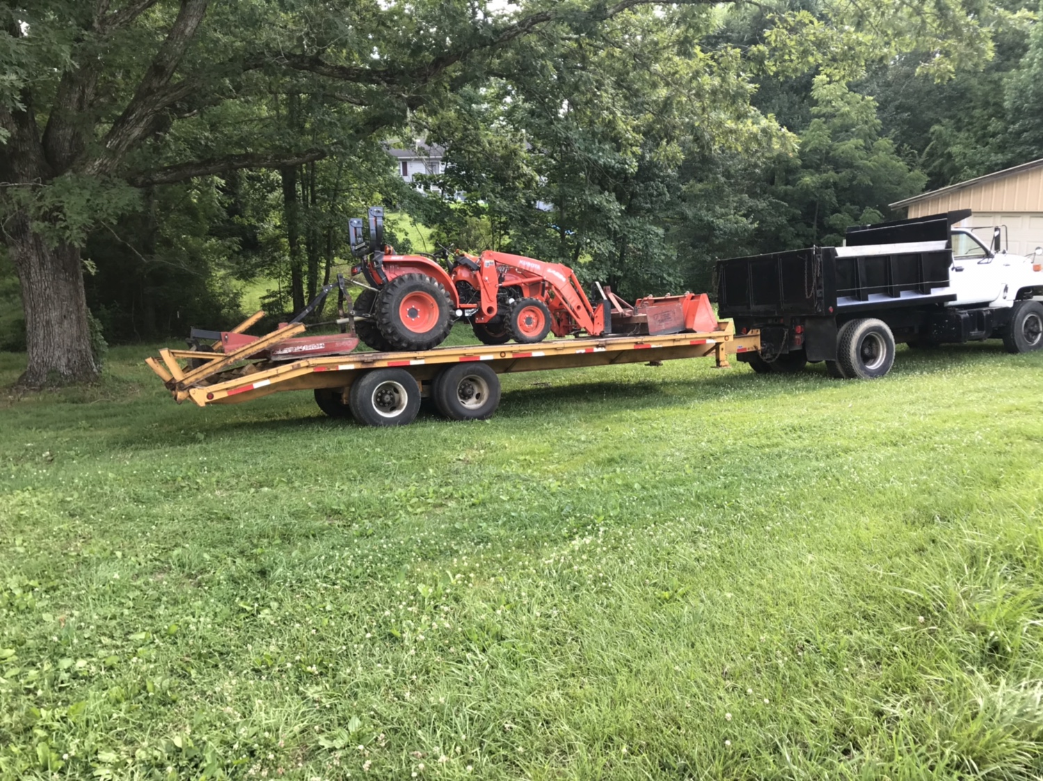

Its suprising how big of truck & trailer you end up needing to properly haul a not terribly big tractor.

R4. My dealer is the one who gave me the 30g per tire number. Whether or not it's valid, it's all I have to go on.
Thank you for sharing the Big Tex trailer weights. I must have misread some other information I previously found, but now I see you weren't too far off at all with your numbers. This indeed makes me more concerned that I may not be able to safely move my L3650 with loader/bucket, and a box blade with my current truck.
Tractor ~3500lb, loaded tires another 500lb, LA555 right at 1000lb, and L2256 is another 250lb. That with a ~3000lb trailer is 8250.
Box blade is another 400-500, depending on model (likely would get a 66-72" model).
My truck is rated at 6,900 GVWR, 15,975 GCWR, and max towing of 10,170. If I get a proper trailer around 3,000lb...I should be under limits with the weight of gear above.
6,900 GVWR + 8,250 for trailer/tractor...that's 15,150, which is 825lb under my GCWR, so I'd be legal. Definitely would want a weight distribution hitch and brakes on both axles. To be clear, my truck with passengers and gear is going to be significantly less than that 6,900 GVWR...but it's nice to go off that number. I'd say that's about 1k over what I'd really be for my actual truck weight.
I think you are right on the weights you list. My trailer with the L3560HSTC with loader, full fuel, and box blade weighed in right at 9,100. My truck is rated to tow 11,200 lbs. I have the trailer marked for proper placement of the tractor to ensure tongue weight. Also, where I tow is flat, as in biggest hills are overpasses on the highways, and pretty much at sea level.
Looks like there is a big difference in what 1/2 ton trucks are rated for depending on equipment. Also where you live and tow will make a big difference. If I lived where Fallon does I probably would not even consider towing the same rig with my truck, here it works fine.
