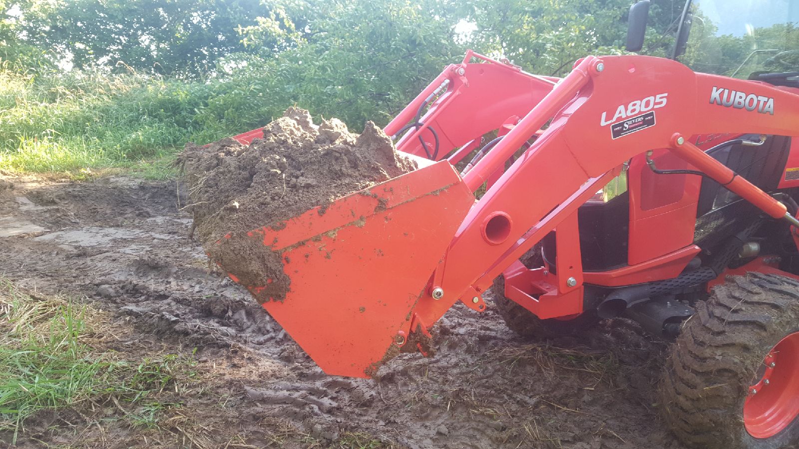

The one recommendation I would make, see if you can get the LA805 loader. This is a stronger loader and the L3560 will handle it.
The one feature that the 60 series has that I didn't realize that I would love so much is the HST+ transmission. That transmission is extremely useful and I'm a little surprised that Kubota doesn't put that on more of their tractors.

The one recommendation I would make, see if you can get the LA805 loader (1,290 pounds lift). This is a stronger loader and the L3560 will handle it.
LA555 Loader (900 pounds lift) is a little anemic for moving round bales of hay on the Loader.
To move round bales on the FEL you need 700 - 800 pounds counterbalance on the Three Point Hitch.
Alternately, you can readily move round bales using a bale spear or pallet forks on the Three Point Hitch.
Also consider the optional SSQA L2296 heavy-duty, round-back FEL bucket.
