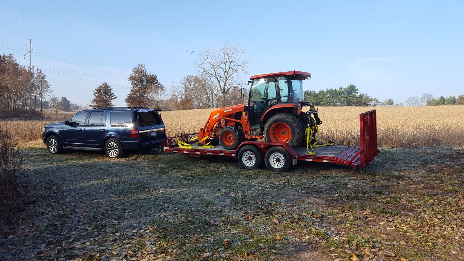

I appreciate all the advice here. Everyone has said get the LA805, but I'm in a tough spot here. My local dealer went and picked up this tractor and loader (LA555) for me from another dealer, and has already assembled it. I'm not sure if they have a LA805 in stock, or how quick they could get one, and how that process would go for them to remove the 555 and install the 805, would they charge me for that, etc, etc. I'm thinking I'll just keep the L3560 with LA555 and use it as long as I can, and if I find I need more tractor, I'll trade up to maybe a bigger Grand L with a bigger loader then? Who knows, the 555 may be perfect for my uses around my property.
Side note, I'm curious for other L3560 owners (or similar size/weight) what you use to tow with. I have a Ram 1500, rated for just under 10k towing, though I feel I would hit GVWR or tongue weight limits before I can get a 10k load behind the truck. I have a tandem 16' trailer, but planning to buy a 20' bumper tandem for other things anyway (pair of UTVs), so I'm curious if I could realistically tow my L3560 with my truck on a 20' tandem trailer (2 7k axles, 1 with brakes)? From what I gather the trailer is ~3500lb, +1000lb for the LA555, +400lb for tire ballast, +400lb for box blade. That's 5300, might as well say 5500lb with fluids and anything I might be forgetting. I'm guessing 2500lb for the trailer, that's 8k behind a 1/2 ton truck. That should be doable, right?
I've pulled a few ~3500lb cars behind my truck on a 16' trailer just fine. Towing the tractor would be infrequent, but I've never pulled a load quite that heavy before.
   / Kubota L3560 Open Station #38
I would at minimum get brakes on both axles. And the fluid is probably at least double your estimate. If it’s a LA724 loader I might live with it if it’s really a 5 series loader make them change it. You’ll regret having that ridiculous loader forever.
   / Kubota L3560 Open Station #39
I use my Ford Expedition rated to tow 9,200lbs. My tractor and trailer weight should be about 8,800lbs, but that is without any of the implements or bucket. I have towed it twice and both times the SUV handled it well. We do have brakes on both axles.
   / Kubota L3560 Open Station #40
Yeah, the brakes are the most important part of towing against the limits. :thumbsup:
