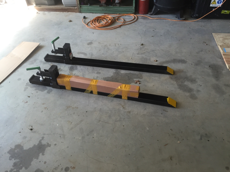

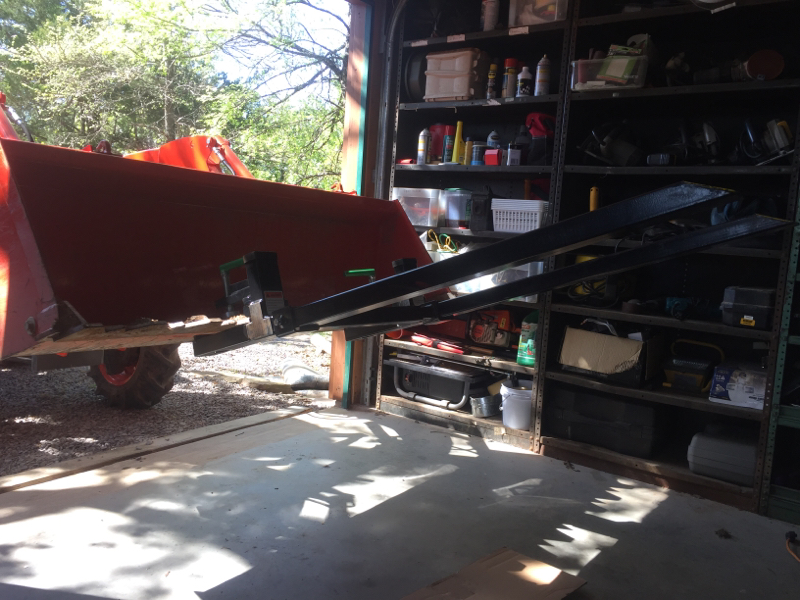

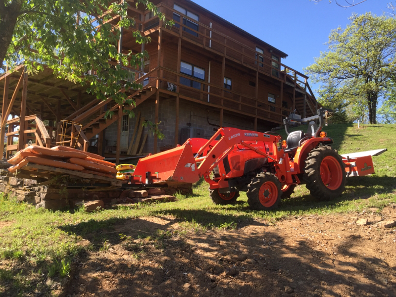

The new clamp on pallet forks set arrived today at 81 lbs I was pleasantly surprised of the heavy duty construction.
There is also keyhole slots built into them for chain and binder securement.
Though they work and I was able to hang 300 lbs off the tips with no flex I am brainstorming on a a few items to make it more compatible with my Piranha tooth bar.

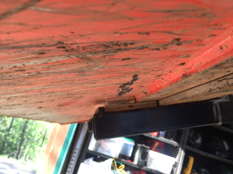

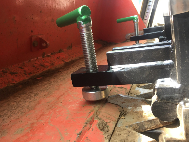

1. The clamp pad overlapped the piranha's tooth bar mounts about 1/8". This was easily solved with a 4" angle grinder.
2. Next thing was the bottom piece doesn't quite touch the bucket for rear support. Though no flex is detected in the tooth bar or bucket, I'll feel better with some contact. I've mocked up a filler from 3/8" plywood strips for now before I start metal work.
3. I may cut a tooth back slightly big or small is undecided in order to move that clamp pad slightly rearward and all me contact area at the connection point where the fork is jammed into the tooth. It is solid now, but more is better.
Gonna mull it over a night or two. Ideas from the brain trust are welcomed.
When I'm done I plan on using these on my
HF quick hitch
The loader bucket
And the secret weapon. On my EA grapple.
That's why I went with clamp ons instead of a dedicated set
