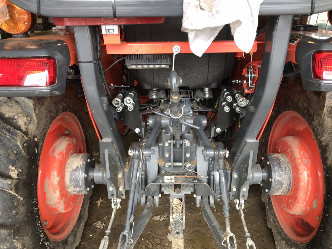

#105
And I’m about 90% done on this one. Still some minor items to finish up but want to work it a bit and see if changes are warranted.
I made the QD brackets out of 1/4” plate. Cut with plasma cutter and drilled with the press and hole saw. IMG_0422.jpg
Painted black and then installed 4 lines on each side to the rear.IMG_0428.jpg
Cleaned up the routing of the lines on the valve and reinstalled the loader. IMG_0429.jpg
Turned out pretty good, lines are all neat and nothing touching paint and still have access to disconnect the loader lines like normal. I changed the outboard valve from a spring center to a detent so I can run the backhoe or a continuous implement like a splitter if needed.

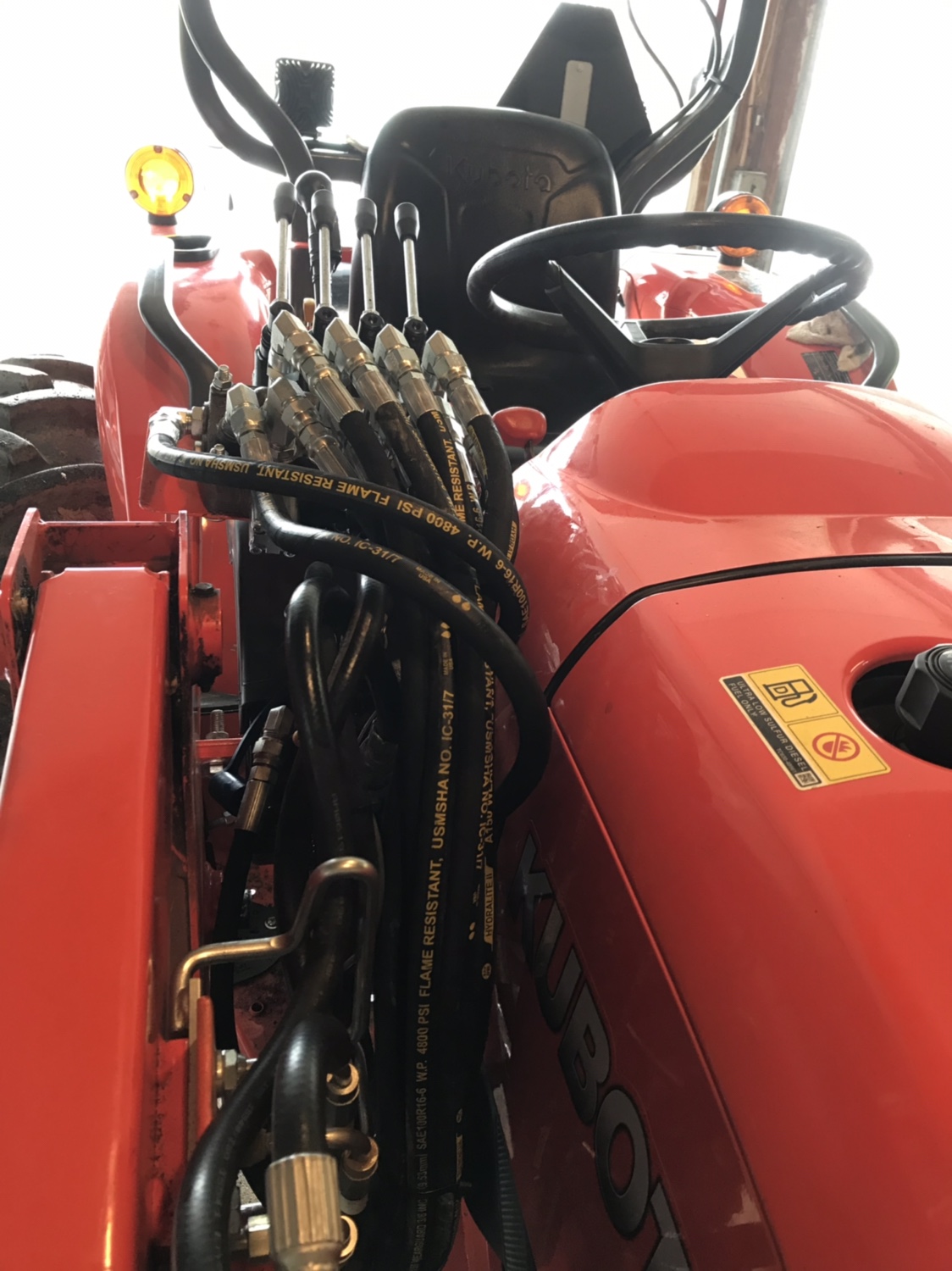

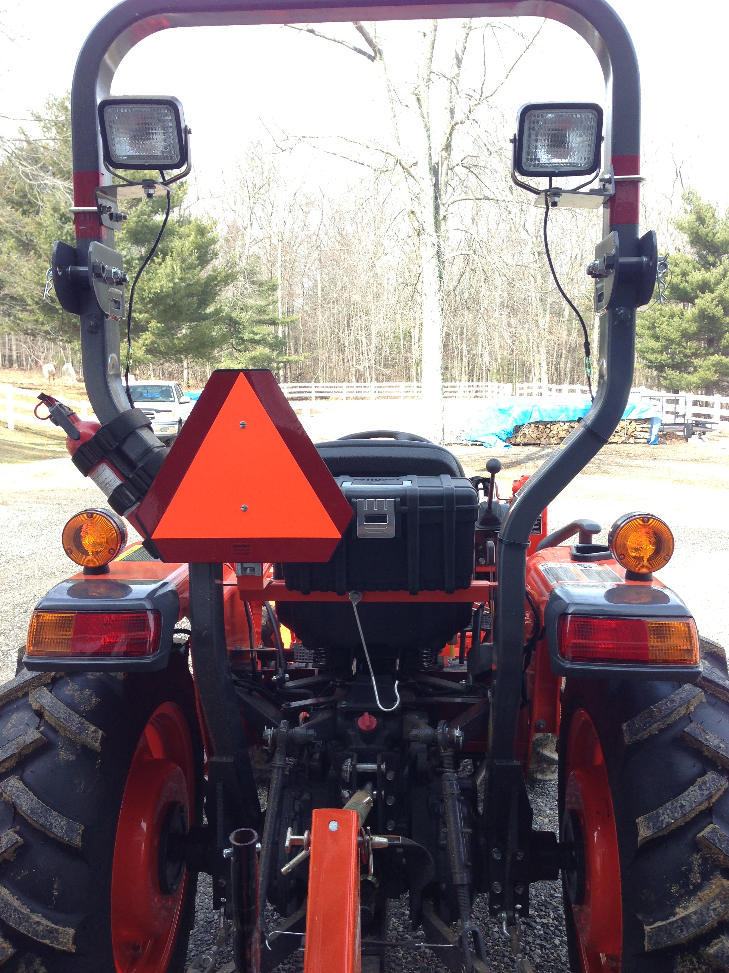

Got the toplink cylinder in today and installed. I didn’t like the routing of the lines and the fact that they smashed into the back of the seat sent me back to the interweb to see if you guys had answers.
So Thanks to KennyD of Bolton hooks fame for the tip on turning the check valve assembly around. Thanks to Brian at Fitrite for telling someone about using longer 1/4” hoses than the 1/2” 18” ones I had. And a whole bunch of other tips for toplink hose routing.
I’m not done. This is the temporary version. I’m missing some fittings for the 1/4” lines from my local tractor supply.
But it did work and I was able to switch between 5 implements yesterday without leaving the seat!
