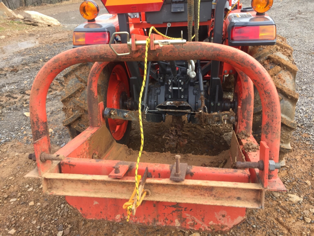

Today I installed a receiver hitch on the rear of my box blade in order to not drop it off and change to the three point receiver hitch adaptor I have when I wanted to move one of the trailers or boat.
I read a few threads and was gathering up the materials to make a hitch when I ran across a hitch from Titan for a John Deere Gator mount.
I wanted a bolt on if possible.
Here it is.
This is the way it is supposed to be installed. I did try it upside down at first which moved it up a couple of inches. This made the hitch too high without running a big drop down hitch.

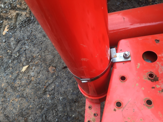

Finished up my version of the chain storage carrier. Nothing fancy. I wanted to avoid drilling holes in the tractor if possible. (After all, it is only two months old.)
I used a piece of 4" PVC and a cap cut the height off even with loader frame support.
To go along with my not drilling holes theme, I used a piece of angle that was about an 1/8" thick and wouldn't bend. I used one of the floor and step holes with a couple of washers and locknut to secure one side. Though I used a fancy stainless clamp to put mine on, a hose clamp or even another bolt washer nut combo would work fine I think.ImageUploadedByTapatalk1456332709.761603.jpg
On the bottom, was just a drilled hole through the cap and another set of bolt,washers, & locknut.
I didn't glue the cap on. I meant to but the friction fit of it when I pre assembled everything wouldn't come back apart so I figured "good nuff".
I still need to drill a few drain holes in the cap. I missed that and had painted it already when I caught it but that can be done on the tractor.

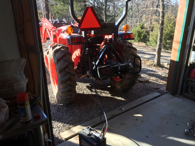

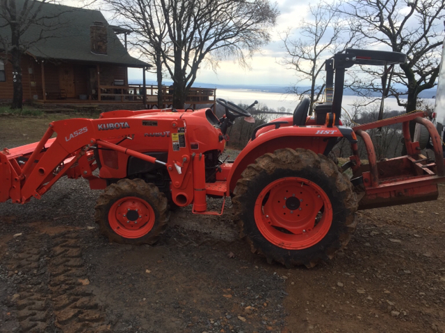

Working in my latest. I had a Warn 5000 that the solenoids had quit on so I ordered a contactor and replaced them. Harbor freight has a haul master winch plate for the receiver hitch.
I had ordered a quick disconnect but I ordered it for the wrong size wires. I plan on wiring it to the battery and cutting one end off a set of jumper cables in order to use the winch on other vehicles or the trailer with a matching disconnect on them. ImageUploadedByTapatalk1456526014.638990.jpg
I checked my Hydraulic pressure today and found it a little low at 2200 psi. I shimmed the relief valve up to raise it to 2400. Max for the L3301 is 2417. Really seemed to make a difference.
Picked up a dirt scoop on CL for cheap. The trip mechanism was frozen but a little time with wire brush, penetrating oil and a pry bar got her working again perfectly. This allows me to carry more dirt on the rear at same time. Seems to really be useful so far.

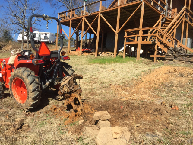

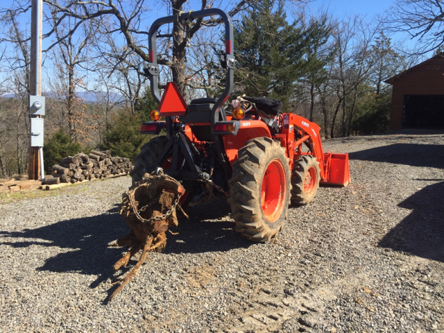

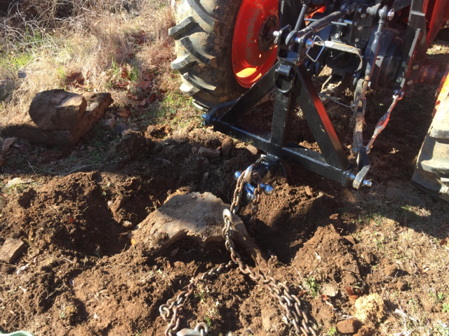

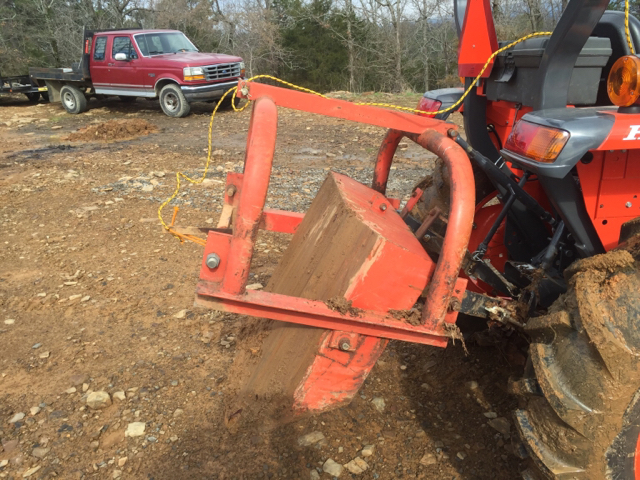

Yes I do work it occasionally<laughing> today was a stump removal morning. This one was lifted with the 3 point and I would cut and dig each root until it came up using a saws all with a demolition blade.
I didn't try yanking it out so no flames please!

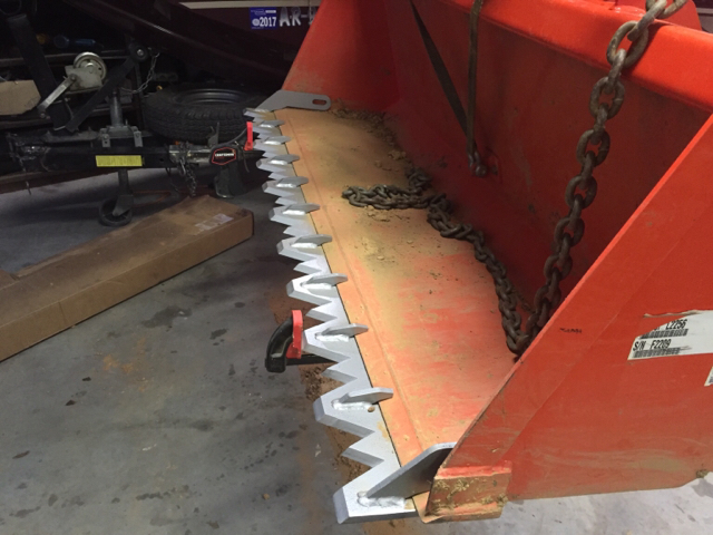

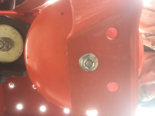

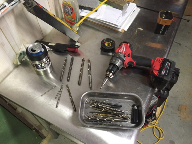

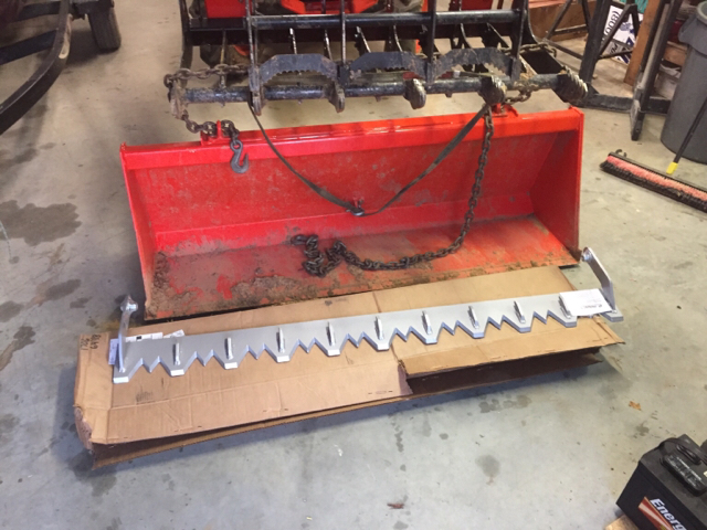

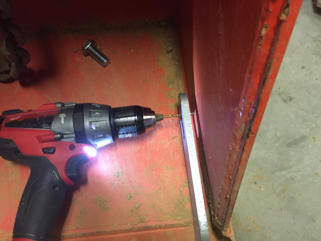

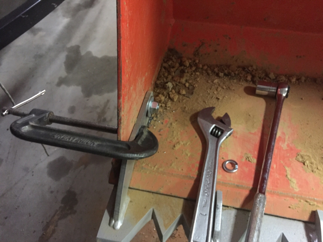

UPS man showed up late last night and came bearing gifts!
Wife is out of town so had choice between watching Tv or hanging out in shop installing it and drinking beer. You know what happened.
Thing is heavy at 51 lbs shipping weight. And the edges are Sharp! I hung it on the bucket after cleaning some of the Oklahoma red dirt back. Then my toes requested that I put a couple of bar clamps on for safety.(instructions said all that also)
I was kinda dreading that 3/4" hole to drill on each side but not bad after remembering some old tricks. I don't use oil.
First, an old timer taught me a long time ago to use a cordless on low. The speed would actually allow the bit to cut rather than skate and build up heat. This is my best method I've found. And for some reason, both of my dewalt corded drills try to spin and break my arm when they hang up. ImageUploadedByTapatalk1456582290.820282.jpg
I drilled a pilot hole (about 1/8") from inside centering between slot up and down and about 1/8" from the rear of the slot. Per instructions this will account for the bucket lip wearing through time. Pretty smart!
ImageUploadedByTapatalk1456582038.943189.jpg the rest of the drilling went on from outside. One step at a time. This keeps the bit cooler also as you keep changing them out. I used a uni bit for the last 1/8" as my bits ran out at 5/8".
Bx builds them with a little clearance in order to not have to fight them in or out. This makes it necessary to start the bolts and nuts, remove the clamps(let's be safe!) and c clamp one end in order to remove nut and stack on the remaining lock washer. X2 for other side.ImageUploadedByTapatalk1456582655.186845.jpg
Torqued them both down and we are ready for a test run tomorrow. It's a little late to be digging at 10 pm. I live in the country but my neighbors would surely wonder WTH!
First, an old timer taught me a long time ago to use a cordless on low. The speed would actually allow the bit to cut rather than skate and build up heat. This is my best method I've found. And for some reason, both of my dewalt corded drills try to spin and break my arm when they hang up. View attachment 458656
View attachment 458655 the rest of the drilling went on from outside. One step at a time. This keeps the bit cooler also as you keep changing them out. I used a uni bit for the last 1/8" as my bits ran out at 5/8".
Bx builds them with a little clearance in order to not have to fight them in or out. This makes it necessary to start the bolts and nuts, remove the clamps(let's be safe!) and c clamp one end in order to remove nut and stack on the remaining lock washer. X2 for other side.View attachment 458658
