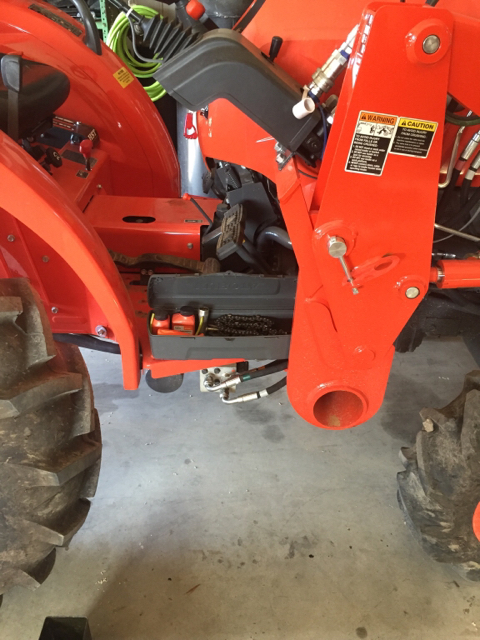

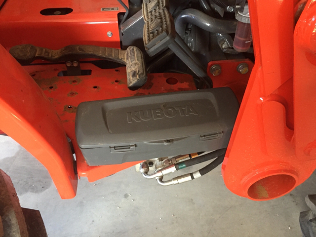

My power SSQA install might be interesting for further pimping. Although it would be less useful if you still had to connect/disconnect 3rd function hoses.
http://www.tractorbynet.com/forums/customization/321704-linear-actuator-power-ssqa.html

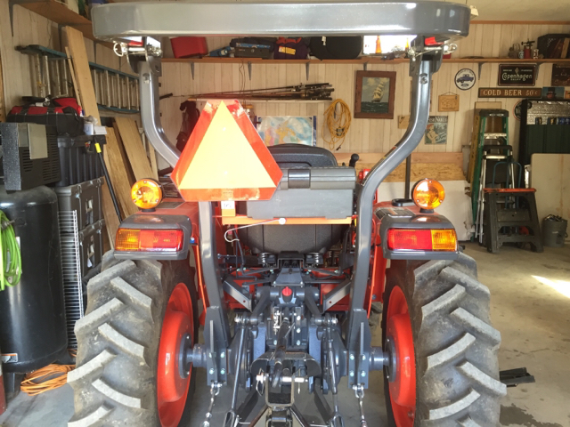

I love my bucket hooks & ROPS lights, but not as thrilled with the bucket cam (just not as useful as I'd hoped).
TnT is insanely useful if you do any grading work. It also makes hitching up an implement to a quick hitch an event that doesn't require getting off the tractor.

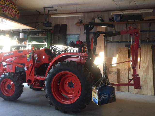

The back tires are loaded. I have plans for a carryall to carry more.
That rock is pretty heavy as you can see. That is a poser shot <laughing>. The tractor won't pick it up. The curl is the only way it lifted the rear end.
I wasn't moving anywhere.

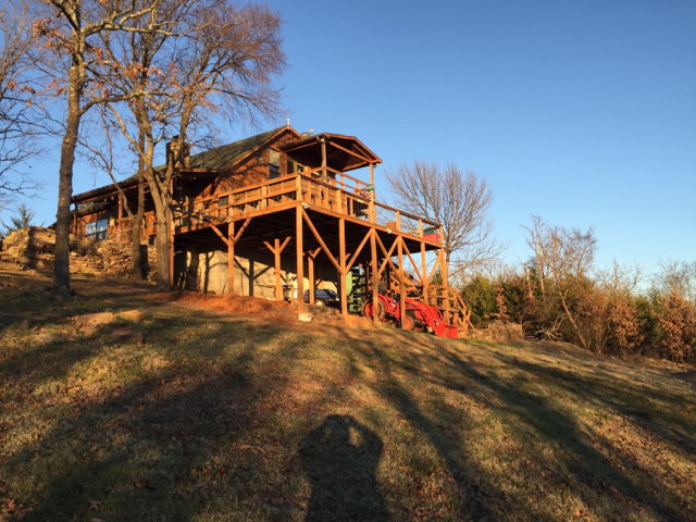

Thanks on the info about the wheel spacing. That back hill showing in one of the photos is an honest 30 degree slope. I've had trouble mowing it with a rider and ZTR with wife actually managing to turn the rider over on it once. I had asked the dealer to move the tires out before delivery but they only moved them to the normal centered position. I've been debating moving them but hesitating knowing that wheels are weighted and I work alone.
I did a quick test to see where the realistic limits were with the current setup.
I parked the tractor ROPS up on the side hill sideways on the steepest part that always has scared us with the bucket hovering over the ground. I then got off (if anyone does this, please don't be a d****ss like me and park where you get off on the downhill side. We had a moment there.)
I then gently pushed on the ROPS on the uphill side and watched the tire lift easily off the ground with just a little force. So it was close to the balance point.
Then, I took my IPhone, set it on angle finder mode and laid it flat on the transmission floorboard. It read 30 degrees. So now I plan to build up any of the yard I have to be on to less than 30 degrees. ImageUploadedByTapatalk1452257571.324900.jpg
