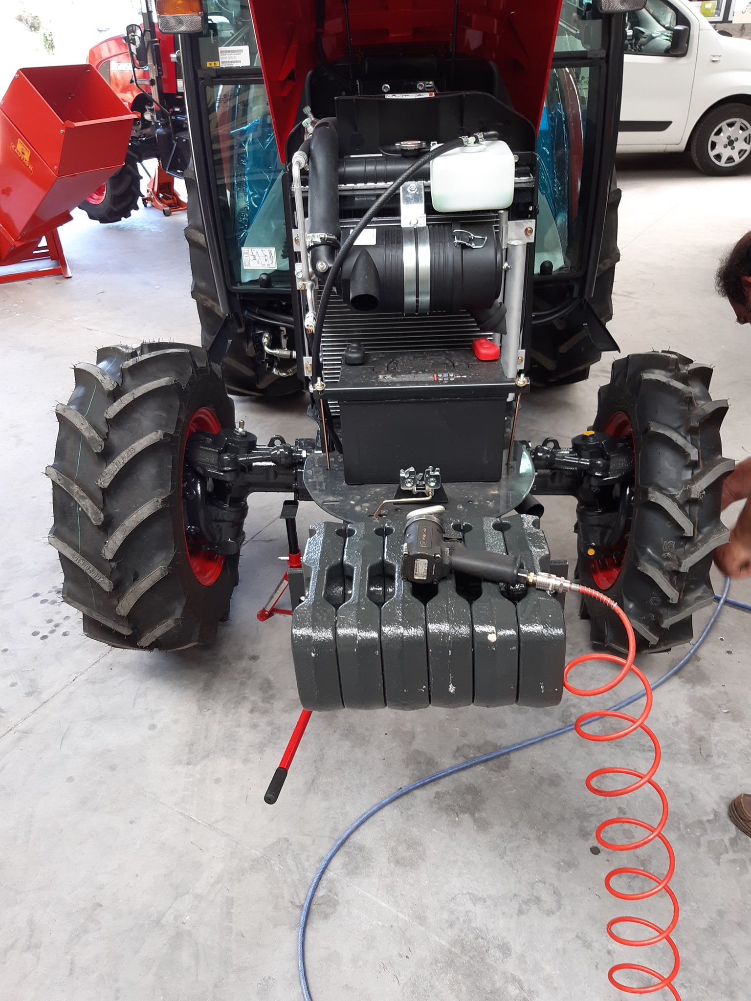

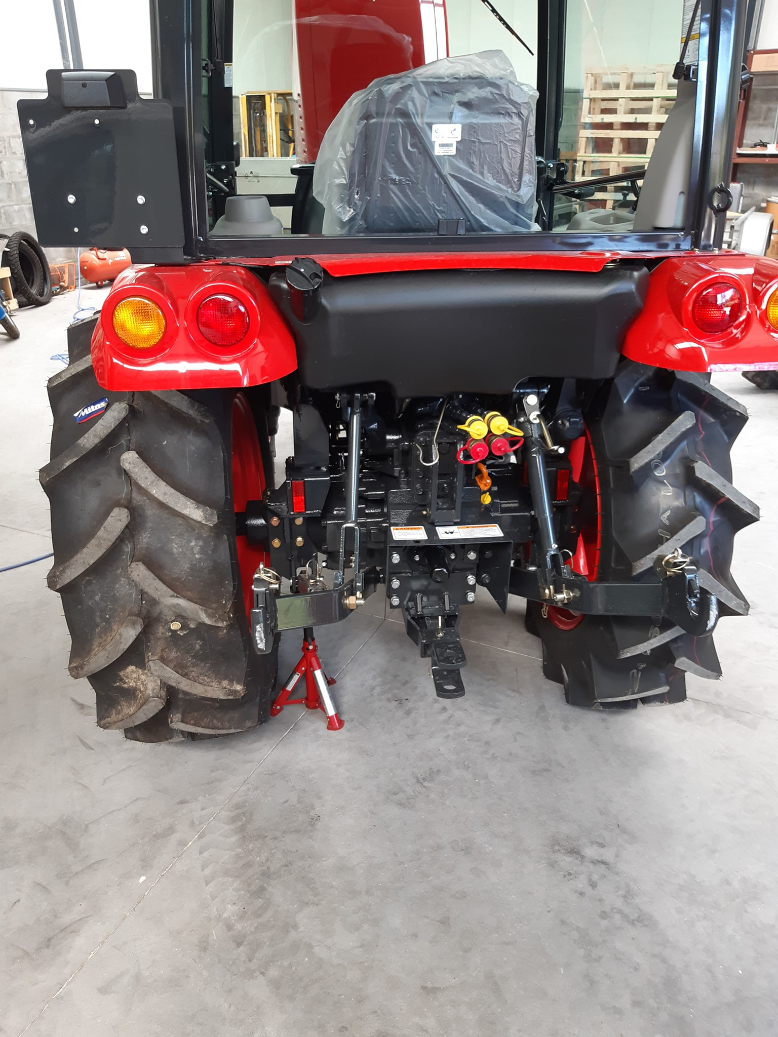

R1 Radials may be something to consider. It's the way to go when it comes to traction, floatation, stability, wear, rider, and so much more. Although, it's not common to be used in the US on CUT and smaller tractors so it may be hard to find for these smaller tractors.
Also when the tractor the is fitted with R1 Radials, both front and rear rims will be adjustable. The R1, just the rears are adjustable.
Here is a comparison from R1 Radial (Left tire) to conventional R1 (Right tire).
View attachment 729477 View attachment 729478
Picture speaks a thousand words.
