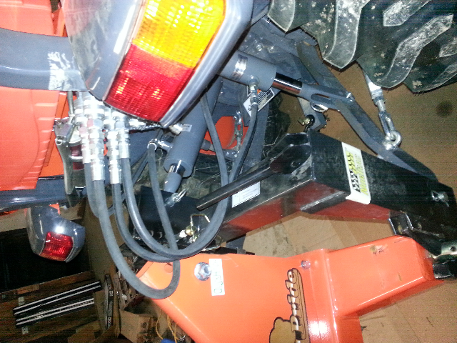

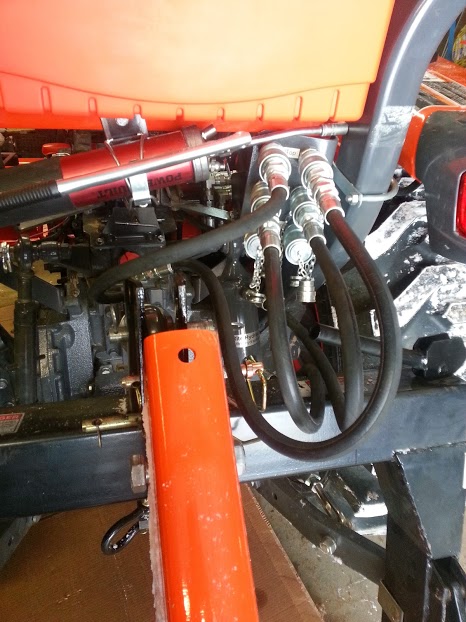

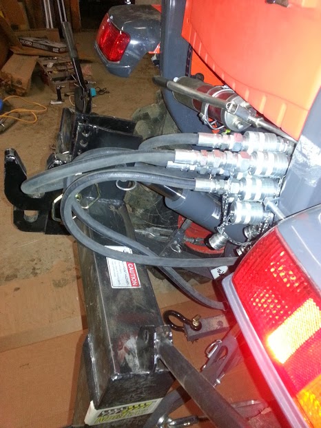

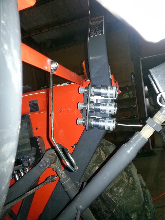

Picked up a pile of 2"x2"x1/8" angle iron yesterday. Going to chop it up & drill hols to make a single stack QD mounting bracket rather than double stack & see how that works for keeping the TnT hoses out of the way. Might have hose length issues on both sides, but we'll see.
   / Kubota L3200 TnT & 3rd function install (work in progress) #43
Fallon, would 90s at the male QDs get the hoses going down and out of the way of the QH? Still might need new T&T hoses, but could end up with much cleaner hose routing. :confused3:

I've been looking at that & a lot of stuff.
  • The 45's on the back of the QD's prevent me from moving the QD bracket further back (towards the seat)
  • I can't lower or rotate the bracket without the 3pt arm hitting stuff on the back side of the bracket (at least with the double stack)
  • I might be able to put 90's back there & have them pointing off to the side slightly so they aren't on-top of each other blocking the ones below
  • I was looking at some 45 degree bulkhead QD fittings, those might get some of the clearance I'm looking for, thought about 90's on the TnT end of the QDs as well
Limiting the lift height of the 3pt like Number9l did would solve a lot of problems, but that just seems like cheating to me, I want it all to work all the way
I keep looking at things & thinking it through more. Every time I think I have a good idea, there ends up being a restriction somewhere when I run some function to one of the limits. Have a cart full of assorted fittings sitting on my computer at home I keep adding to & removing from. Will probably get a handful of fittings to mess with & build up my spare parts drawer for hydraulics (I expect a handful of future projects anyways).
It works for now if I'm careful. Happy with everything from the valve forward & I'll eventually get the back end sorted out. Now that it's functional some of the urgency is gone so I'll keep puttering with it. May look at new hoses, we'll have to see when I get it all figured out. We moved to the 5 acres so I could get a shop to tinker & putter in, so I guess this fulfills some of that destiny. :p

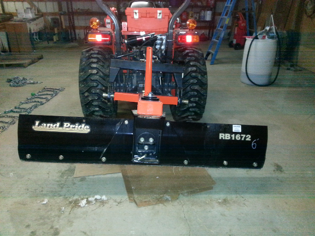

Got a decent chance/excuse to use it Christmas eve. Cleaned up some scattered implements. Between the QH & the TNT it was pretty easy to pick em up and drop them off without getting out of the seat. Deliberately set a couple off kilter on logs or what not. Tilt made it dam easy to still pick em up.
Messed with some grading a bit. Tilt easily switches the box blade from blade to ripper. I'll try more tilted box blading later, but this let me see that I'll be able to get the slopes I want on cross cuts.

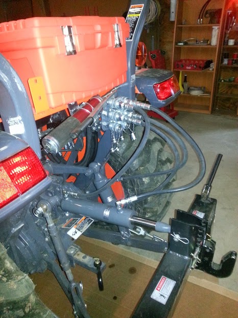

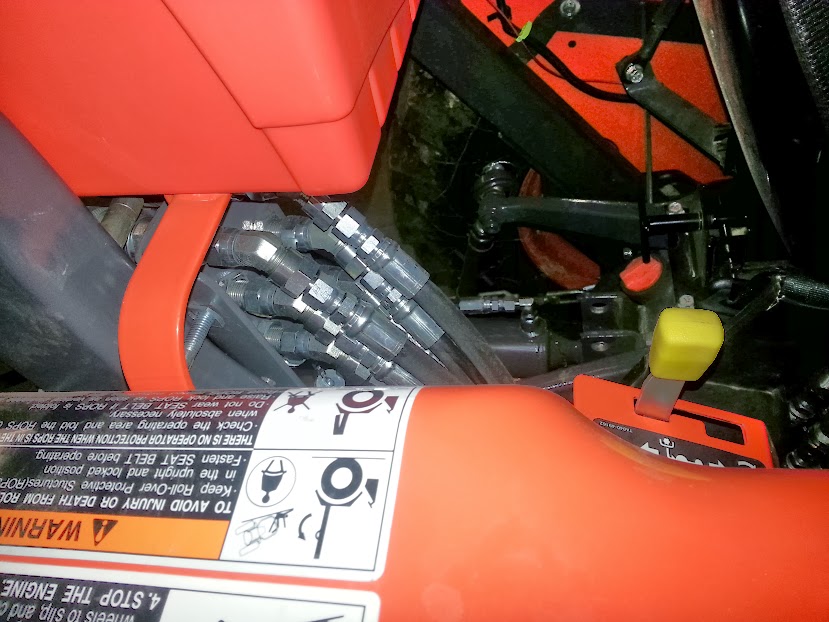

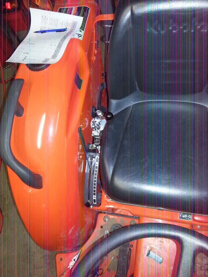

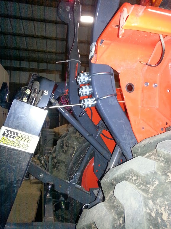

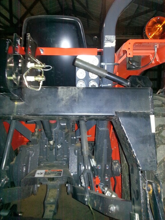

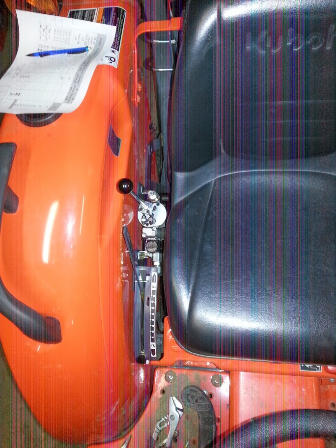

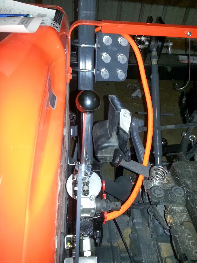

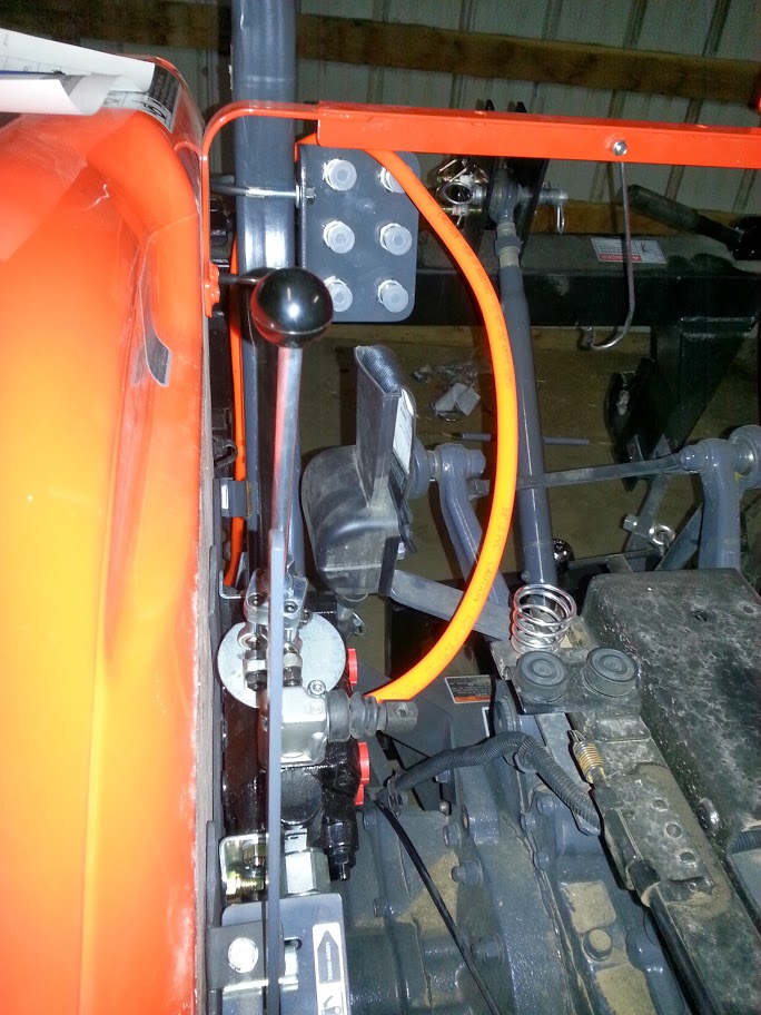

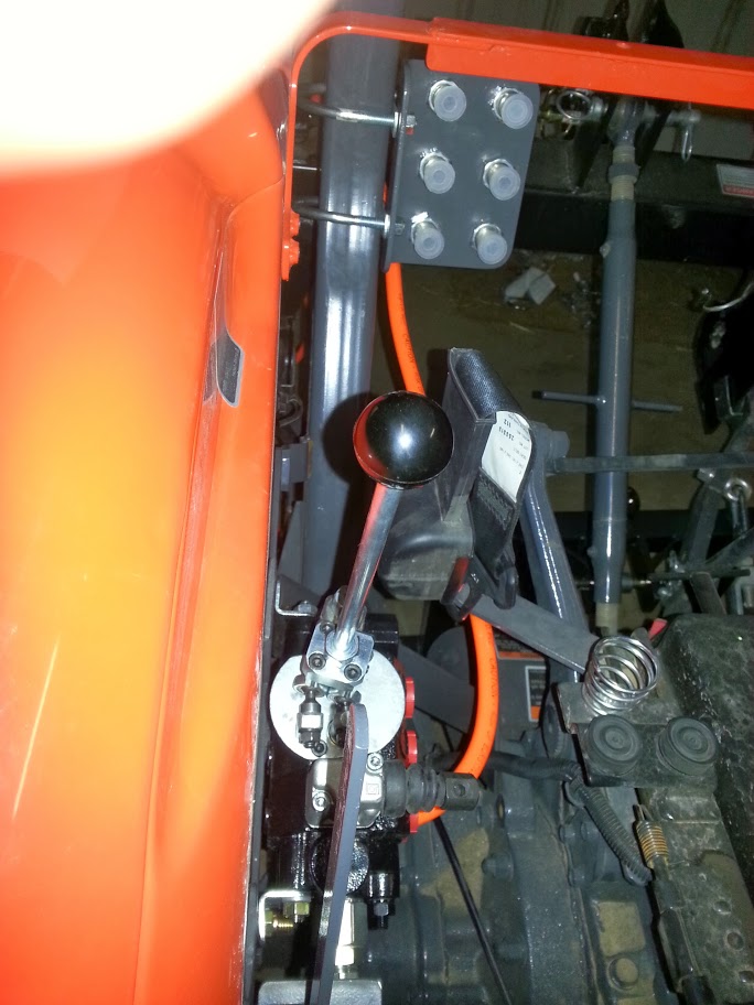

Got the valve mounted & fender somewhat back in place.
It looks like tucking the manifold just under the crossbar will give me enough clearance for everything & straight fittings on the back. I left a 7/16" (i think) wrench hanging out of the bottom QD to help judge distance & level. 3pt hitch was all the way up (propped it up manually, might not go quite that high on it's own) and have the top link relatively close to as short as it can go. Guessing at the port locations a bit on my measurements at the moment. I'll have to re-think my port order a bit, 90's on the bottom QD would be good for the top or tilt, was going to use that one as the 3rd function to limit possible rubbing on my quick hitch. Probably going to sleep on it or maybe wait for my cylinders. At the very least I need to re-measure after firing the tractor back up & running the 3pt to it's limits.
View attachment 345317 View attachment 345318 View attachment 345319
Debating what route to go coming out of the valve. It looks like I have enough clearance to come straight out of the valve and go over or under the seatbelt bracket. I took some measurements from the end of the red plug covers, but am not sure what length of fittings I may need to factor in. I like the staggered 90 degree fittings on Number9l's install coming out of the valve body, but not sure that would buy me mutch. Leaving a big curve coming out of the valve body would give me a bit of wiggle room if the hose is an inch or 2 to long whereas a pretty straight shot from a 90 degree fitting straight into the back of the manifold. Definitely going to sleep on it.
View attachment 345320 View attachment 345321 View attachment 345322

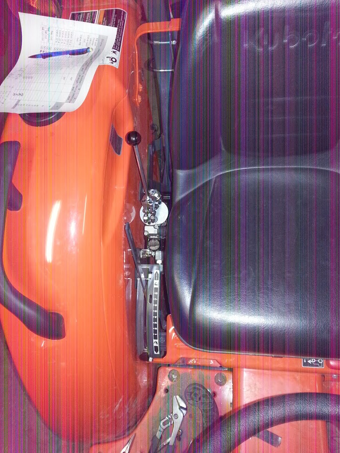

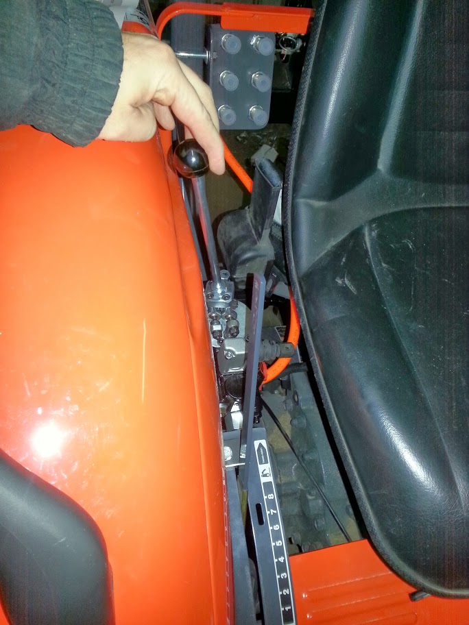

Photos of the joystick in detent both directions, centered & pushed up to the fender with an inch or an inch and a half to spare. My phone apparently had some issues on a couple of these, the battery was dying.
View attachment 345324 View attachment 345325 View attachment 345326 View attachment 345323

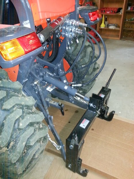

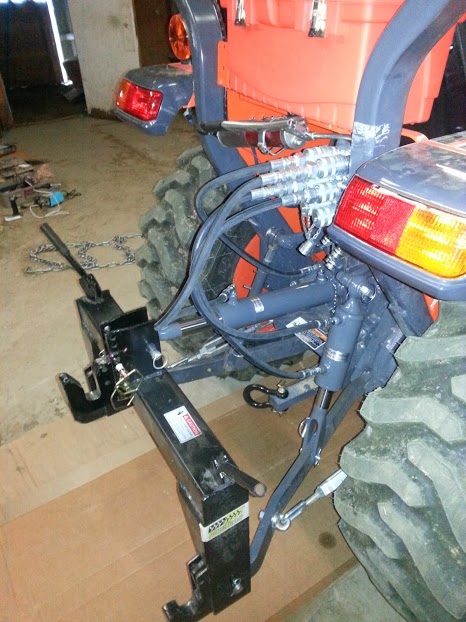

Cleared some snow this afternoon... Really liking the function of the TnT still. Took some photos of where things sit now & left the blade on & up (33" to top of blade on each side). Will re-measure it next time I'm out there & see if either cylinder seems to be dropping.
Currently there is only 1 U bolt holding the manifold on & it's a bit loose, which helps on the clearances a bit. The 45's on the back mean I can't push the bracket towards the front of the tractor any more. The way I have cylinder fittings finally rotated now I only get binding issues all the way up when retracting the top cylinder. At least 1 hose gets a bit tight when the 3pt is all the way down too. Pretty usable unless I bottom out the hitch or raise it with the top cylinder in.
I have a small stash of assorted fittings coming to fiddle with & see what room I can free up, whenever it warms up a bit. Some kind of rounded guard over the bracket attaching to the top cylinder might help keep that hose from hanging up there too.

26" & 30" when I measured today 4? days later. Top cylinder looks like its come out a little over an inch (which takes about an hour to unscrew my OEM toplink that far it seems).
Assuming it leaks twice as much when warm (I doubt it) it would still be a non-issue. I'm happy with it.
