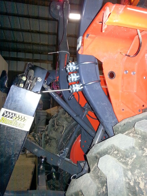

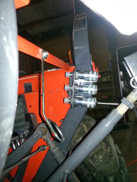

I've been looking at that & a lot of stuff.
  • The 45's on the back of the QD's prevent me from moving the QD bracket further back (towards the seat)
  • I can't lower or rotate the bracket without the 3pt arm hitting stuff on the back side of the bracket (at least with the double stack)
  • I might be able to put 90's back there & have them pointing off to the side slightly so they aren't on-top of each other blocking the ones below
  • I was looking at some 45 degree bulkhead QD fittings, those might get some of the clearance I'm looking for, thought about 90's on the TnT end of the QDs as well
Limiting the lift height of the 3pt like Number9l did would solve a lot of problems, but that just seems like cheating to me, I want it all to work all the way
I keep looking at things & thinking it through more. Every time I think I have a good idea, there ends up being a restriction somewhere when I run some function to one of the limits. Have a cart full of assorted fittings sitting on my computer at home I keep adding to & removing from. Will probably get a handful of fittings to mess with & build up my spare parts drawer for hydraulics (I expect a handful of future projects anyways).
It works for now if I'm careful. Happy with everything from the valve forward & I'll eventually get the back end sorted out. Now that it's functional some of the urgency is gone so I'll keep puttering with it. May look at new hoses, we'll have to see when I get it all figured out. We moved to the 5 acres so I could get a shop to tinker & putter in, so I guess this fulfills some of that destiny. :p

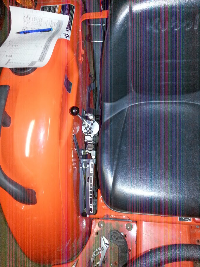

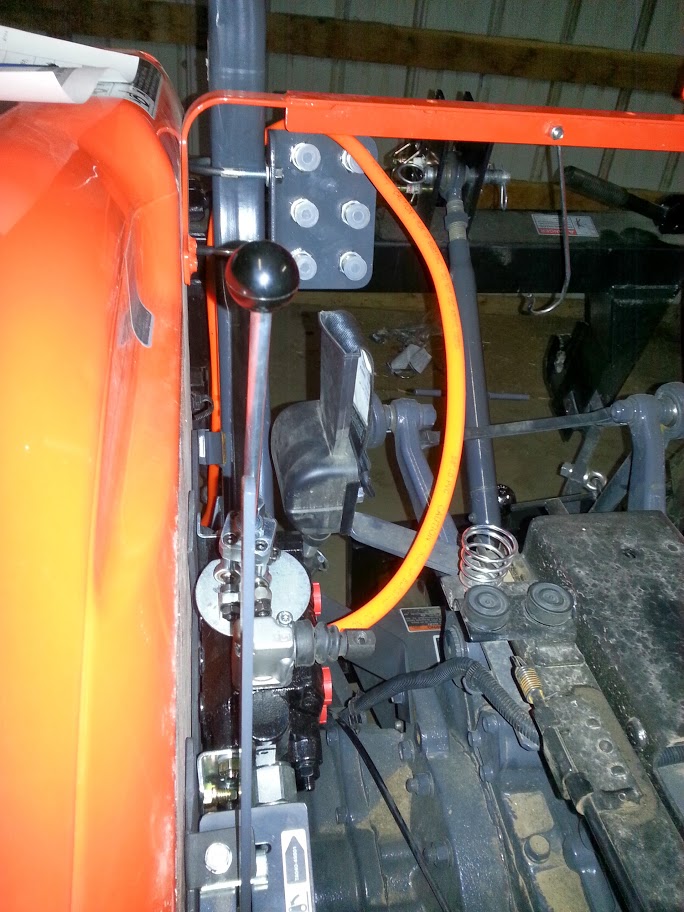

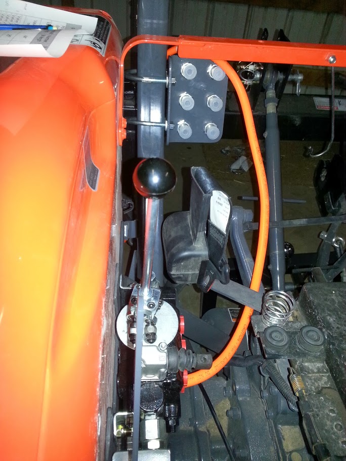

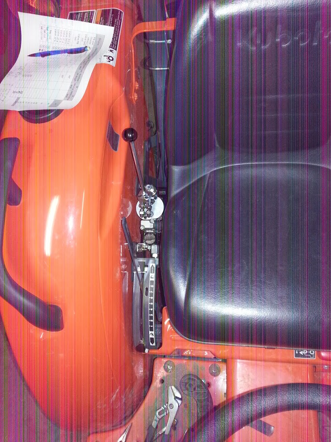

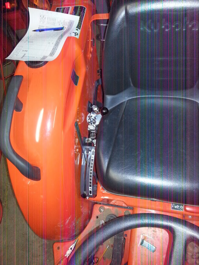

/ Kubota L3200 TnT & 3rd function install (work in progress) #46

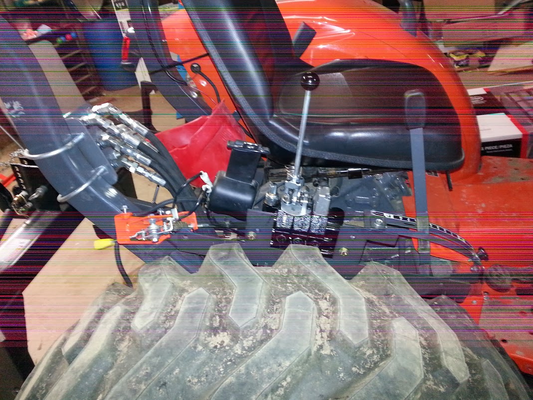

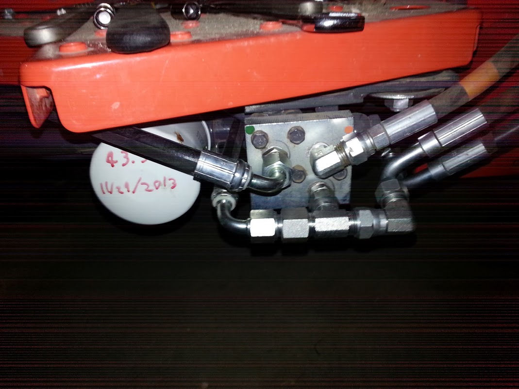

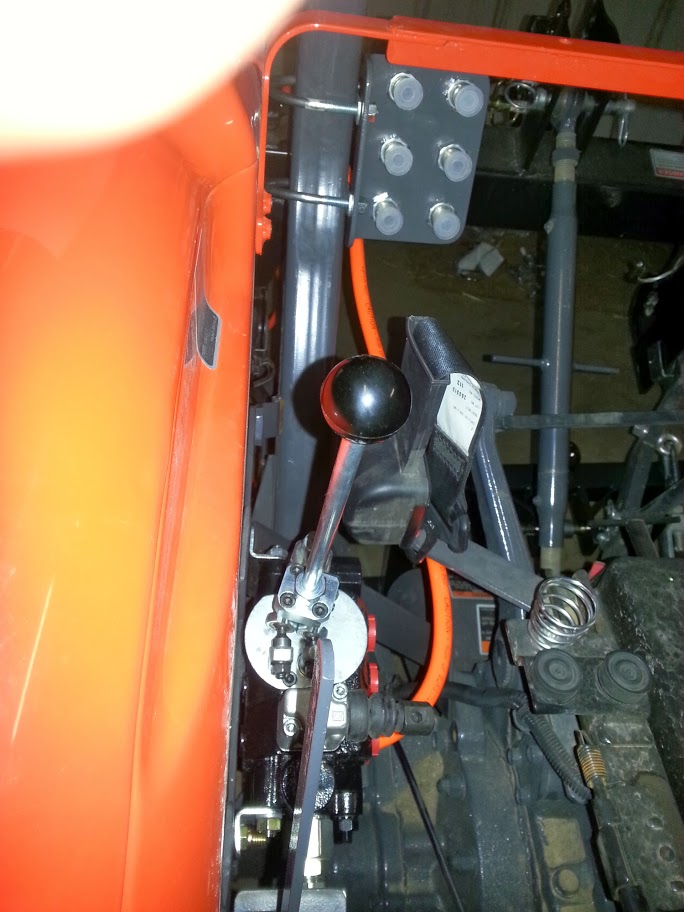

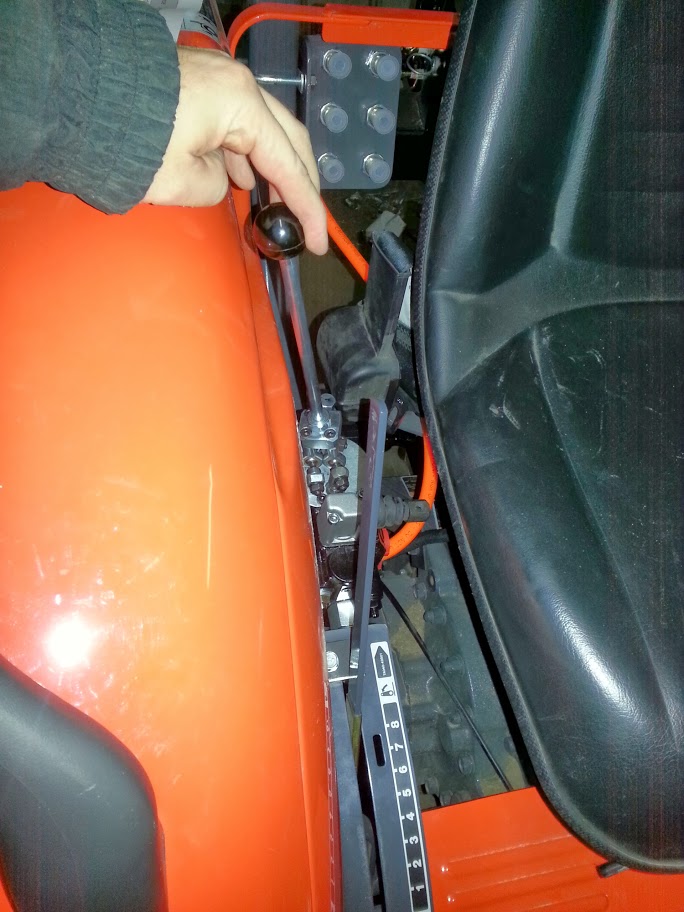

Got the valve mounted & fender somewhat back in place.
It looks like tucking the manifold just under the crossbar will give me enough clearance for everything & straight fittings on the back. I left a 7/16" (i think) wrench hanging out of the bottom QD to help judge distance & level. 3pt hitch was all the way up (propped it up manually, might not go quite that high on it's own) and have the top link relatively close to as short as it can go. Guessing at the port locations a bit on my measurements at the moment. I'll have to re-think my port order a bit, 90's on the bottom QD would be good for the top or tilt, was going to use that one as the 3rd function to limit possible rubbing on my quick hitch. Probably going to sleep on it or maybe wait for my cylinders. At the very least I need to re-measure after firing the tractor back up & running the 3pt to it's limits.
View attachment 345317 View attachment 345318 View attachment 345319

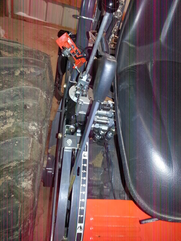

Debating what route to go coming out of the valve. It looks like I have enough clearance to come straight out of the valve and go over or under the seatbelt bracket. I took some measurements from the end of the red plug covers, but am not sure what length of fittings I may need to factor in. I like the staggered 90 degree fittings on Number9l's install coming out of the valve body, but not sure that would buy me mutch. Leaving a big curve coming out of the valve body would give me a bit of wiggle room if the hose is an inch or 2 to long whereas a pretty straight shot from a 90 degree fitting straight into the back of the manifold. Definitely going to sleep on it.
View attachment 345320 View attachment 345321 View attachment 345322
Photos of the joystick in detent both directions, centered & pushed up to the fender with an inch or an inch and a half to spare. My phone apparently had some issues on a couple of these, the battery was dying.
View attachment 345324 View attachment 345325 View attachment 345326 View attachment 345323

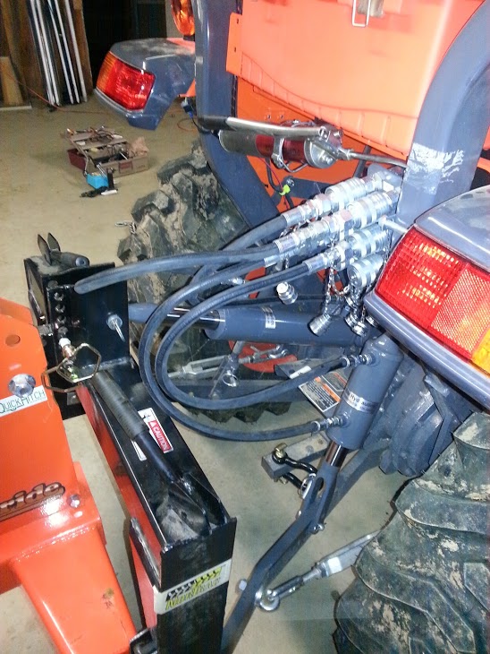

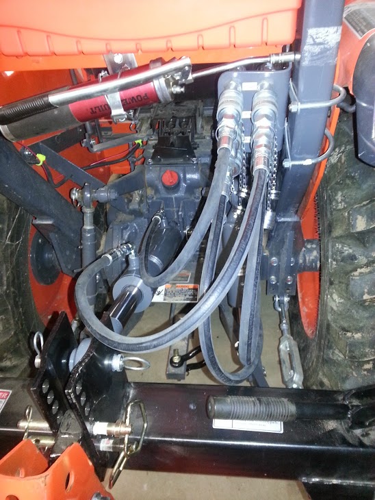

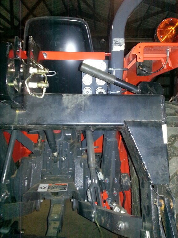

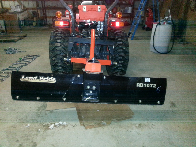

Cleared some snow this afternoon... Really liking the function of the TnT still. Took some photos of where things sit now & left the blade on & up (33" to top of blade on each side). Will re-measure it next time I'm out there & see if either cylinder seems to be dropping.
Currently there is only 1 U bolt holding the manifold on & it's a bit loose, which helps on the clearances a bit. The 45's on the back mean I can't push the bracket towards the front of the tractor any more. The way I have cylinder fittings finally rotated now I only get binding issues all the way up when retracting the top cylinder. At least 1 hose gets a bit tight when the 3pt is all the way down too. Pretty usable unless I bottom out the hitch or raise it with the top cylinder in.
I have a small stash of assorted fittings coming to fiddle with & see what room I can free up, whenever it warms up a bit. Some kind of rounded guard over the bracket attaching to the top cylinder might help keep that hose from hanging up there too.

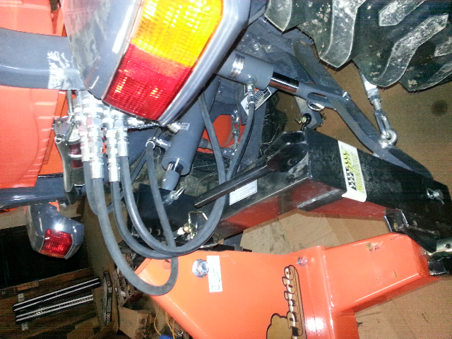

After plowing some snow, I really saw the benefit of float on the tilt & am glad I got it. I also saw the value of hydraulic angling, which I didn't have, so I ordered one. That came in & I was finally prompted to do up the 3rd function handle I'd been slacking on.
Yes, it's bent like that intentionally, it was a bit of a pain to clamp it to weld up not being at a 90. The angle turned out the be a bit more than I needed to get the clearance over the top of the valve, but caused no problems.
It ends up getting as close to the seat as the joystick does locked in float, which doesn't cause any issues.
Of course after assembling the angle kit lastnight I found out Land Pride doesn't include QD's (not super suprising), so I need to head to the store on my way home tonight.
I also fiddled with the hoses a bit a few weeks ago. No additional fittings, but things seem to be working good enough. I still keep an eye on things when lifting the 3pt & nothing is binding. More flex on the hose than I'd like, but at this point I'm going to leave it as is & worry about it if something breaks.
I was rather disappointed to realize I'll need to get of my tractor to hook up the blade now with the angle hoses. I've gotten use to being able to hook up to everything without getting off thanks to the quick hitch & TNT kit. It is so convenient, no matter how crooked I drop an implement, I'm loving it.

Finally got around to ordering the new hoses & got ten installed. Things look pretty darn good.
Ended up moving the restrictor to the rod end hose for clearance issues. It made it quieter & faster. A good thing I think, i noticed it was a hair slow & really squealed compared to the side link before the swap.
I'll probably fab up some anti-chafing guard on the toplink bracket as a hose will touch there, although with no pressure. I can move it off with my finger & it will stop touching & stay there.
Hose - angle on the cyl end - length - angle on the QD end
Top cyl (L) - 0° 24" - 90° short
Top rod (R) - 0° 28" - 90° long
Tilt cyl (R) - 45° 20" - 90°
Tilt rod (L) - 45° 24"- 45°
I'd recommend getting the 90s for the top as shorts & getting the extra clearance from the restrictor, but this appears to be fine as well.
I do wish I'd sprung for flat face connectors. Dam age connectors leak too much after you disconnect them. Even after wiping them out with a towel I will got a good bit of oil seeping out & ending on the floor. Not that they leak, but you end up with a thimble full of oil inside when you disconnect.
