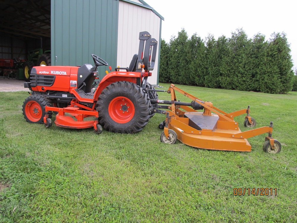

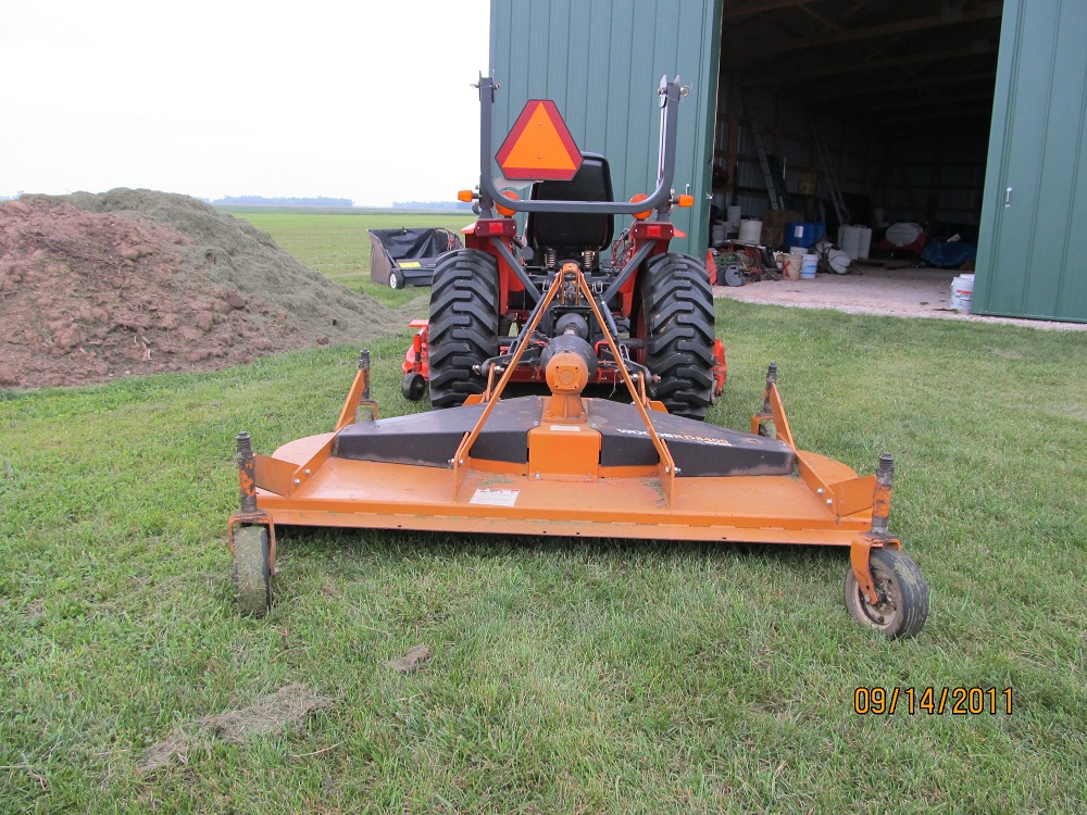

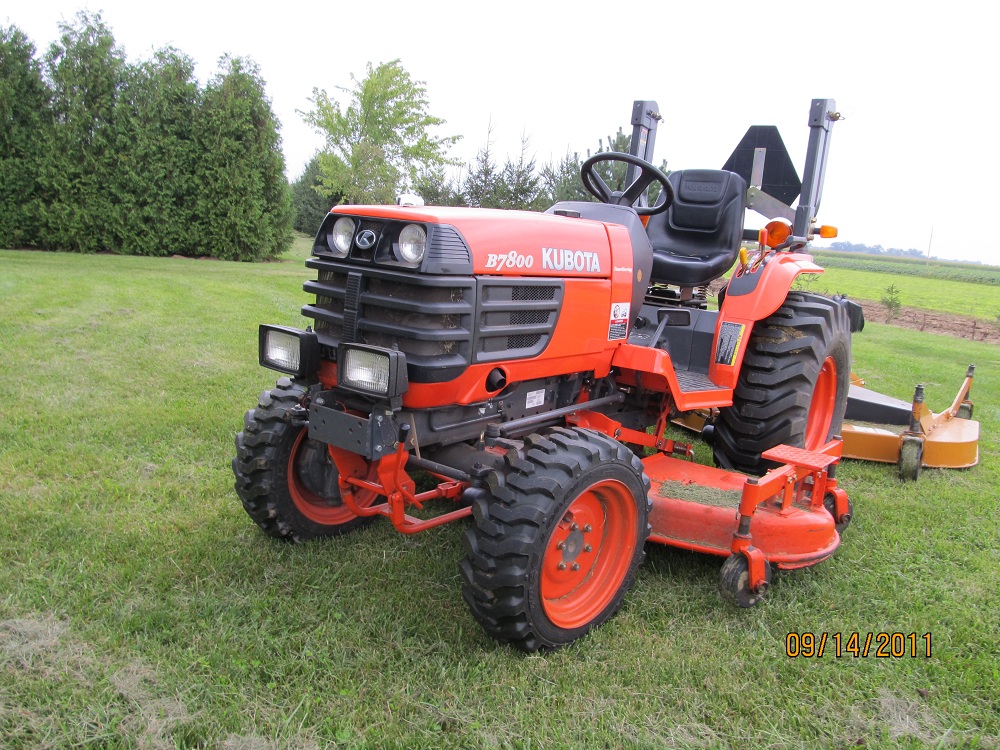

It might be too much for thick wet grass but if you take it easy you will be fine. Don't mow too low and keep your RPM's up with no lugging. I have the same mower and use a B7800 with it every now and then and it works with no problem if I mow the lawn at 3 or 3 1/2 inches. If I mow at 2 1/2 it's a struggle and the temp gauge does rise but stays in the middle. Here are some photos.
