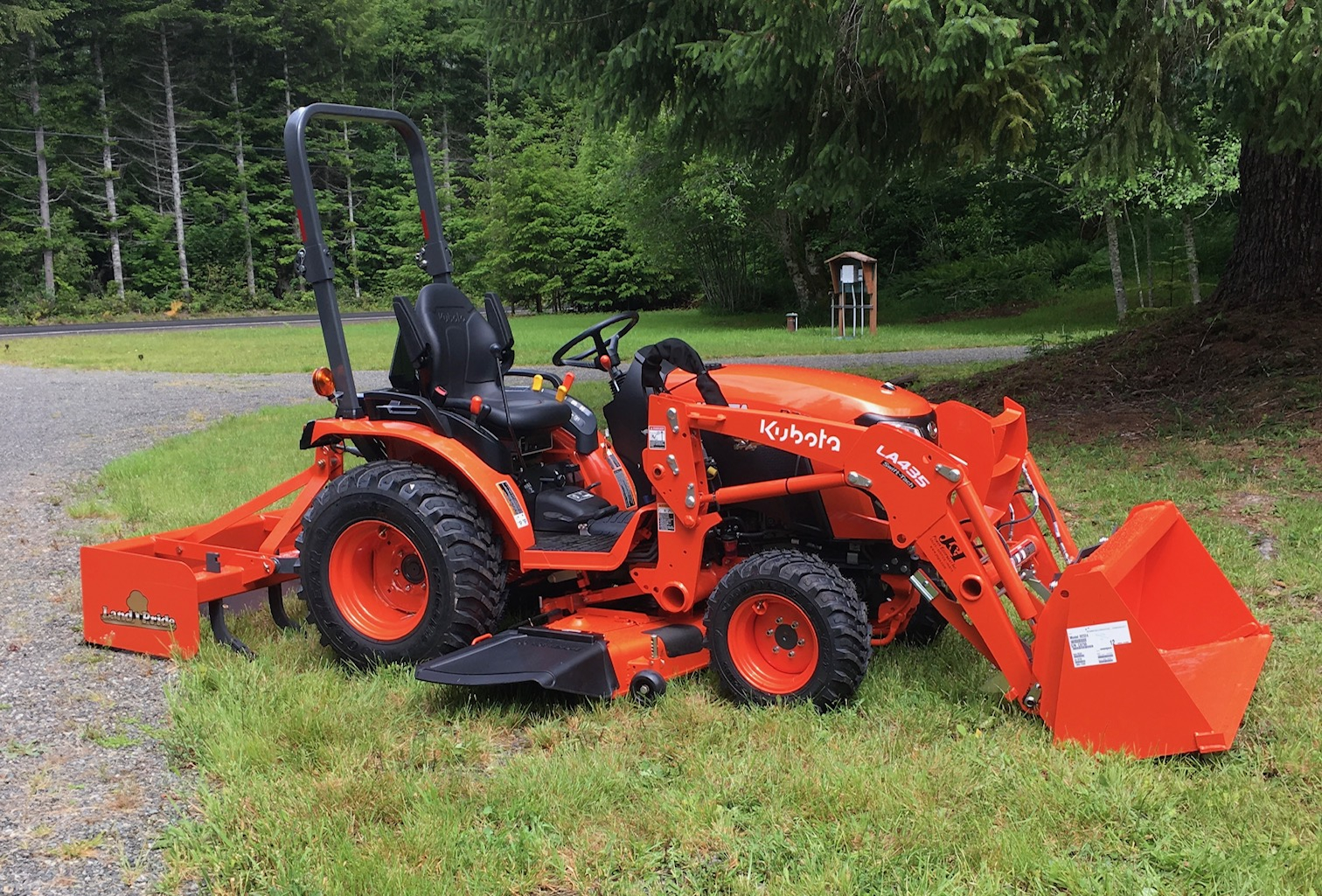

So if you you get about a 20 hp bump in pto hp which more than doubles it from Kubota I assume you can easily run stationary attachments like a bigger pto generator, wood chipper etc?
You can't make more HP without making more heat. That heat has to be expelled through the cooling system. The same cooling system that was designed for less HP. Will that radiator be enough when performing a demanding power pull for long periods? What if your radiator is half plugged with chaff and grass? It is just something to think of when doing this mod.
Yes. That is correct. You can run larger stationary attachments.
Running a 15kw generator was one of the reasons for this modification.

My L2501 operators manual has an implements limitation section stating a max cutting width for a rotary cutter of 60" and a box blade width of 52". Does anyone know what widths are spec'd by Kubota for the L3901?
Yep, you can definitely run the larger spec implements with the Turbo Kit. The box blade width restriction/recommendation is due to the width of the tractor. But, a larger box blade can be used.
Absolutely. However, the factory D1703 cooling system has been more than adequate to deal with the increased heat from the Turbo kit. The tractor has been ran for over 8 hours straight grading without a single hiccup in challenging conditions.
