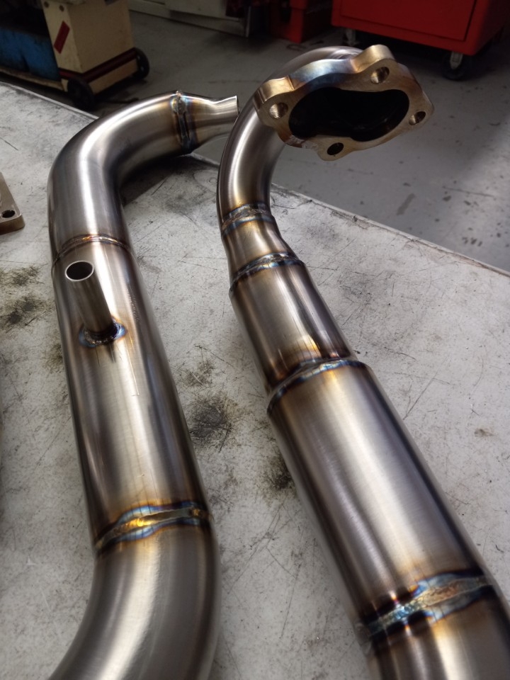

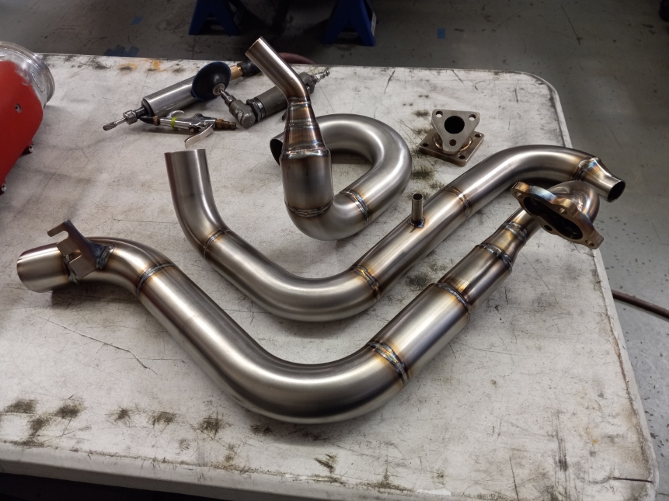

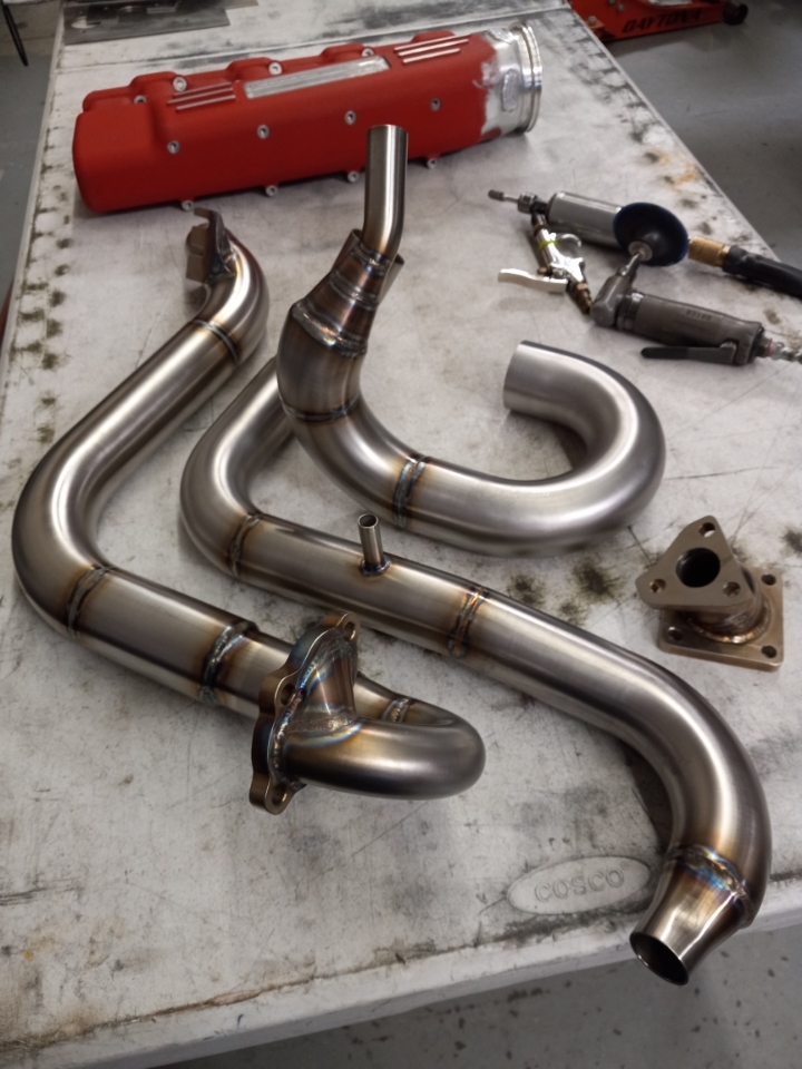

Here’s a few pics of the Turbo pipes along with….the new downpipe;
The new downpipe increases velocity albeit flows the same as the original pipe but, offers better clearance and easier installation.

Seems to me like you have way more money in your modifications than a larger unit would cist anyway. Being an AWS certified TIG welder, I commend you on your welding skills. My only positive comment other than what tubing bender you have? A Baliegh maybe?

Don't matter to me at all as my 2 units are twice as large anyway. I do like following along but IMO, your modification exceeds the realm of what most tractor owners can undertake. Like I said, nice welds. How much sugaring did you experience or did you pre-purge with argon prior to?

I'm starting to come to the realization that you are having the custom fabrication done by someone else, not you because I ask simple questions about weld methodology and you never answer. Hope you are paying whomever an equitable amount because I charge at least 120 bucks an hour for TIG welding and metal fab.

We don’t have a tubing bender. Never have. We buy pre-fabricated tubes and u-bends and cut to fit.
All tubing is back purged 100%…we utilize continuous purging when welding our tubing together as that keeps the gas on the inside of the tubing continuously clean and avoids any potential contamination of the welds penetration during the final weld process.
And no, I’m not the welder/fabricator. However, I have shared your compliments and feedback.
