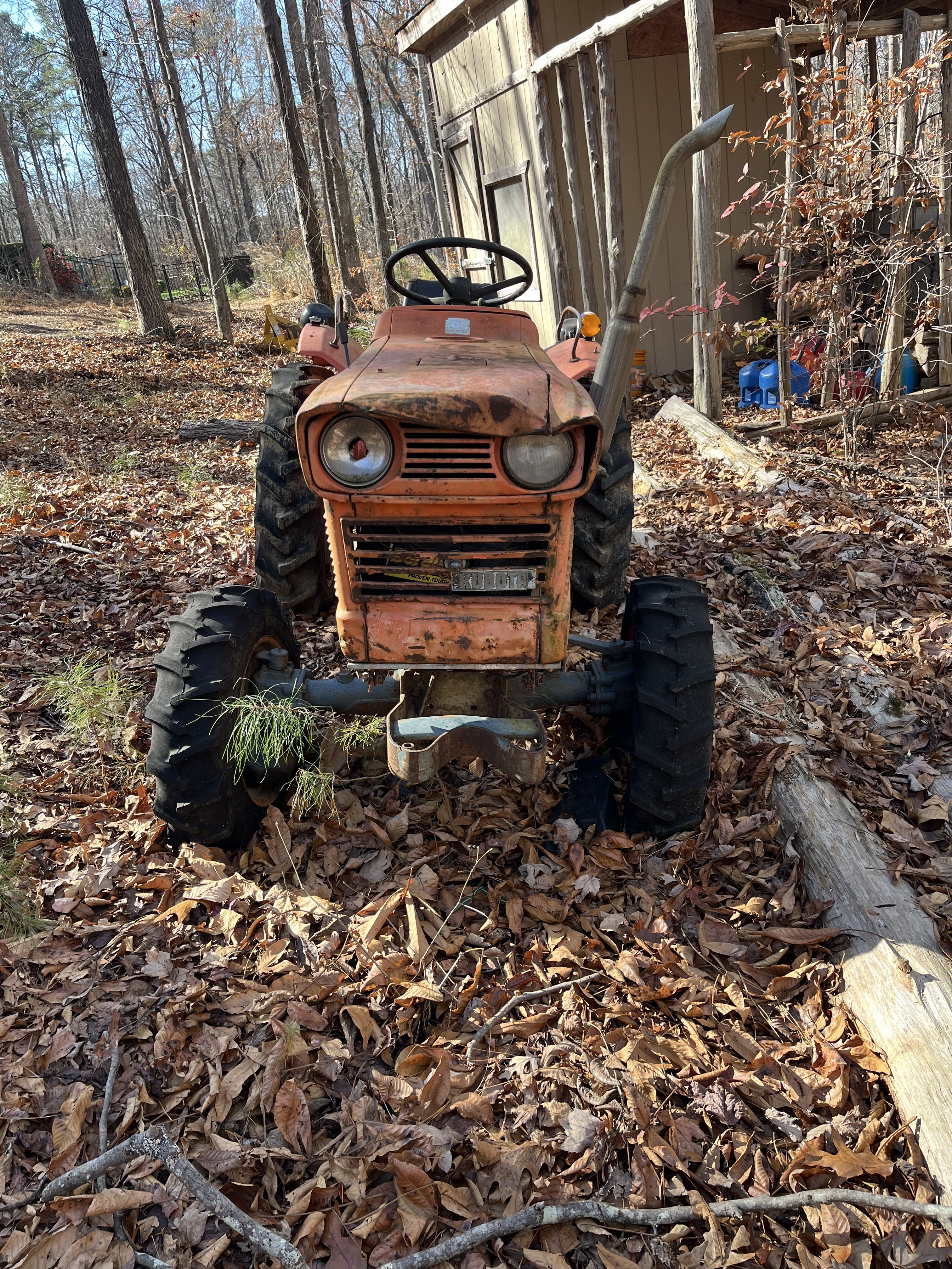

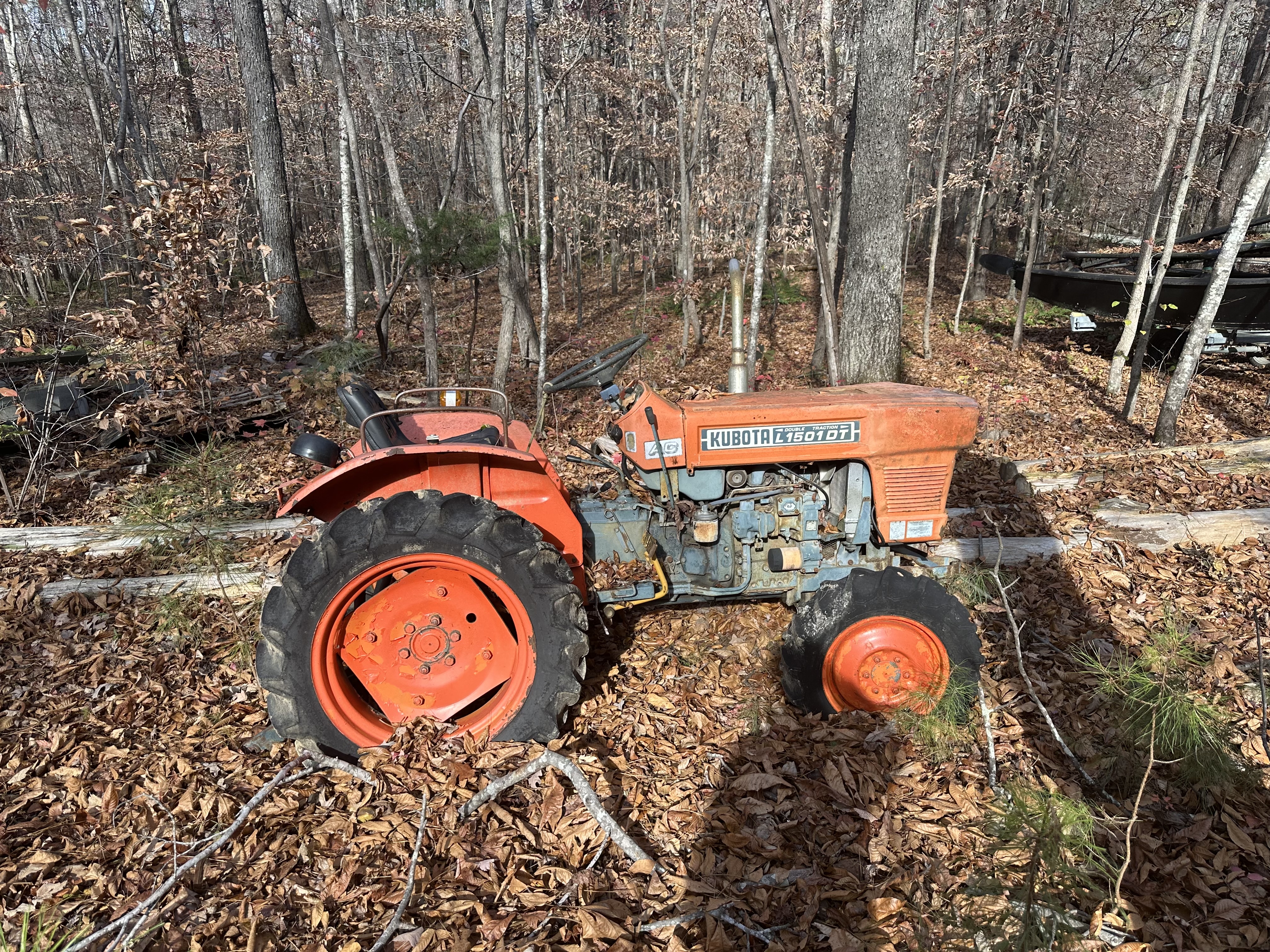

I’m about to buy this tractor and four implements. Going to make sure it isn’t locked up. A suspicious rope tied to the steering wheel as if it was pulled to its resting place. What’s everyone thoughts on this? Anything I should look for? I may hook it to the truck battery.
I love the Japanese quality machines.
I’m paying 2400 for the tractor implements and a shed full of tools, blower and weed eater and mower. Lots of other goodies.

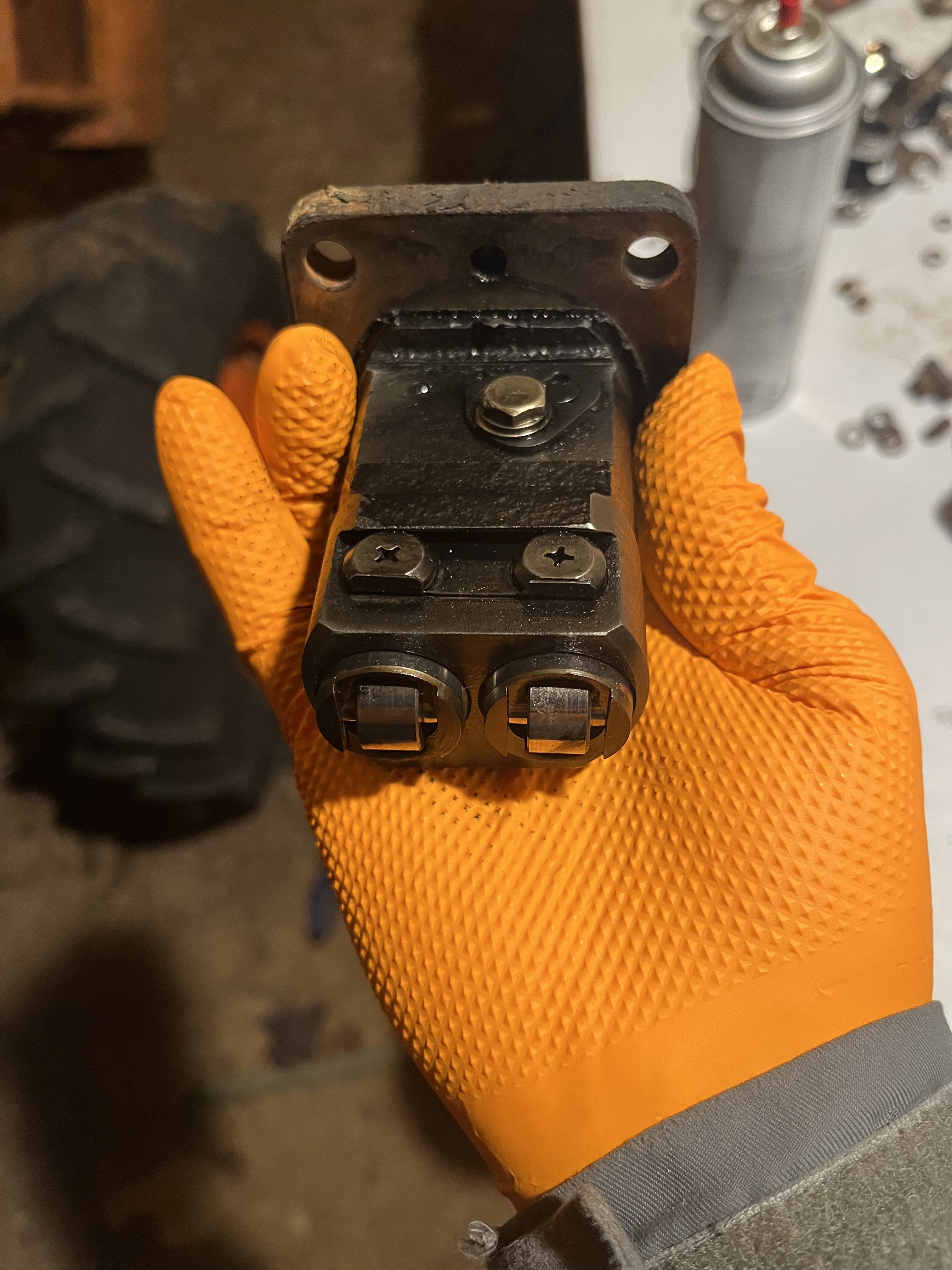

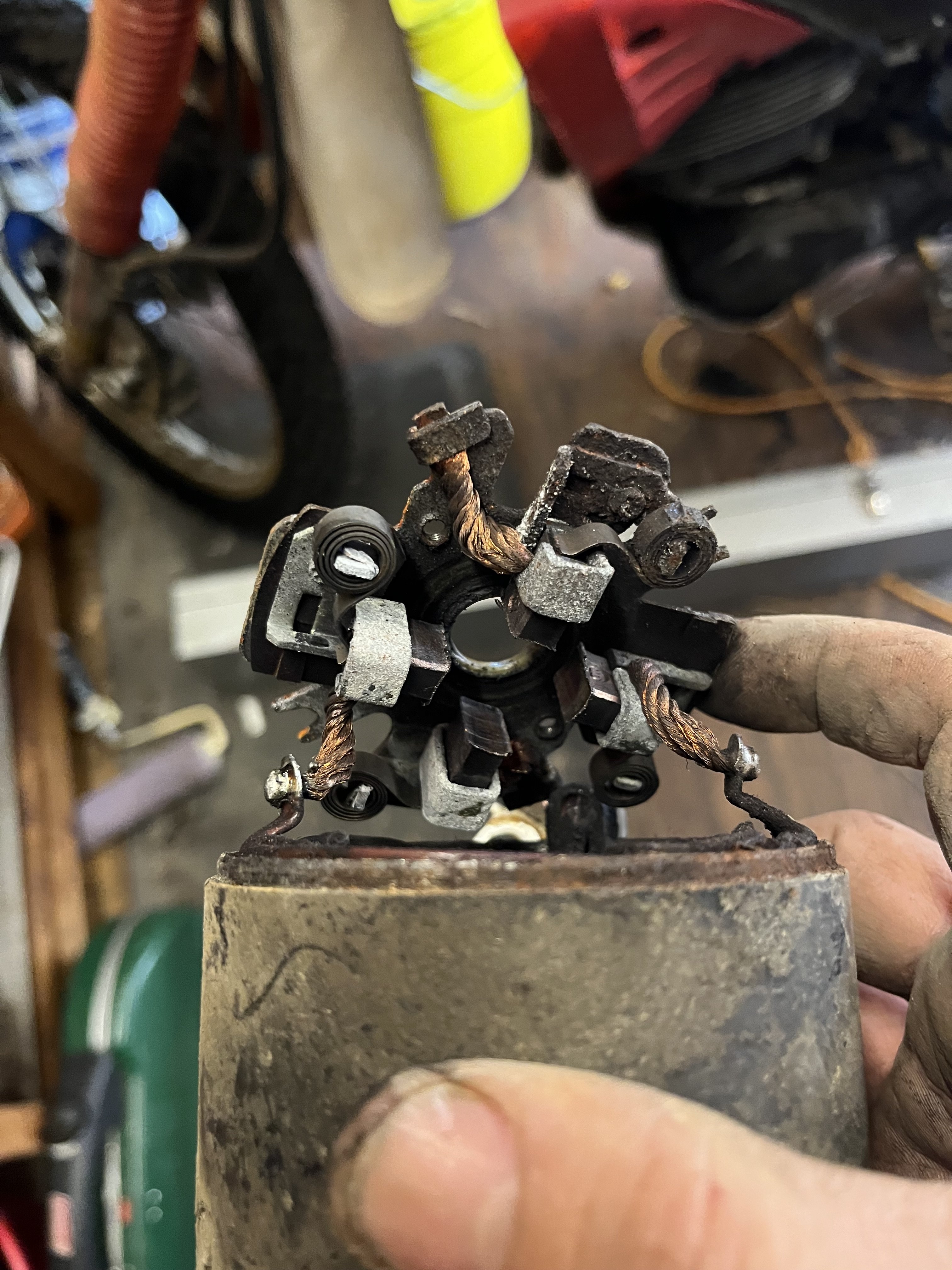

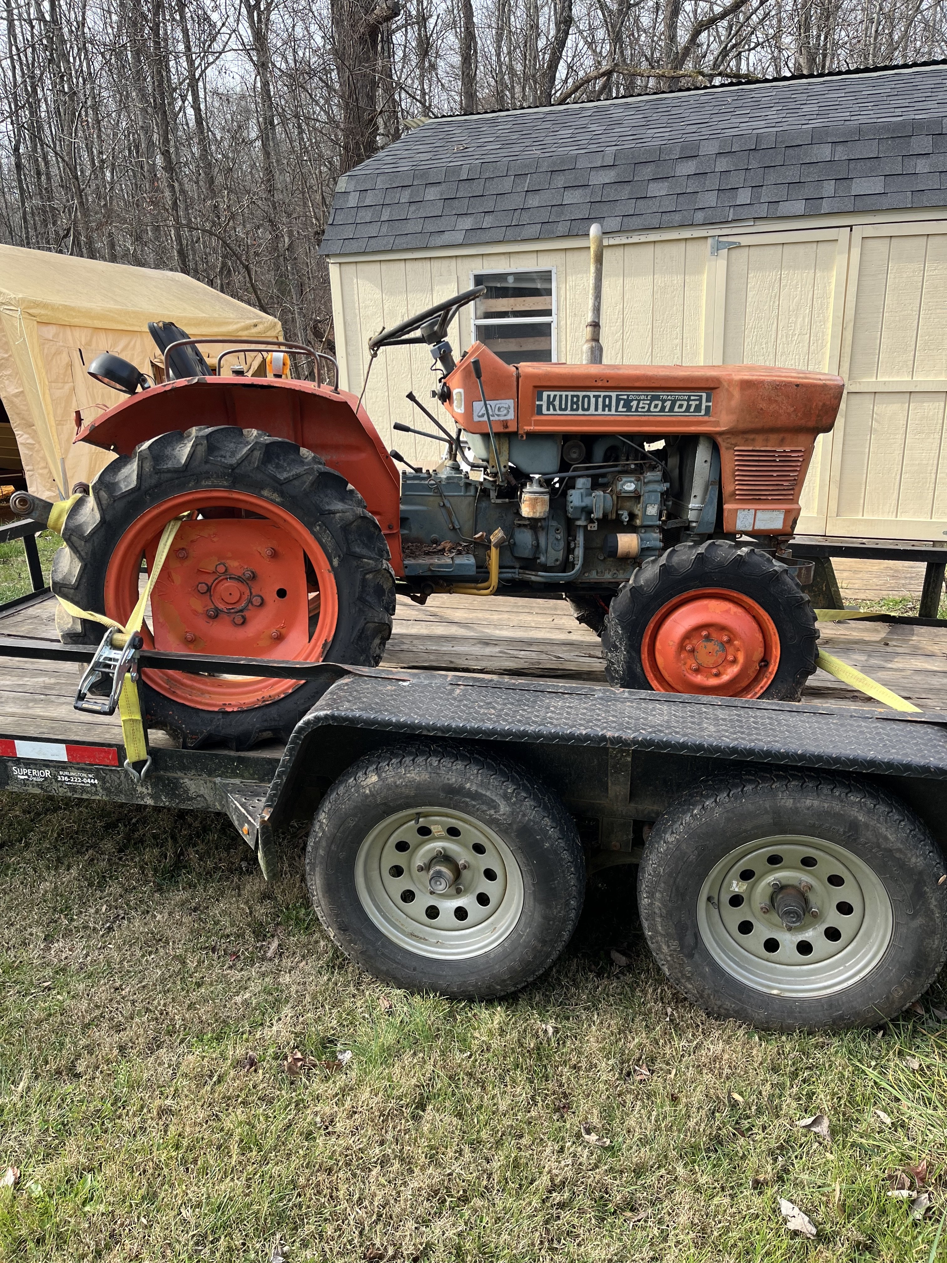

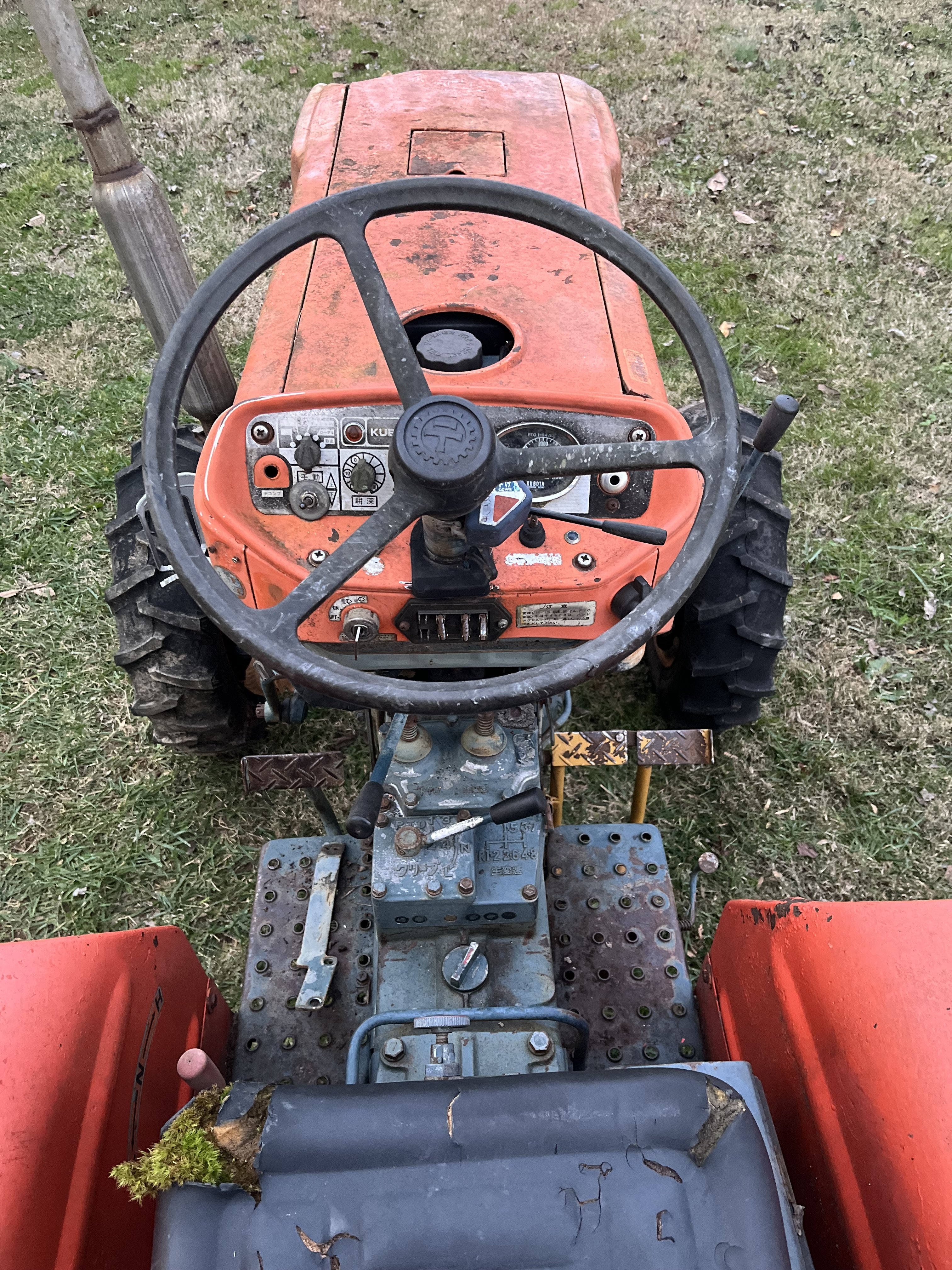

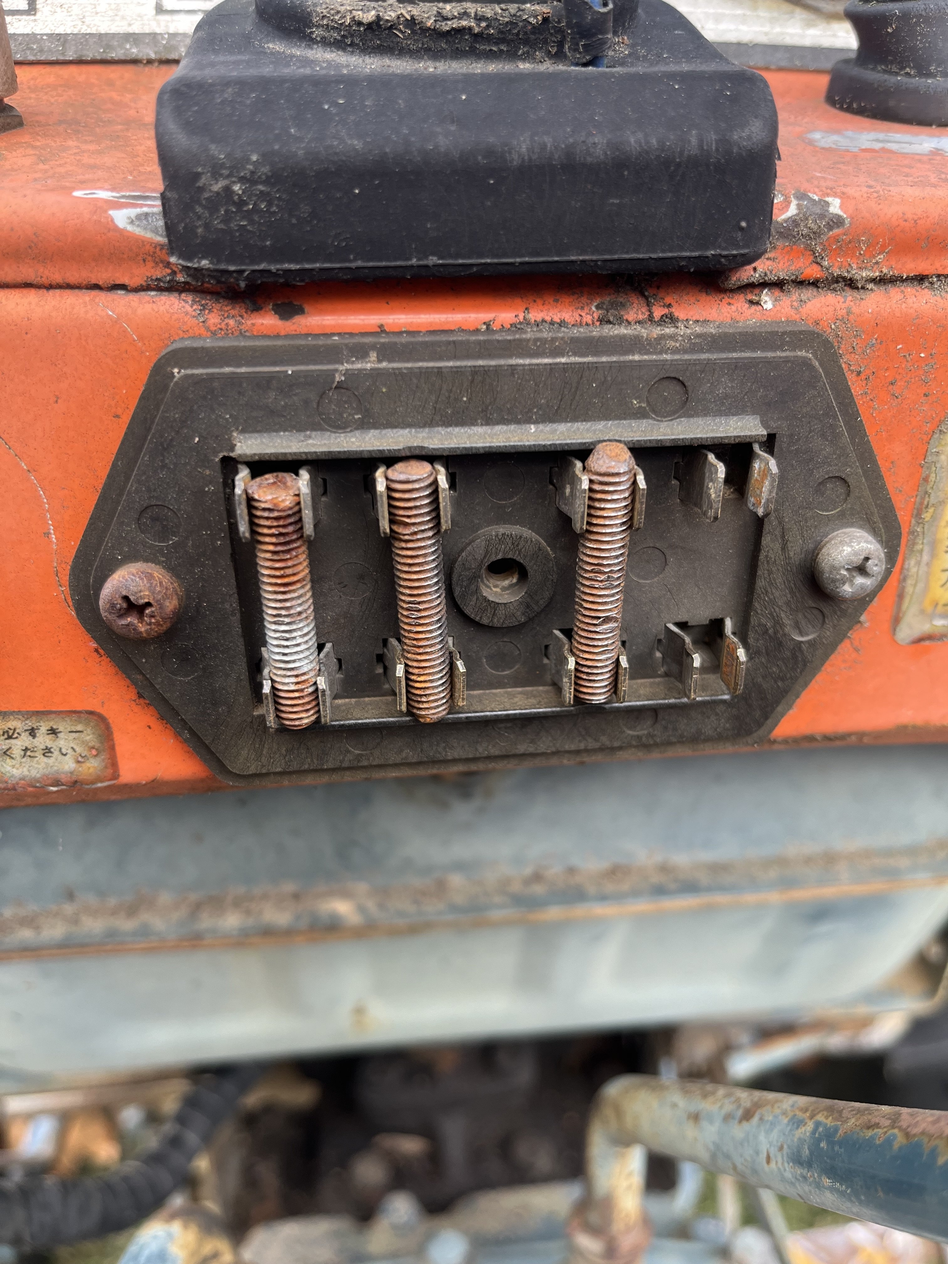

Got the tractor home. Engine turns by hand. Everything seems in okay shape. I can tell that I need to go though and clean up the grounds. For some reason there’s 1/4-20 threaded rod in place of the fuses.
Trying to pop the starter and realized the solenoid and starter already have power with the key on. I bet that was the cause of parking the tractor. I’ll dive into that more tomorrow and check the start switch.

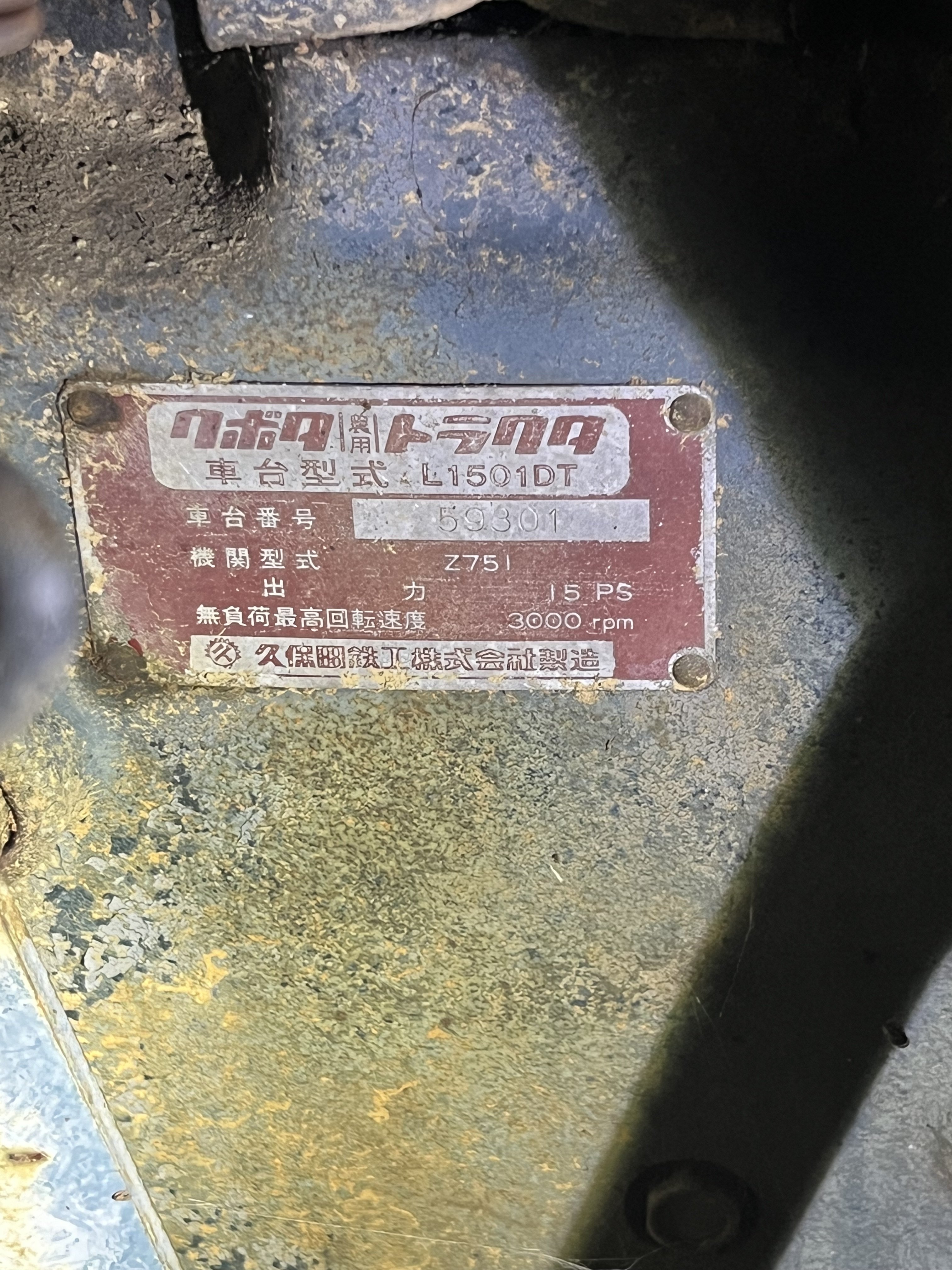

Pulled the starter and solenoid apart and cleaned contacts and got both operating normally. Thank goodness for the iPhone being able to translate Japanese from a picture.

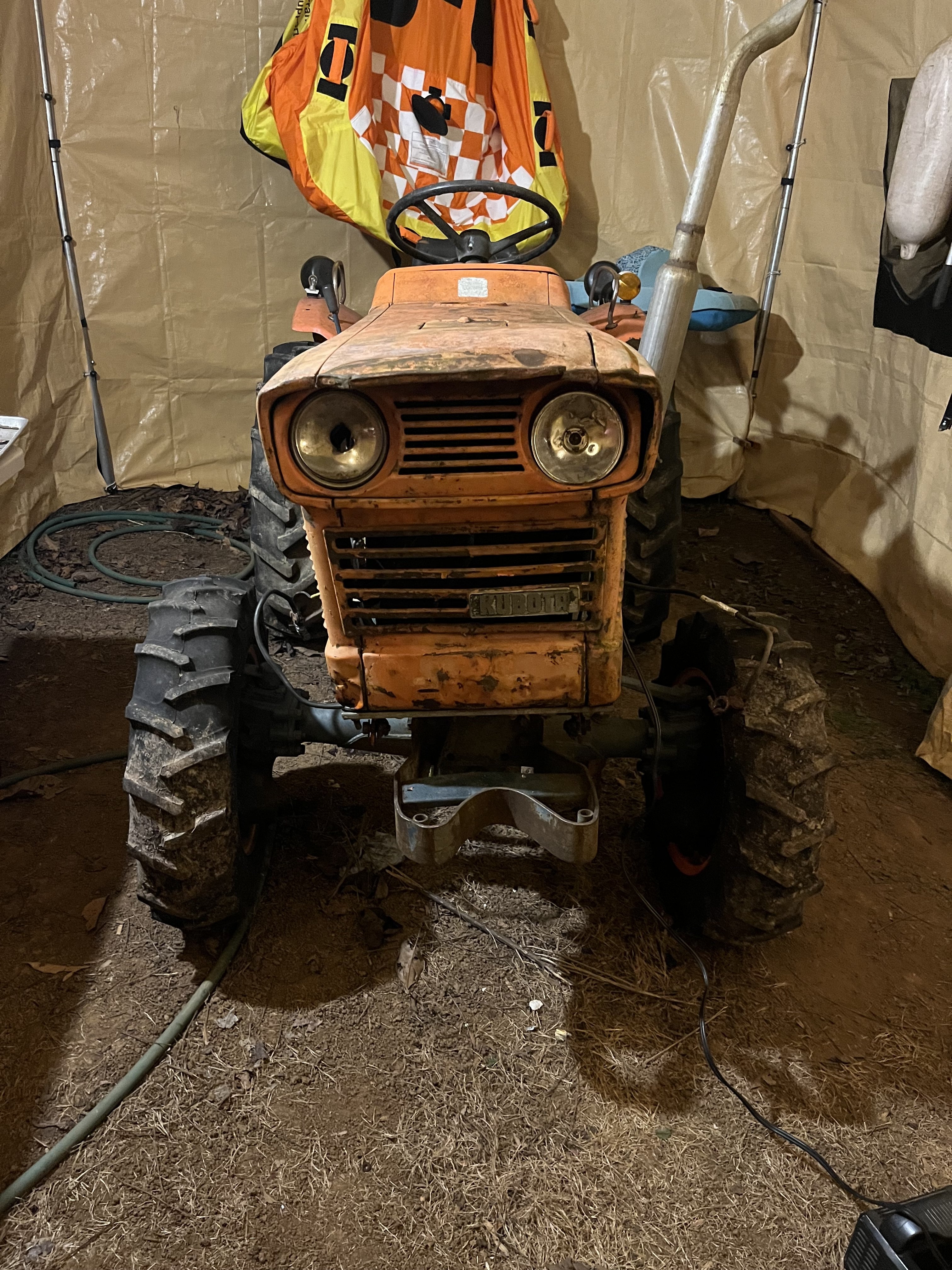

Got the tractor running. I already love this little machine. Lots of power for its size. 4wd is strong.
I pulled the injectors and injection pump cleaned all the gunk off. Removed and cleaned manifolds. Bled fuel system and got fuel back to the cylinders and she fired right up.

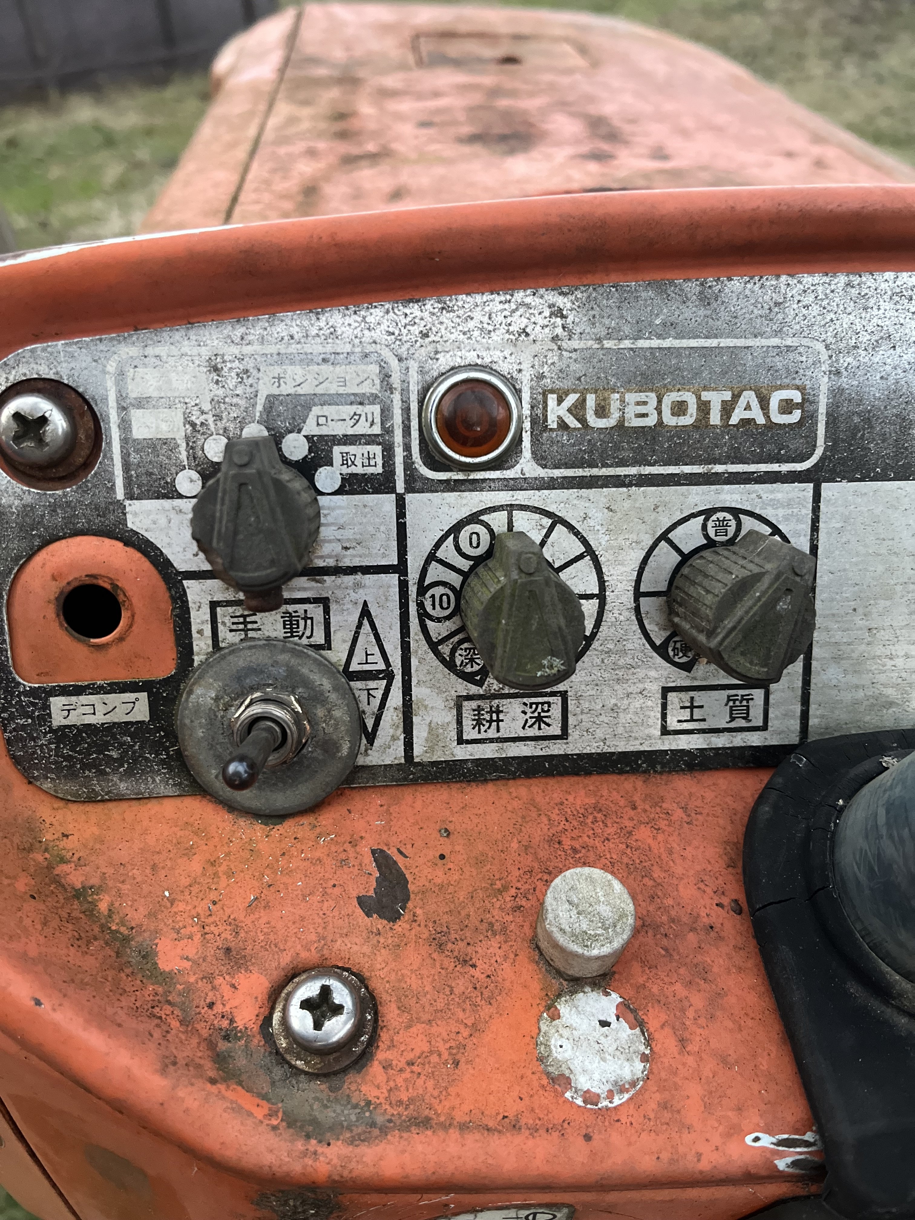

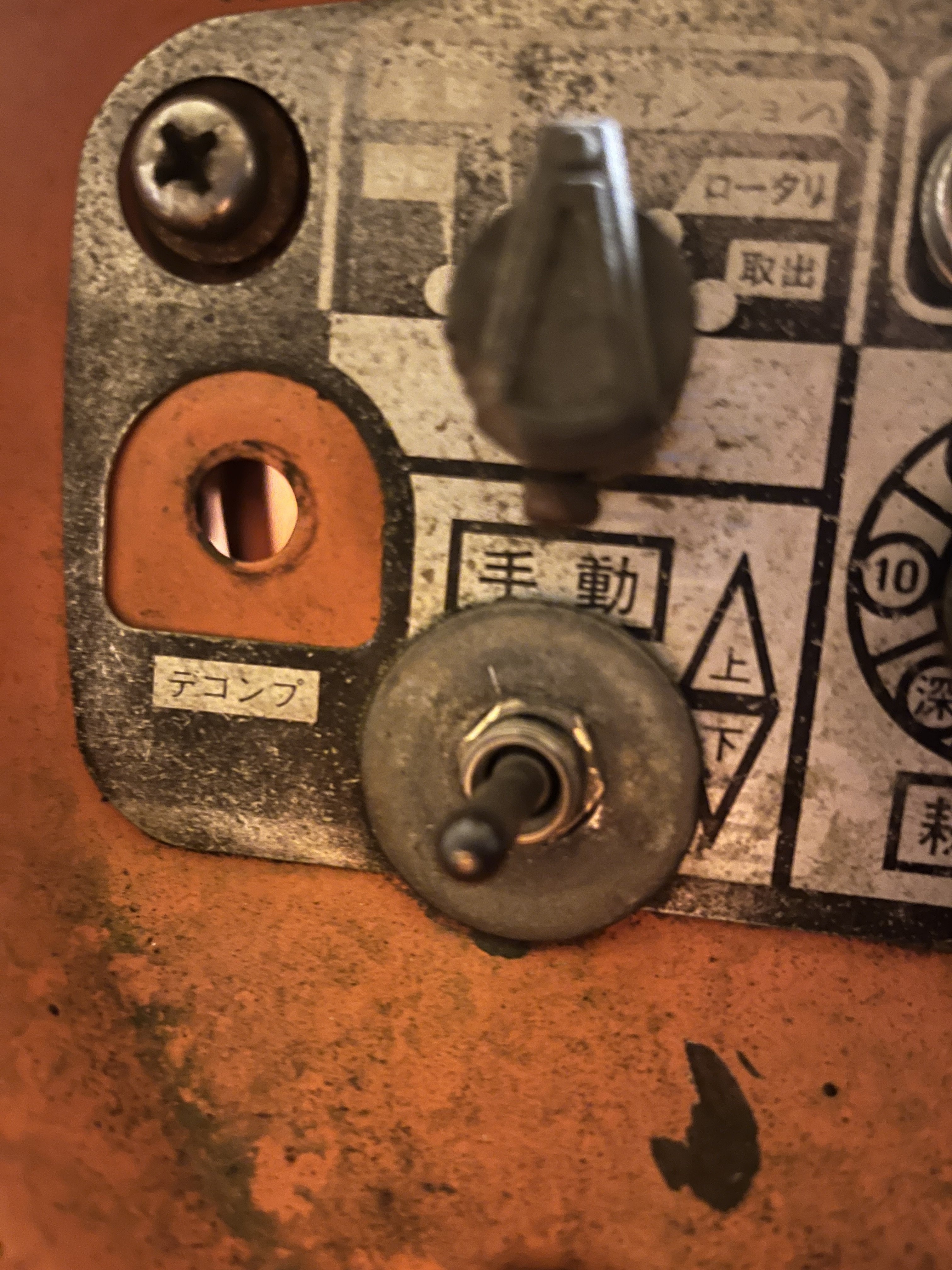

The three point is operated by a dial and toggle switch on the panel. Not sure if the other dials are for downward 3pt pressure or what. Maybe has to do with pto speeds. Also has 4 speed pto.
Straightened out the hood a bit. Still needs more work. New headlights on the way.
