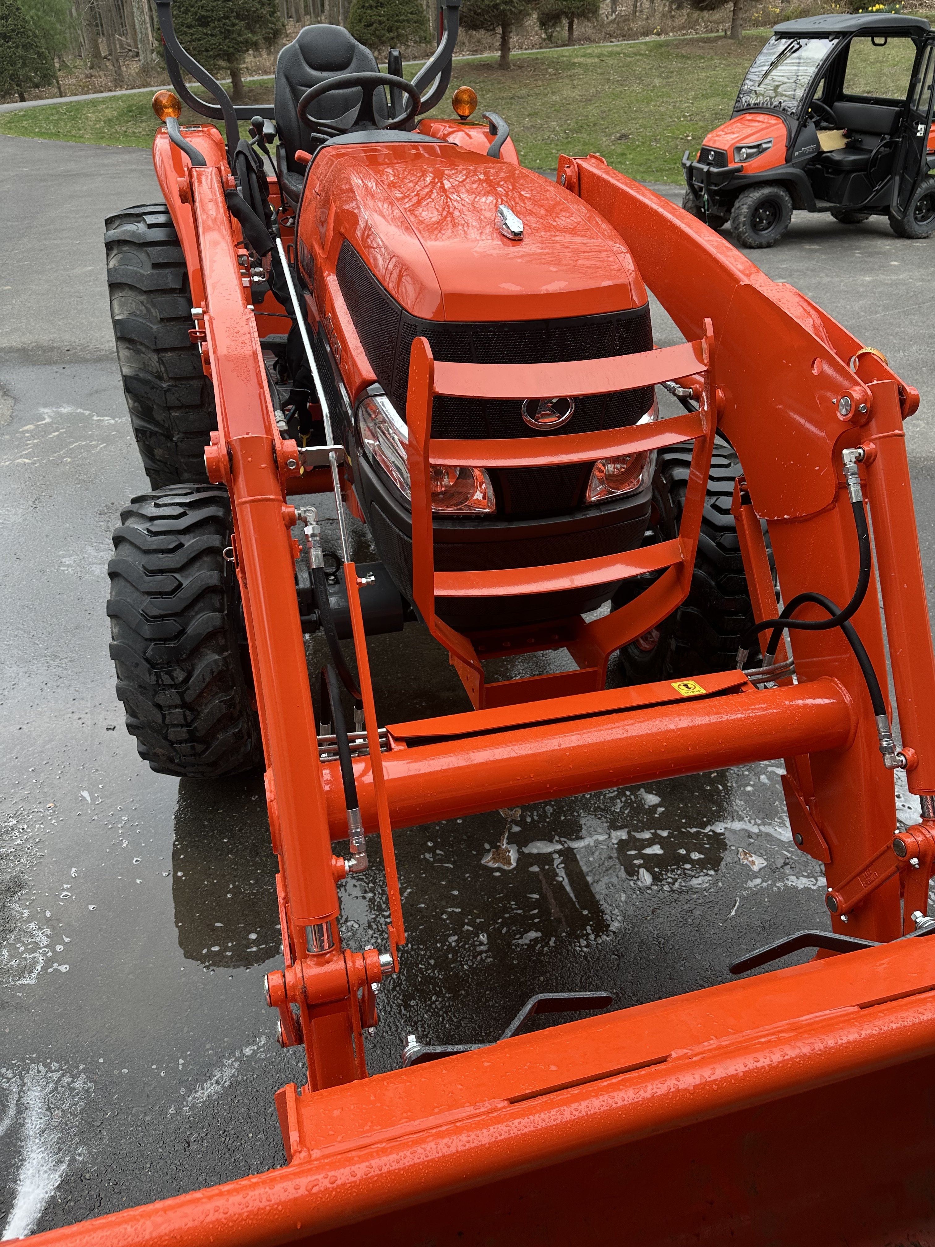

Tractor Returned today. Everything looks great. Hoses are on the inside of loader arm.

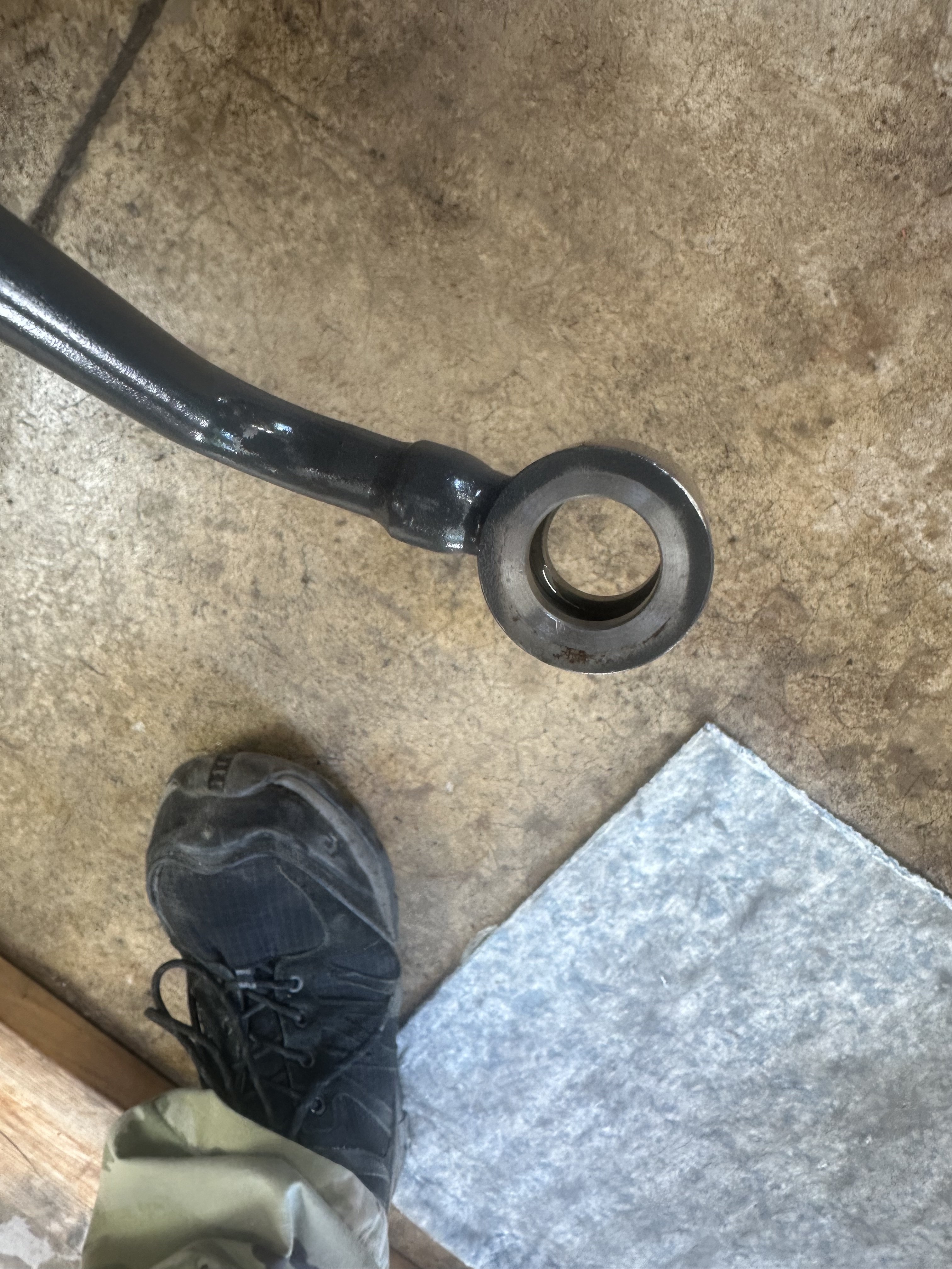

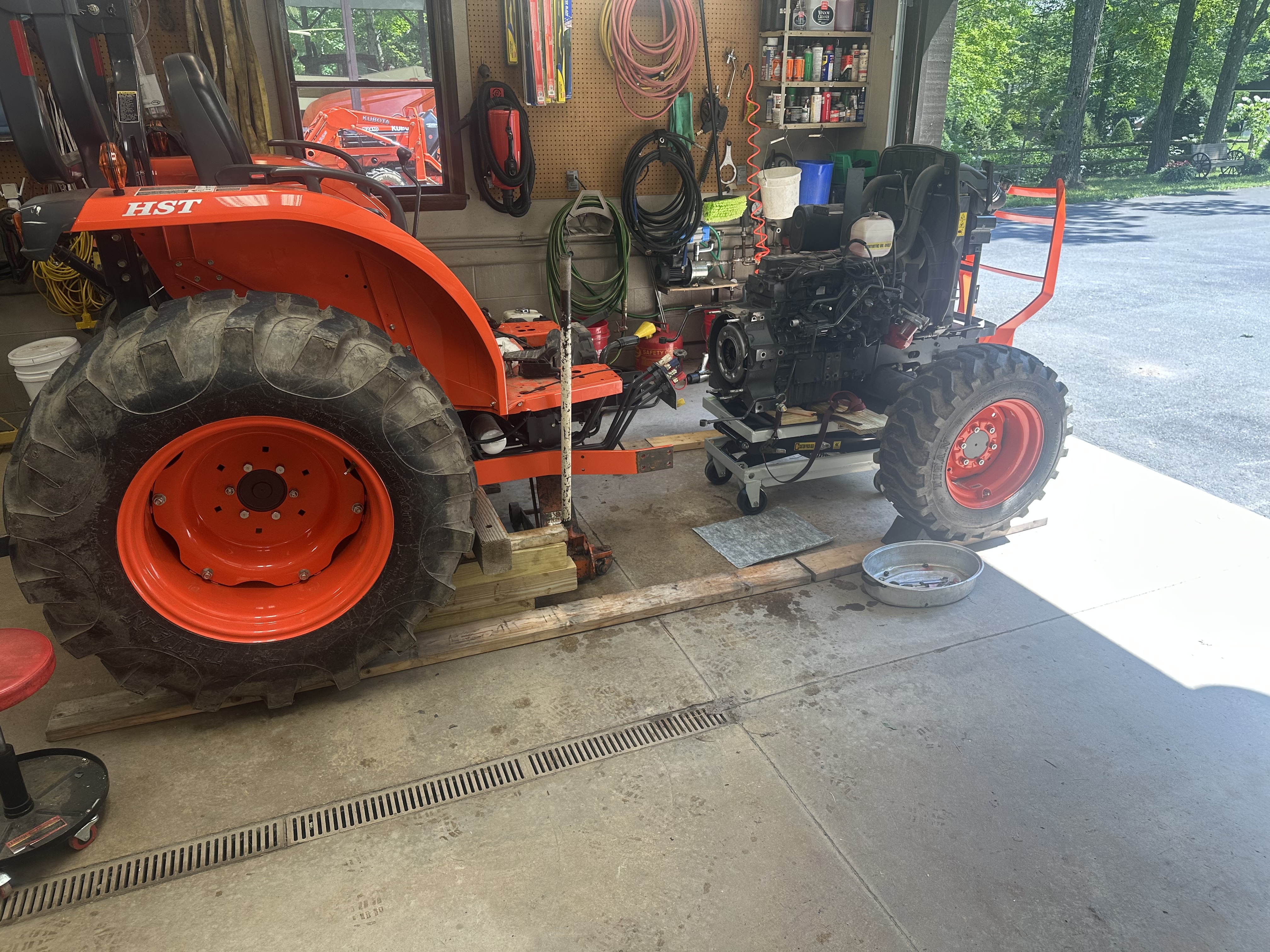

Also have pictures when changing propeller shaft seal. Not sure how they got in here.

thanks for the update, nice to know there appears to be a new replacement LA1065 loader for the old generation LA0854 that seems to fit without any mods
   / Kubota L series with a LA1065 Loader #16
It's my understanding that the old number was just a measurement from a different location (tip of the bucket?) and the new number, 1065, is measured from the pins. Same loader strength.
It was just like the "standard" models, old loaders were LA463 and the same loader was then called LA525 (new number was measured from the pins instead of the old location).
It was marketing to make the loaders sound like they can lift more but reality they were the same capacity.
