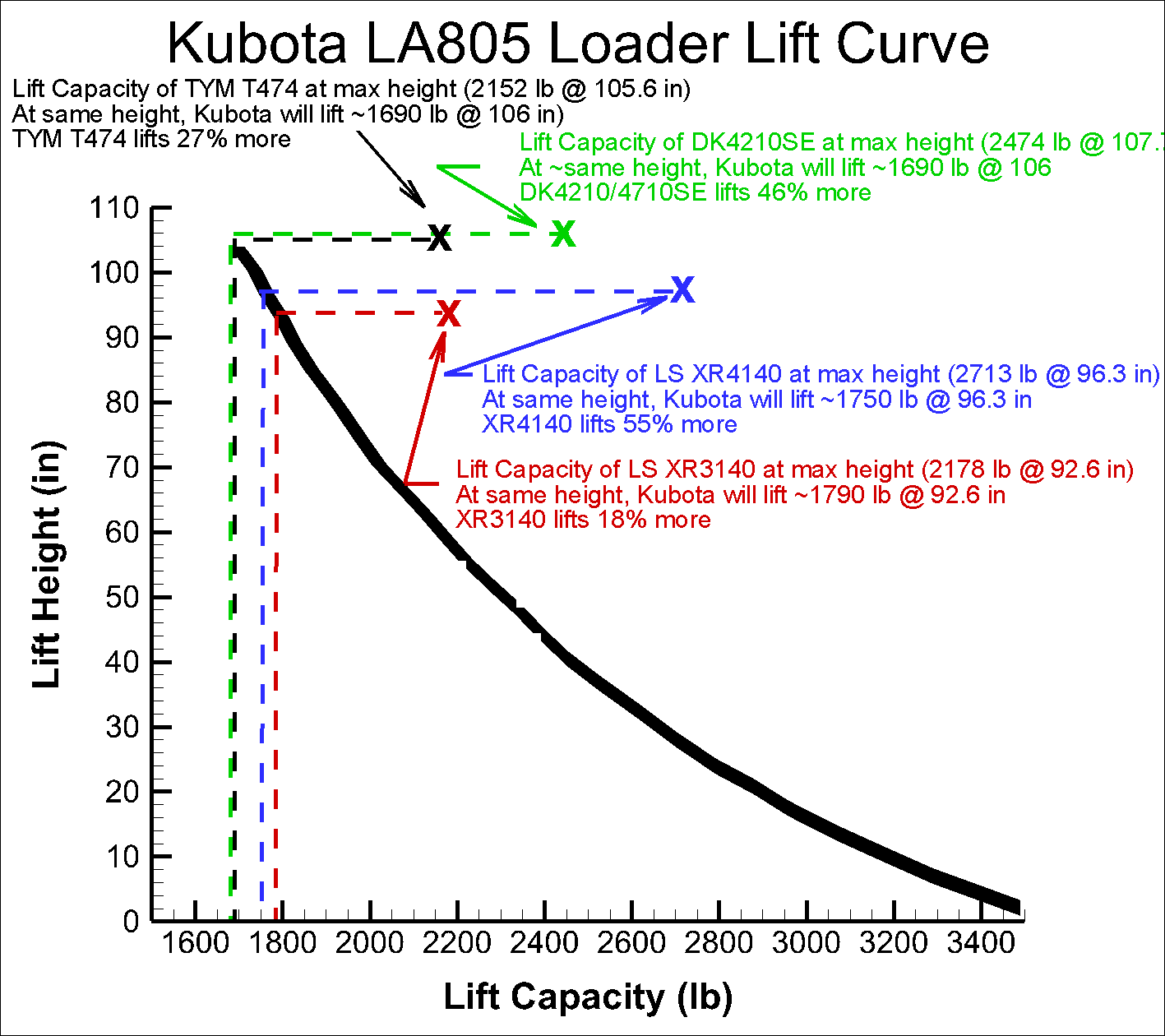

I have not been at all disappointed in my Kiota CK3510SE. Frame size of it is comparable to the 3000 series of John Deere tractors. The loader weight lift & lift height on the Kioti CK10 series were much higher than comparable John Deeres.
I think Kubota's numbers are more honest. Sure, kioti/LS/Mahindra LOADERS may handle x lbs, but will the rest of the machine? Will the back tires stay on the ground with that load? Kubota also has higher lift heights than most of the others, which plays into that max weight at max height. This comes from an LS owner.
With the proper rear ballast, a user can take full advantage of the max loader specs.
