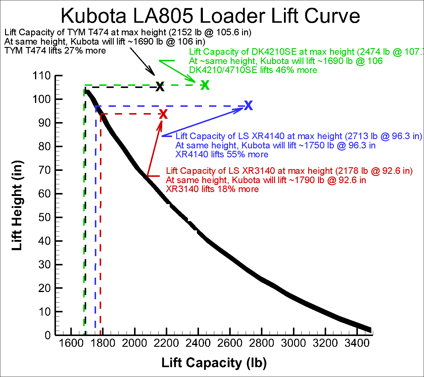

I posted this comparison a little while ago (and was met with a torrent of derision). But, being an engineer, I tend to rely on hard numbers, as opposed to gut feeling and how things feel.
The plot below shows loader lift comparisons at the loader pin between a Kubota LA805 loader (spec'd out on a L3560) versus comparable loaders from other brands in similar sized tractors. While I don't have the full loader curves for all brands (kudos to Kubota for supplying it to their customers) you can compare the lift capacities of the Kubota at the same lift height with the other brands. If you're comparing Kioti to Kubota, a DK10SE series is very similar in frame size to a Kubota L3560. If you look at the green "x", you'll see the Kioti lifts about 46% more than the Kubota. That's an apples-to-apples comparison, and numbers don't lie.
Now, to get past the marketing hype, I think you have to ask yourself, "does it really matter"? For me, loader lift capacity was a major priority. I doubt that's the case for most people. As has been mentioned here already, high loader lift capacity does nothing for you if you can't keep the rear tires on the ground. This often requires additional ballasting, which may bring additional consequences (rutting in yards, the mess of filling tires and fixing flats, stress on axles, etc.). Only you can decide if that's important to you or not. As is oft-repeated here, I would make a decision based on what you need the tractor to do, not what it necessarily can do. If you don't need the loader lift capacity, or hydraulic flow, or whatever, why worry about it?
I do also, somewhat, agree with the comment that a dealer should be able to sell a tractor based on its strengths, as opposed to pointing out the weaknesses of others. It's one thing to present facts, it's another to try to use those facts to slander/bad-mouth another brand. You were there, so you know which approach it was. If it was the latter, I would be leary.
Loader Max lift may not be critical, but everyone is likely to compare numbers.* When I initially started shopping I focused on the L3301 and CK3510.* The L3301 is only capable of 1155 lbs while the CK3510 is 1860 lbs (50% greater).* There was no way I was going the invest CDN$24,200 for a tractor that could not even lift 1200 lbs.*
Kubota may be taking the higher ground by quoting conservative values (or not quoting at all on some brochures) or they may be doing themselves a disservice.* It impacted my (rookie) opinion.
The graph is interesting to those of us who like seeing numbers and they provide details on where the point of damage may be.* The 805 = 1776 lbs, yet the graph indicates it can lift nearly twice that (off the ground) without damage to the tractor.* Impressive!* I ended up with a used DK5010 and its full height max is 2600 lbs, but there is no curve provided.**
Numbers are one thing, but it turns out operation performance tells the tale.* It was through TBN that I learned I would need ballast in the form of a counterweight.* I built a form on a pallet, had the local Ready-mix place fill it and load it on my trailer.* It weighed 1300+ lbs.* When I went to remove it from my trailer with my tractor pallet forks I could only reach such that it was 3' out on the 4' forks.* I raised my forks and the rear end of my supposedly 2600lb capable tractor (with loaded tires) came off the ground. I nearly wet the seat - that feel provided a reality check ;-).* After pulling the pallet to the rear of the trailer I gingerly lifted the pallet a few inches while my wife pulled the trailer ahead.* I was still afraid to back up.**
Now that the 1300lb ballast is on the rear of my tractor I can comfortably lift heavy objects with my bucket or forks.* I still cannot quote what percentage of the 2600lbs I can lift, but I can safely say it it is NOW more than 1300 lbs/50% before the ballast was attached!!
No matter the brand, getting one's tractor setup properly is critical.*Advice from many on this list has made my tractor safer and more useful.
