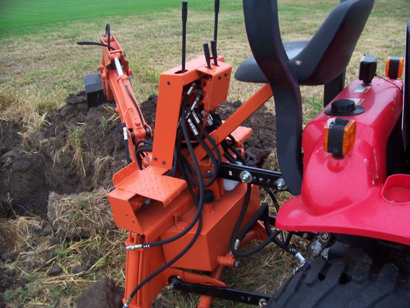

For anybody wondering WTH we are talking about - here are photos showing the two chains that swing the boom side to side. The adjustment bolts at the ends of the chains, are part of a trolley (inside the chassis) that is driven side to side by a hydraulic cylinder.
My BH, has Kubota trademark on it.
101845d1209852791-kubota-mystery-backhoe-does-anyone-p1180632rbackhoechaindetail-jpg
Same thing except with Yanmar trademark. (photo from ebay).
262486d1335419738-yfl-240-loader-ybh-700-a-img_3666-ybh600-ebaypic-jpg

An update: I bought #60 Koch chain and the chainbreaker tool, and successfully replaced the "master" link with a regular one. I guess the Koch chain might not be as strong as some of the other brands out there (HKK?), so we'll have to see how it holds up. Of course, the backhoe is pretty much just going to serve as ballast until spring.
In the mean time, what do you think about adding two more gears and doubling up the chain? Do they even make two-layer roller chain? I would have to widen the slide bar and the blocks at the ends of it so I could add a second pair of tension bolts. Because the gears seem to be welded to the king post, I'd have to cut the lower gear in half to get it around the post, and then weld it back together. The upper one could just slide down over the post.

If it were mine ... and I own the same model ... I think the sensible strategy is just recognize that this or any 3-point backhoe is a light duty implement.
This isn't the same thing as a chassis-mounted hoe. It doesn't have down pressure beyond the weight of the implement itself. It doesn't have the strength to lift a tractor that has locked brakes, to move along the trench, and it will bend the tractor's 3-point arms if you attempt to drag the tractor sideways. (BTDT :().
For me, when I became familiar with its capabilities and limitations I just decided to operate the hoe gently. Specifically, what breaks that swing chain is swinging to one side then moving the swing control in the opposite direction while the arm is swinging at maximum speed. If you can avoid this inertia effect the chain should stay intact. The only hoe action that has as much force as you expect is the bucket curl. Other actions such as trying to use the arm as a crane aren't gong to be satisfactory; the lifting force is designed for nothing more than raising a bucket of earth. I assume these limitations are to minimize stress on the tractor's 3-point components.
Another issue to watch for was quoted to me by a dealer who said he will never sell another 3-point hoe after one that he sold destroyed a tractor: He said its too easy to break a tractor in half at the bell housing if you don't have a sub-chassis similar to a frame mount hoe. (I have this). And he cited several examples of the back ripped out of a tractor's transmission housing, caused by driving too fast over bumps.
I get good use out of my BH but I recognize that unlike the Yanmar tractor, it is possible to use this in a manner that can destroy it.
