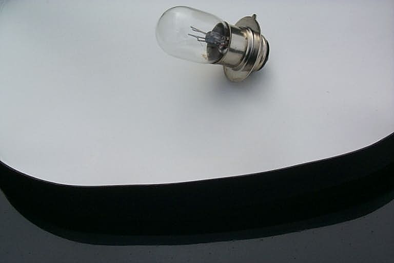

I'd prefer to put in some LED bulbs... but the bulb in my B2150 is a very weird one.
It has a round flange on it. I have looked around wiht no luck... so if you have any sources or suggestions I'm all ears.
I have attached a picture of what my bulb looks like.
Thanks, Tim

Ah yes one of those!!
I did put in higher wattage bulbs in my B3200. Went from 35 to 50 watt with no ill effects. Not sure what your lights are like. You might have a time finding lights to fit those sockets.

The only place I was able to locate a similar bulb with that goofy flange, was on ebay with a site in England and they sell bulbs for Motorcycles.
I went ahead and ordered two 35/35 watt bulbs and I can try them and keep checking the temperature when I install them to see if the plastic lens gets any hotter than with the oem 15/15 watt bulb.
I have always been disappointed by the light output of the headlights on the B2150.
In addition to ordering these 35/35 bulsb, I just completed an alternator upgrade ( to 40 AMP ) and have some LED worklights to install.
I need to light almost exclusively for nighttime snow blowing with my rear blower, but if I have better li[ght, I may be incluined to finish cuttint grass in the summer even after it gets dark.
It's been a real challange to do anything in the dark with the stock lights.
Thanks, Tim

I know it's a pretty old thread.... but I wanted to let everyone know that I did put the 35/35 watt bulbs in to replace the 15/15.
But I am paying the piper now..... I just spent $180 to replace BOTH headlight assemblies because the added heat from the higher wattage bulbs did, in fact, melt the plastic.
It took a while, but it melted the plastic enough that the bulb contacts were not aligned properly in the socket and kept blinking off and on.
So I will be putting in my new headlight assemblies and keeping the oem bulbs.
I bought 4 really good LED lights which make up for the poor lumen output of the oem lights.
I bought the "Rigid" Dually driving lights. And they do the trick without a lot of amp draw.
Although, I did do the alternator upgrade so the Amp draw was not a huge concern anyway.
