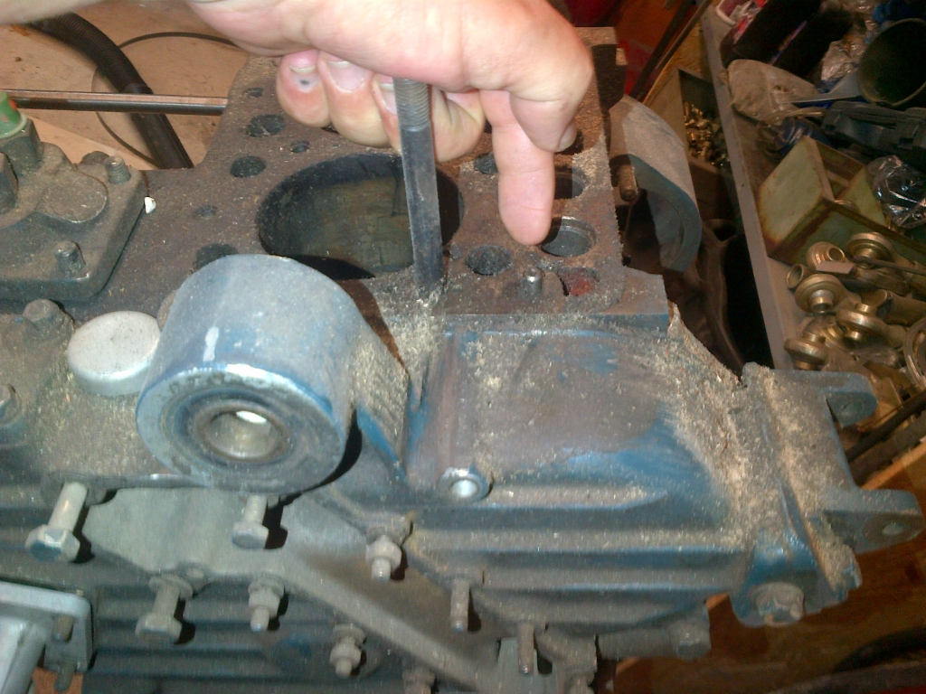

I just spoke with a local guy regarding my issue.
He informs me that the top of the block has a dowel pin which actually acts as an oil gallery.
This requires an o-ring to work properly.
I don't recall seeing an o-ring, may have come off with the head gasket when I replaced it 3 years ago.

/ Kubota head gasket issue
#20
Attached is a picture of the dowel pin which requires an o-ring.
This acts as an oil gallery.
This is also the general area of where my leak is developing.
So.....head bolts arrive today, head gasket arrives next week.
Hopefully this is a job I won't have to do againg for a LONG time.
Thanks all for the great advise.
