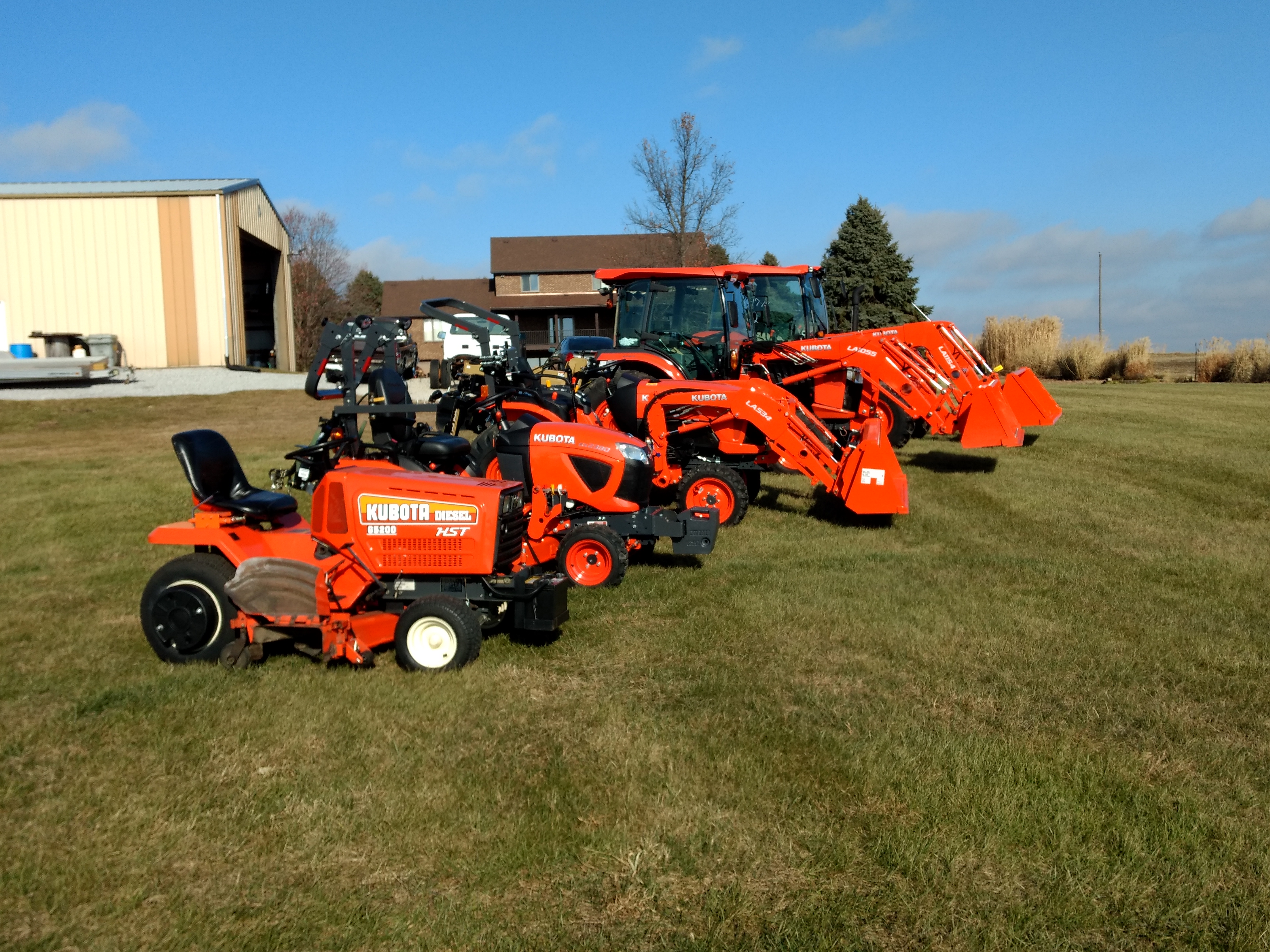

I don't mow with it often, I use my BX2380 the most. I still have it because it looks like new yet. Phone Pics 006 (5).jpgPhone pics 086.jpg

Thanks. I do take pride in my equipment. I like to mow with it now and then, cuts great, very comfortable to use. I did take the slack out of the steering system, makes it much nicer to use. It is a working museum piece, kind of.

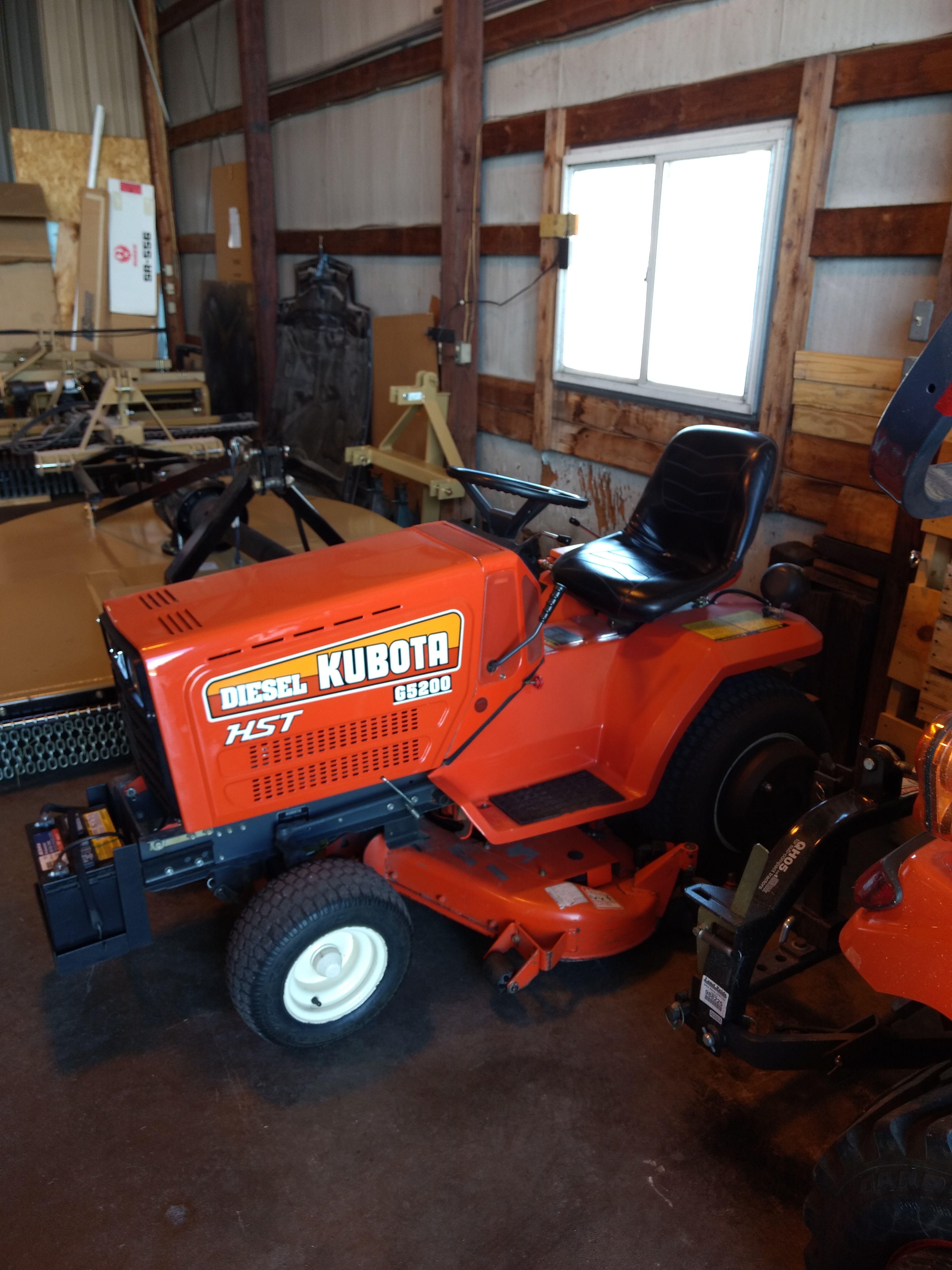

I really like where the battery is placed. Makes it to where the radiator can breath better. Never thought of putting it there.

I put the battery there after replacing the original equipment style battery too many times, I put a group 24P out front and that was the end of my battery problems. It was good ballast when I used my fully mounted sprayer on the back. Shortly after I bought it in 1993 I put the hydraulic deck lift kit on it and bought a bagger for it also. The 44" deck in heavy grass and the bagger, made it snort a bit. I bought a BX2200 to mow with in 2002, nice machine, but the G5200 was more comfortable to drive. As you can see in the picture, I kinda like Kubotas.
