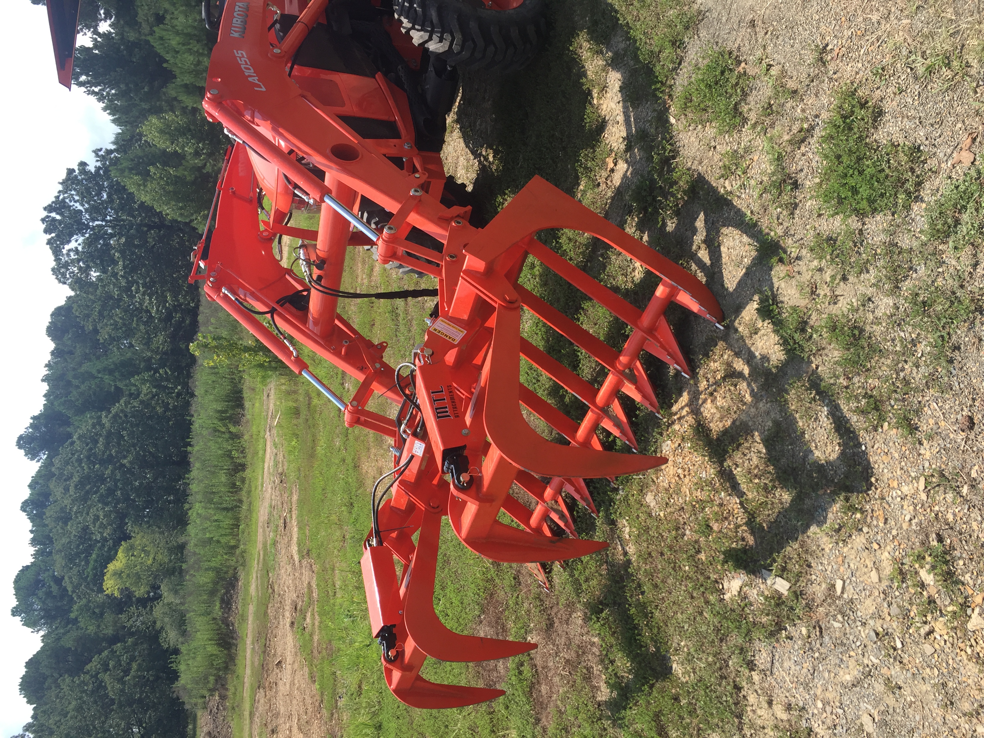

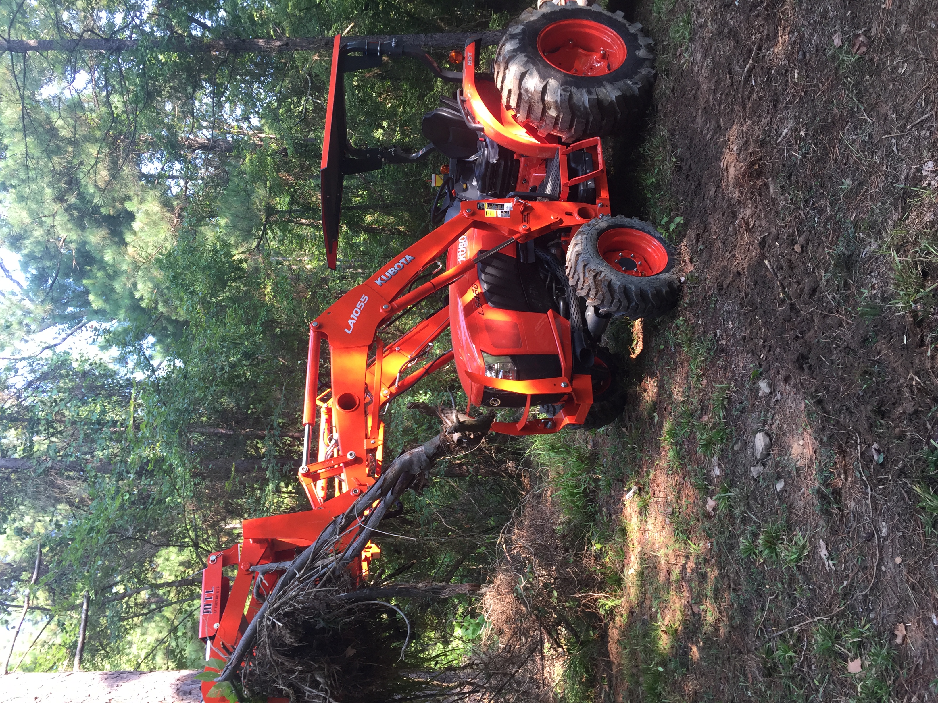

Got to use my grapple for the 1st time today and I really like it,got a lot clearing done in a short amount of time.. Guys not sure why my pictures are showing up sideways,what am I doing wrong?
