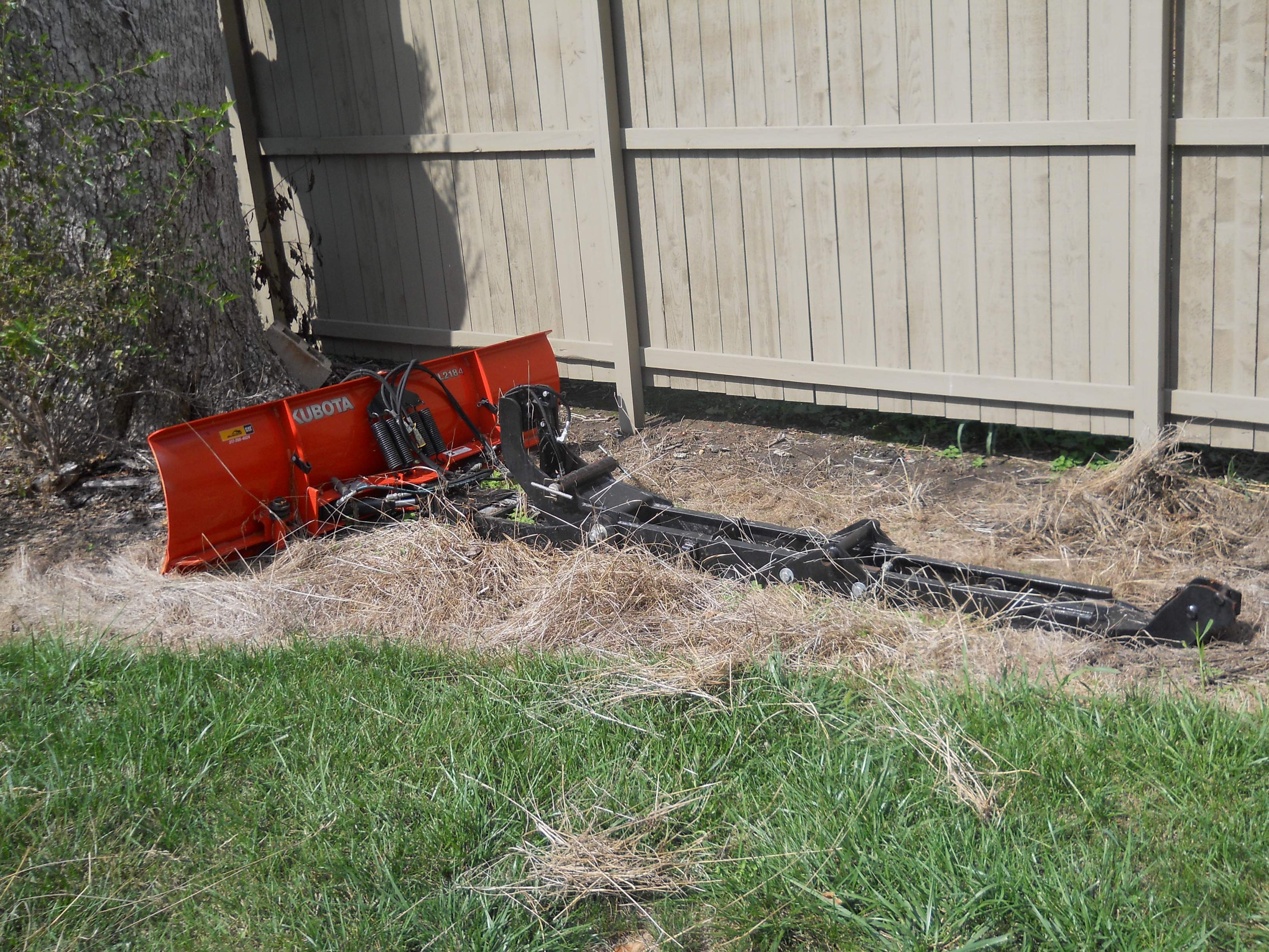

I have the subframe for a snow plow blade, but not the autohitch front end, on my L3940. Yes, the are using the mid pto for power. The subframe is not that easy to put on, especially if kept on the bare ground like mine. Takes maybe +/- 15 minutes, so I only put on for the snow season. On my tractor, I cannot leave the subframe on and mount the fel. Philip.
I really like your plow setup. I like how they Kubota frame ties into the drawbar. The setup I had on the Bobcat for the snowblower was not nearly as nice. It just bolted to the front of the frame. IDK how well the frame would hold up if you had a blade on it. The snowblower also had an adapter on it to fit the Bobcat quick hitch. If I can sell my SSQA blade for a decent price I am going to make a frame mount plow. I was scared to get a tractor specific attachment like the Kubota frame mount blade after the Bobcat was a dud. I wanted something that was versatile so if the L4240 did not work out I could use it on another brand tractor.
