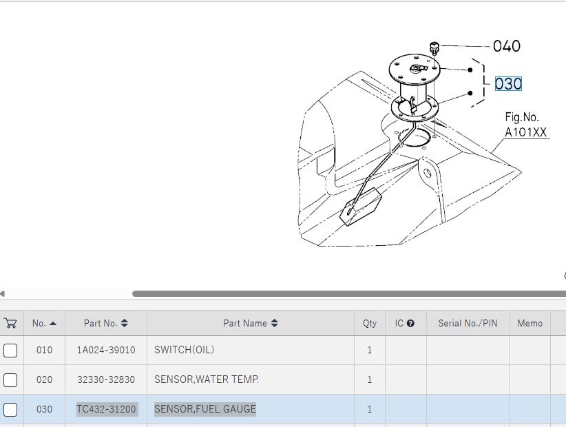

This is not mine... this is from a video here
Anyone else seen this kind of corrosion on their fuel sending unit/fuel gauge hardware? Mainly to ask -- is there some manufacturer of these things to avoid or ... Kubota's been pretty consistent with who makes these for them and ... it is what it is... gotta take the whole dash off to get to the sucker.
   / L4600H - Fuel Gauge Assembly corrosion #2
For what it’s worth, that sensor is only used on three Kubota models (L4600DT, L4600F, & L4600H) making it somewhat unique.
The sensor on my L3240HST is used in 29 models.
so I guess not likely finding any 3rd party alternate from the great-corroded mess version?
