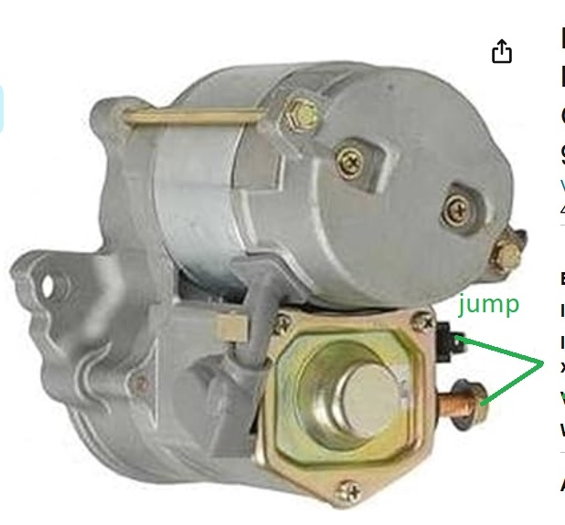

New here guys. I own a kubota f2400. When I try and start it the starter just clicks once in awhile it'll turn over for a quarter of a second. Any way I can maybe bypass it? I get the idea behind it I just don't know exactly how to do it what points I touch to bypass.

Jumping a starter is easy and my marked up photo shows you how.
You need to recognize that doing this bypasses any safety device on your machine. It is best to have someone in the seat.
Expect a few small sparks as you jump the two terminals
I would like to see a photo of the top of your battery and a second photo where the negative cable connects to the frame

Nice explanation DAVE..
U can buy a tool with alligator clips that has a push button on it..
U can hook it up and stand back or get in the seat AND THEN push the button to crank the engine..
It’s called a: STARTER BUTTON.
MOST auto parts stores will have 1..

Thanks guys I will try. My selenpid does not look like the one above unfortunately though
