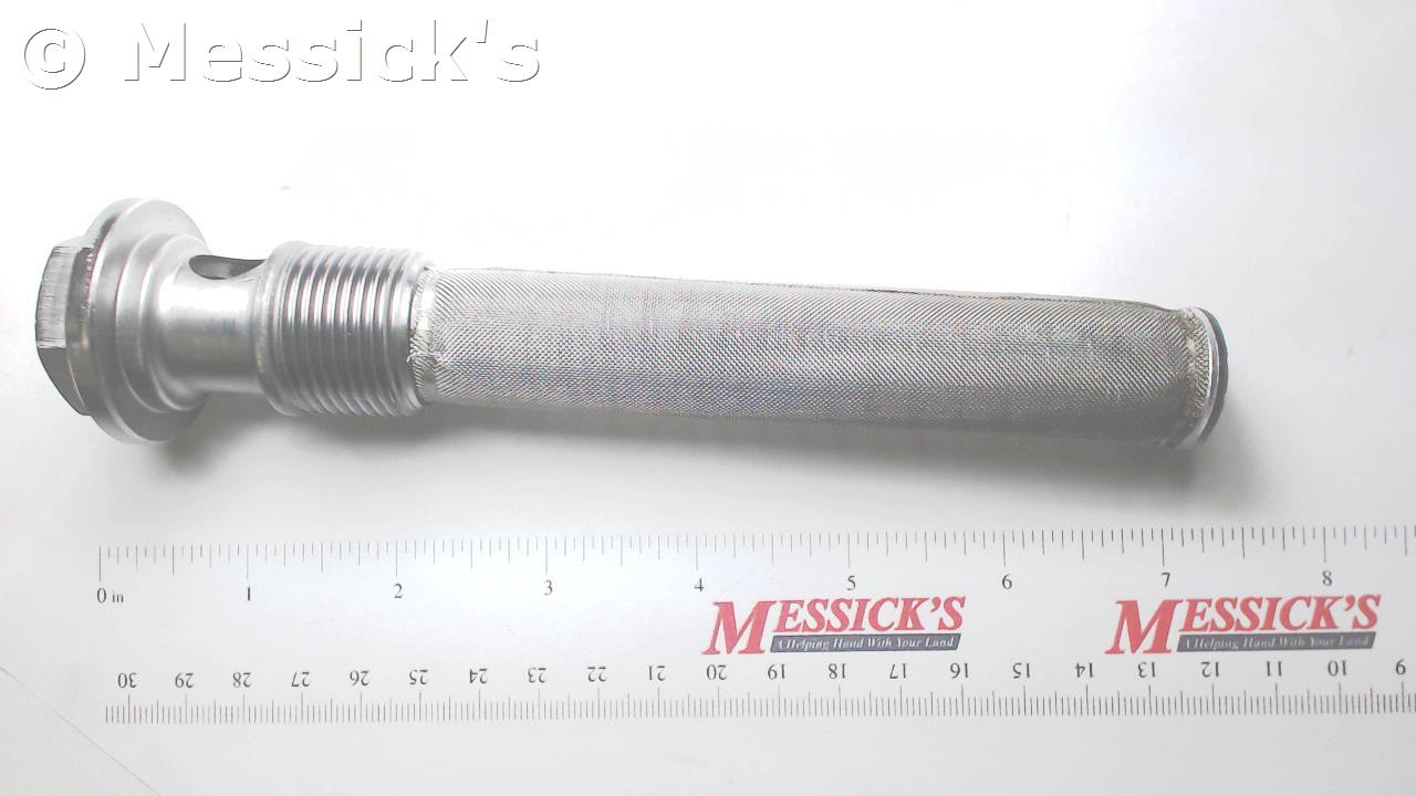

May 30, 2015 / Kubota bx23 #1 L Lcarico12 New member Joined May 30, 2015 Messages 2 Location wayne, wv Tractor kubota bx23 i have a kubota bx23. I had a hyd fitting leak. Changed the fitting. Was low on hyd fluid so I changed filter and oil. Now my attachments ( bucket , backhoe) will not work. They are very slow. What do I do.

May 30, 2015 / Kubota bx23 #2 J_J Super Star Member Joined Sep 6, 2003 Messages 18,973 Location JACKSONVILLE, FL Tractor Power-Trac 1445, KUBOTA B-9200HST Just cycle through the hyd about 5 times, and the prime should re-establish, and any air should be purged.

May 31, 2015 / Kubota bx23 Thread Starter #3 OP L Lcarico12 New member Joined May 30, 2015 Messages 2 Location wayne, wv Tractor kubota bx23 Ok having no luck with this. I have been running it for 2 hours and it is no better. Any other ideals.

May 31, 2015 / Kubota bx23 #4 J_J Super Star Member Joined Sep 6, 2003 Messages 18,973 Location JACKSONVILLE, FL Tractor Power-Trac 1445, KUBOTA B-9200HST Did you clean or replace the hyd filter from the sump. Kubota BX23 | Messicks's Attachments SUMP FILTER.jpg 76.8 KB · Views: 197
