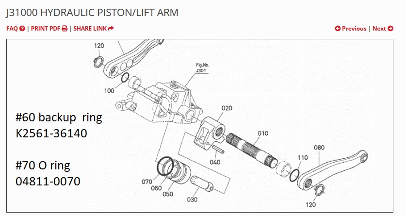

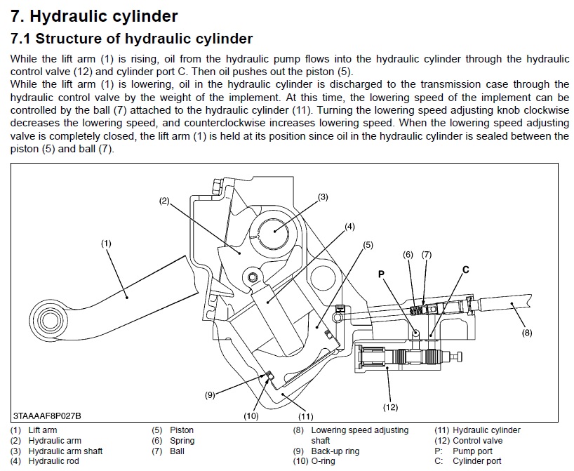

/ Kubota BX23 3 point bleed #6
Typically the problem comes down to worn O ring and backup ring on the 3 pt piston.
The pdf file and second jpg file is from the WSM and gives you an overly simplified view of what is involved.
Seats and braces have to be removed just to get to the piston.
Dave M7040

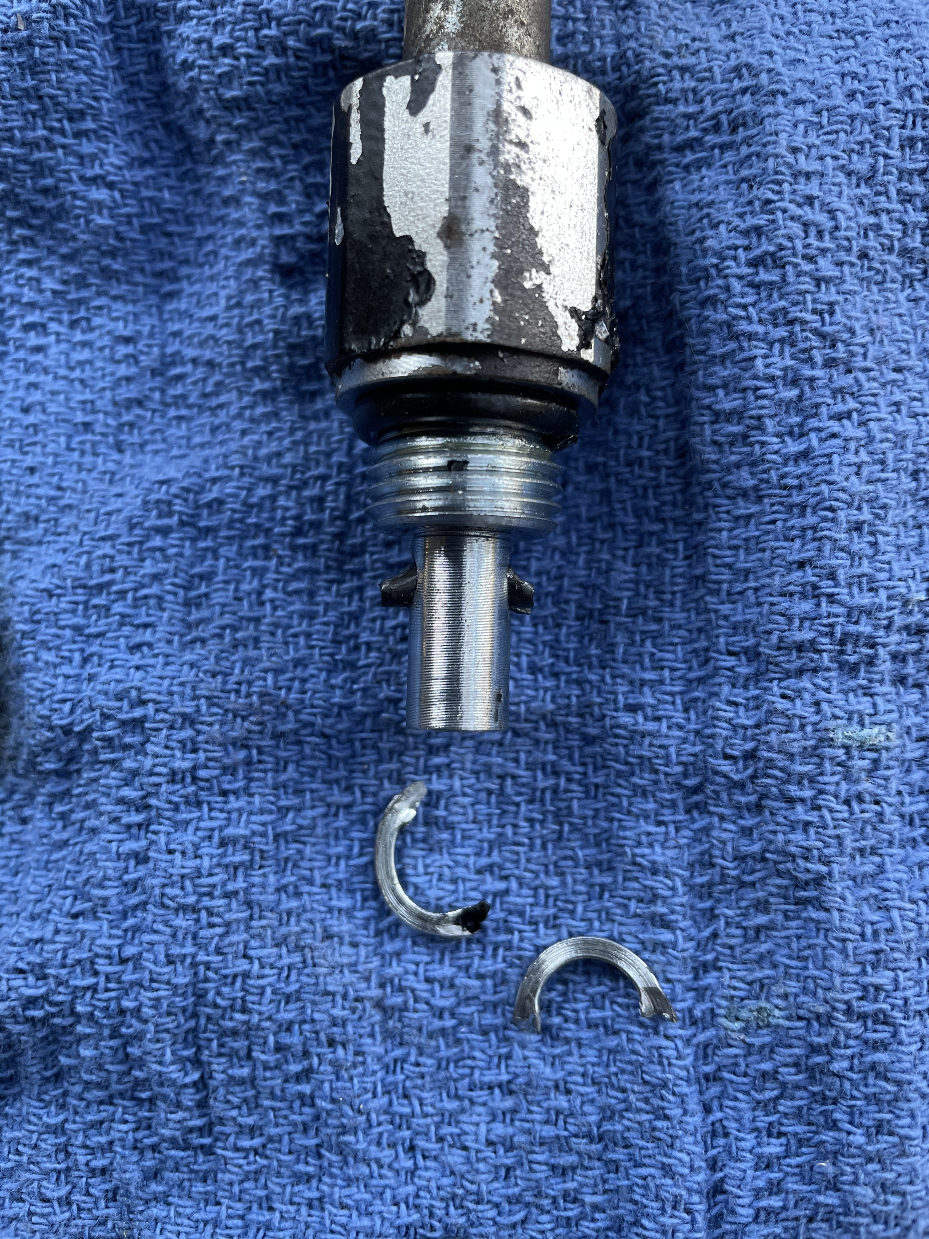

/ Kubota BX23 3 point bleed #7
Did you figure it out? This is what I found on mine when I removed the back hoe for the first time on my cub Someone had used a wrench and caused some damaged threads and split the stop washer
