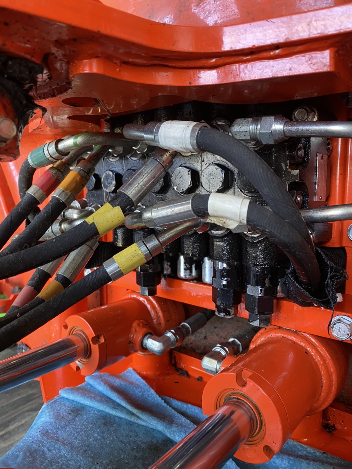

If it were my machine & I was to be the only or at least main operator, I'd convert the machine to what I wanted (assuming the relief plumbing was compatible).
You can translate back & forth, but on something like that you are fighting muscle memory every time you switch. I have minor issues going between my HST tredal & a JD double pedal HST. Not a big deal, but takes minor re-training your muscle memory. I could get as proficient on the JD as my Kubota, but not with the few hours a year I put on the JD or switching back & forth.
I've used a couple backhoes & miniexes, but not enough to generate the muscle memory or preference for one pattern over another. Id probably go for ISO over SAE as its more common. Although that's another one of those things where the US is different than the rest of the world (SAE is uncommon outside of the US).

I switched the lines on my BX23S and is so much easier to operate. I'm looking for SAE decals to replace the ISO control decals. Anyone find some that fit over the stock ones and will stay put?

I haven't looked at it yet, but not going to do anything until spring. My dealer owner/salesman told me they have switched a couple in the past but he said it a real in the butt.
I tried it out with some ditching on one of my bush roads. I can manage, just not always smooth and flowing because sometimes my brain goes back to Cat controls, LOL
Got my son to start practicing too. Easier for him to get used to because he has never run one before.
