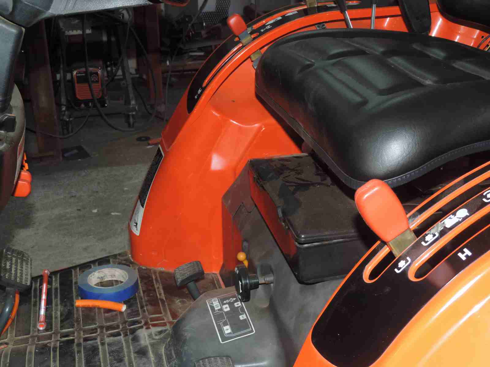

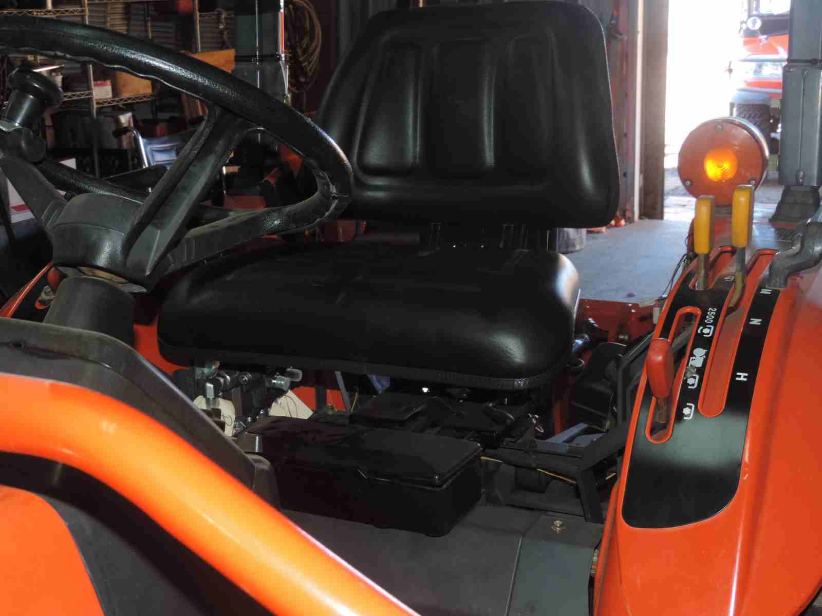

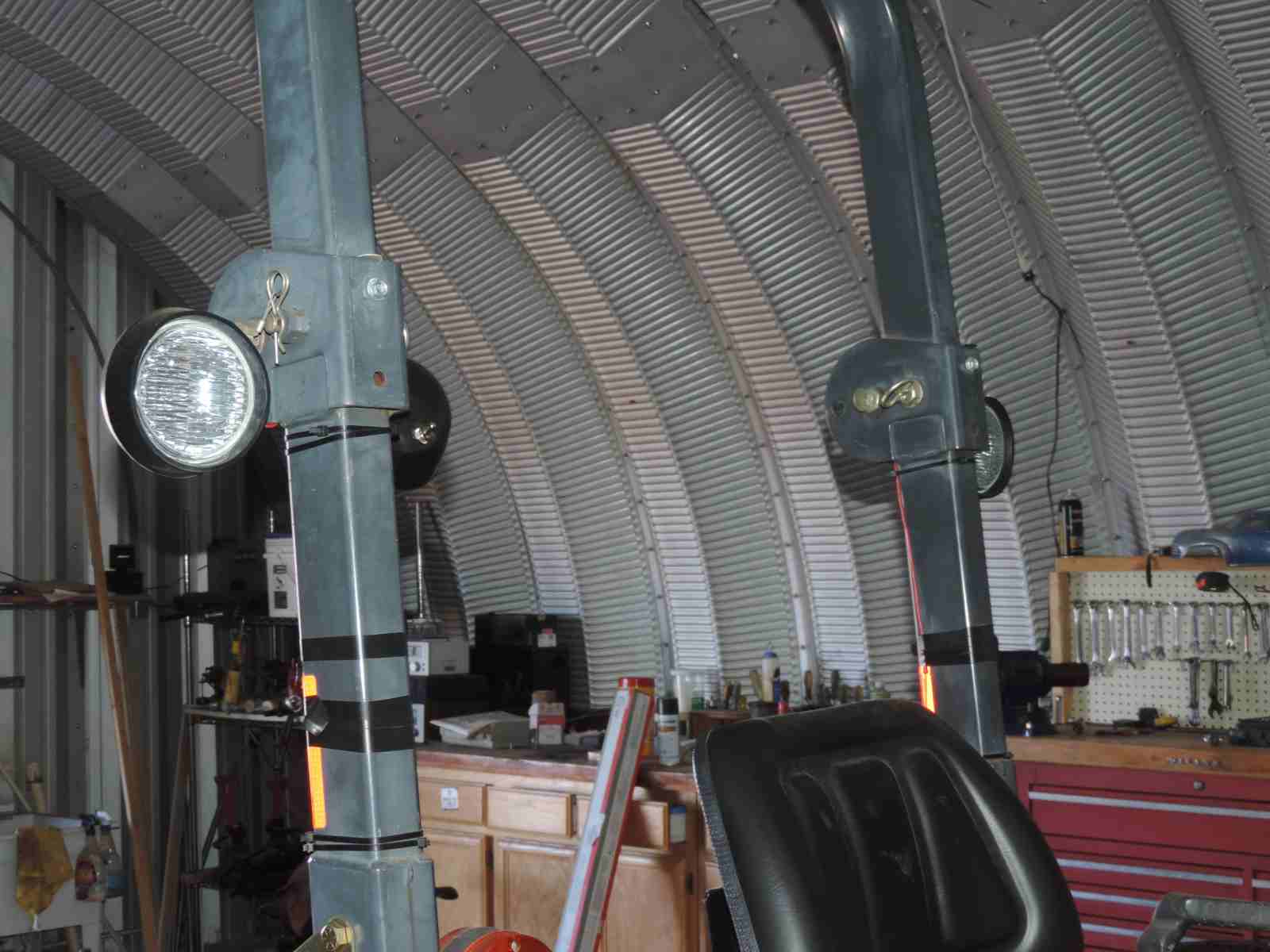

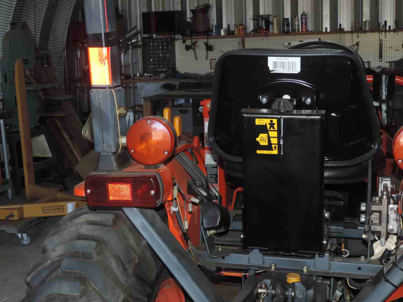

I ordered the suspension seat from Northern tool for 99.00. Actually a very nice seat, adjustable with springs and a shock absorber. A whole lot more comfortable than the factory seat. Install was fairly simple, I had to re drill the front holes and made a cross piece for the rear holes. I disconnected the safety switches and bypassed them. Also the tool box is normally under the seat and since the new seat does not hinge up I relocated it to the front underside of the new seat, great fit and I prefer the location (do not have to raise the seat to get into the tool box.. I will be posting pictures a little later.....

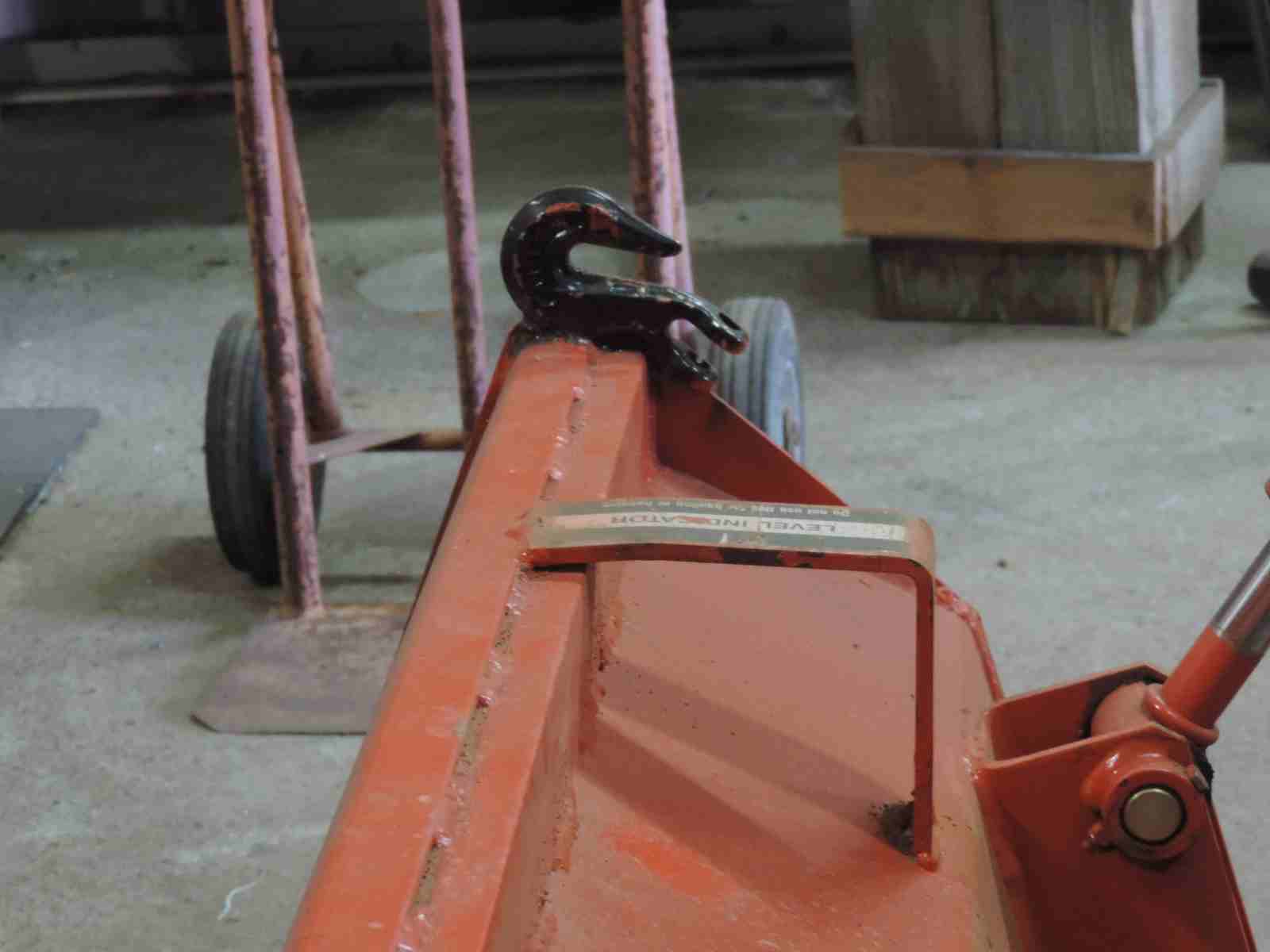

1. Angle iron welded on top of the bucket to add support to keep it from bowing also chain hooks.

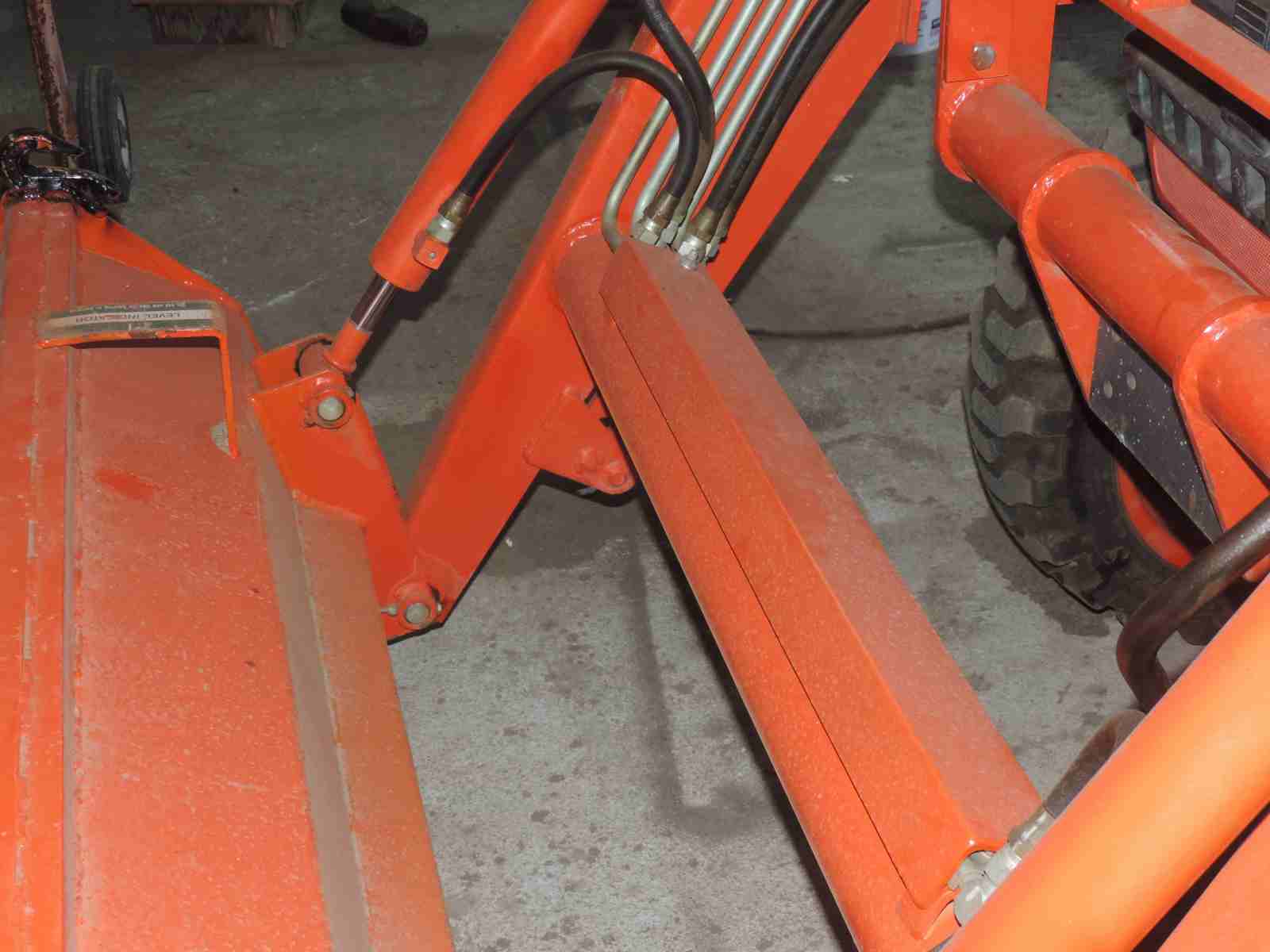

2. angle iron to protect hydraulic lines that cross over behind bucket
3. suspension seat and relocated original tool box
4. suspension seat and relocated original tool box

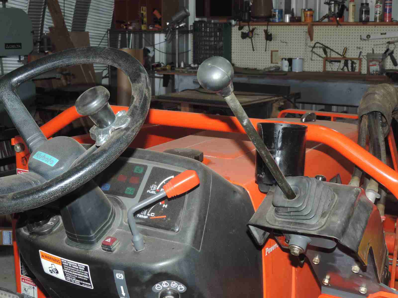

5. cup holder and suicide knob

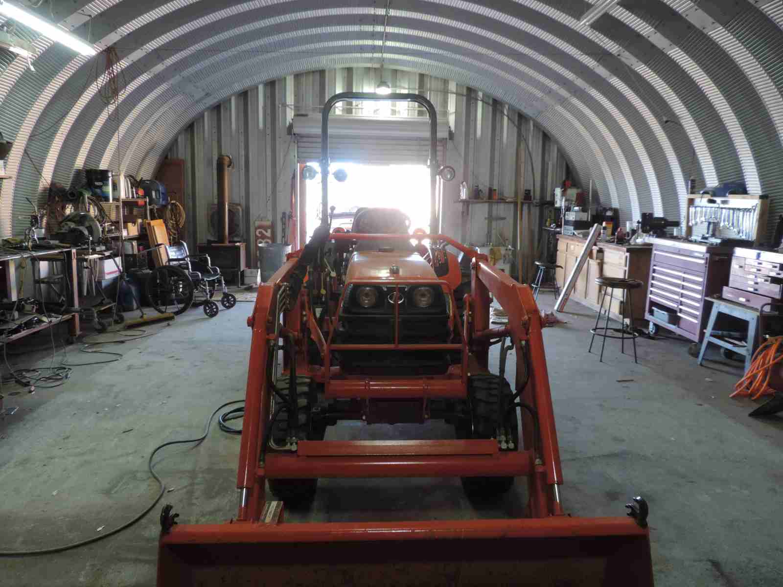

6. work lites
7. back of suspension seat

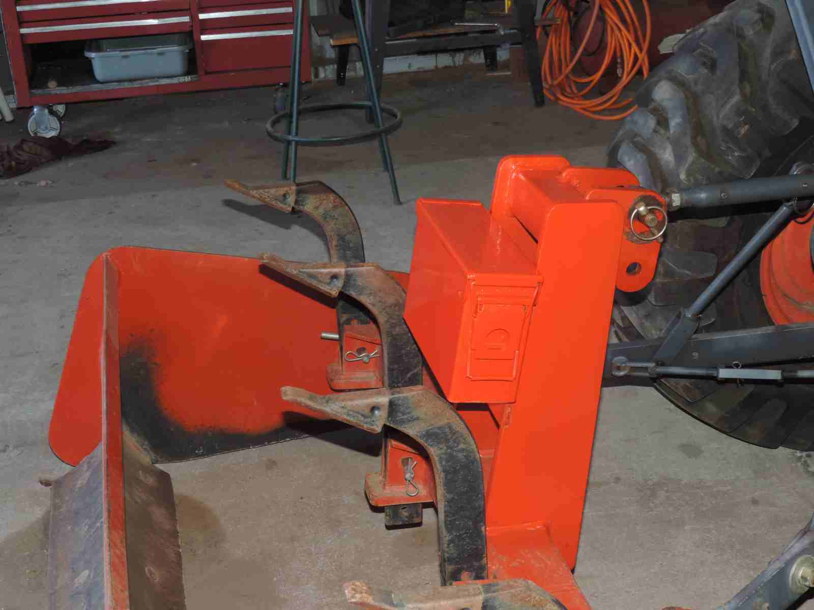

8. xtra tool box attached to box scraper (old ammo can) water proof

Seat is very comfortable in comparison to the factory, takes the jolts out.... Almost every tractor I looked at had 3 things in common, the top of the bucket bent down, the hydraulic lines bent or crushed, and the leading edge of the hood damaged. So with every tractor I have had I reinforce the top of the bucket, add protection to the hydraulic lines, and if it does not have one build a brush guard.
