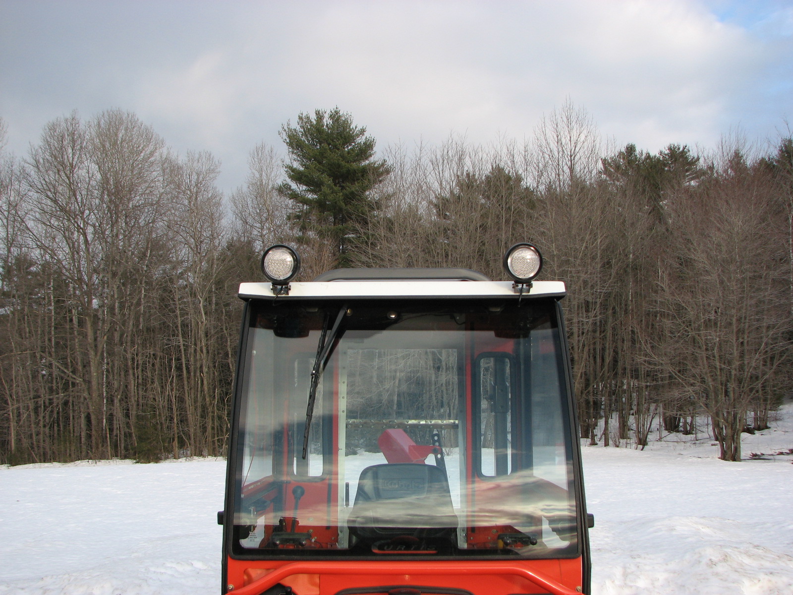

Yeah, bigdad
I was expecting more from the LEDs Bulbs in the Headlight position too.
Agreed, Work lights are the way to go.
I presently have two rear facing 35 watt work lights.
I what to replace the 35 watt lights with LEDs, plus add two forward facing LEDs,
mounted on my curtis cab just below the ROPS.
UPS just delivered four LED work lights Friday, but Two of the four LED Work lights I received are messed up, One had 3 LEDs not lighting, and the other had 6 LEDs not lighting. Each Work Light has 54 LEDs. (34 bucks a piece)
Hopefully I can get two good replacements soon.

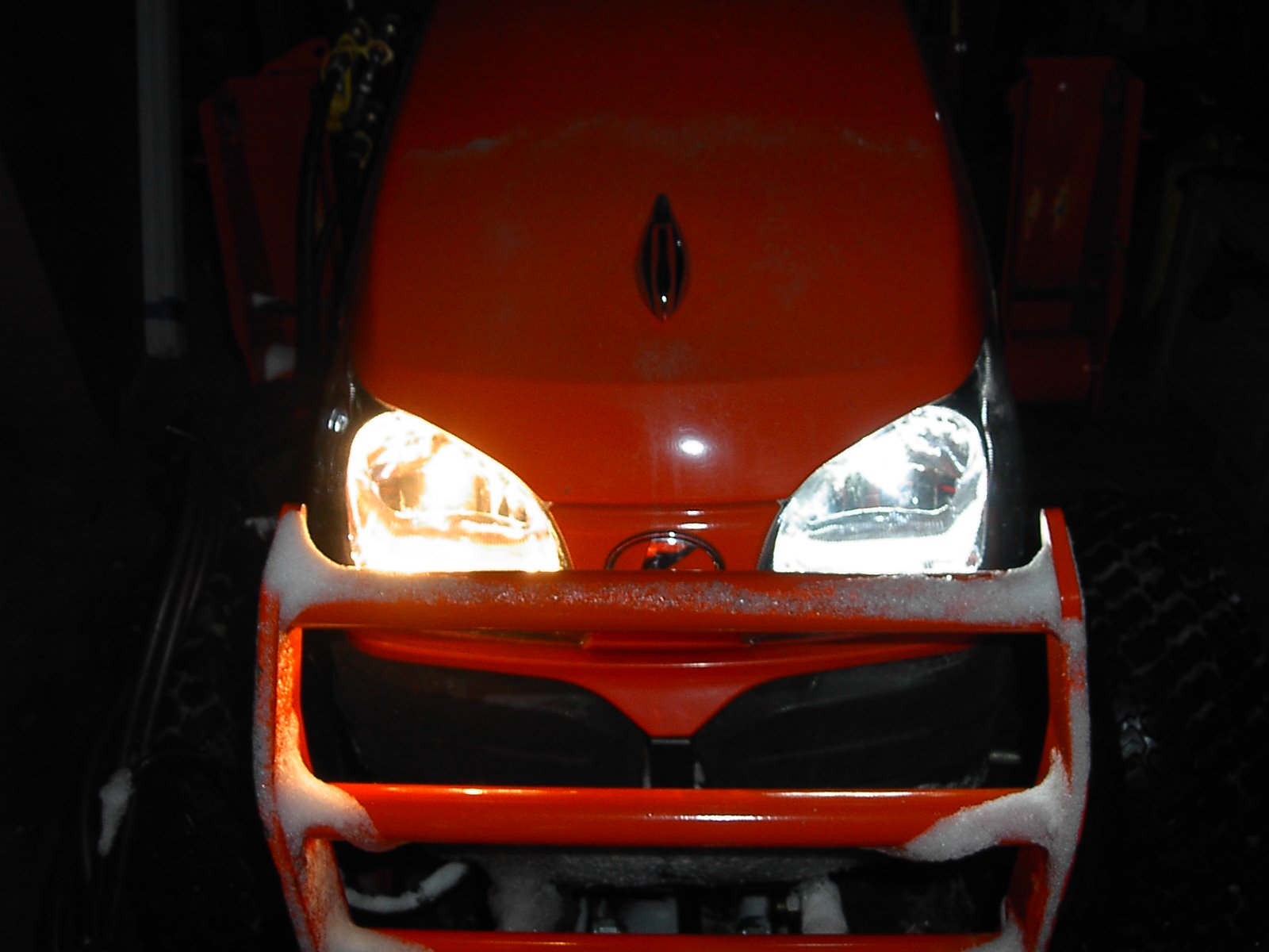

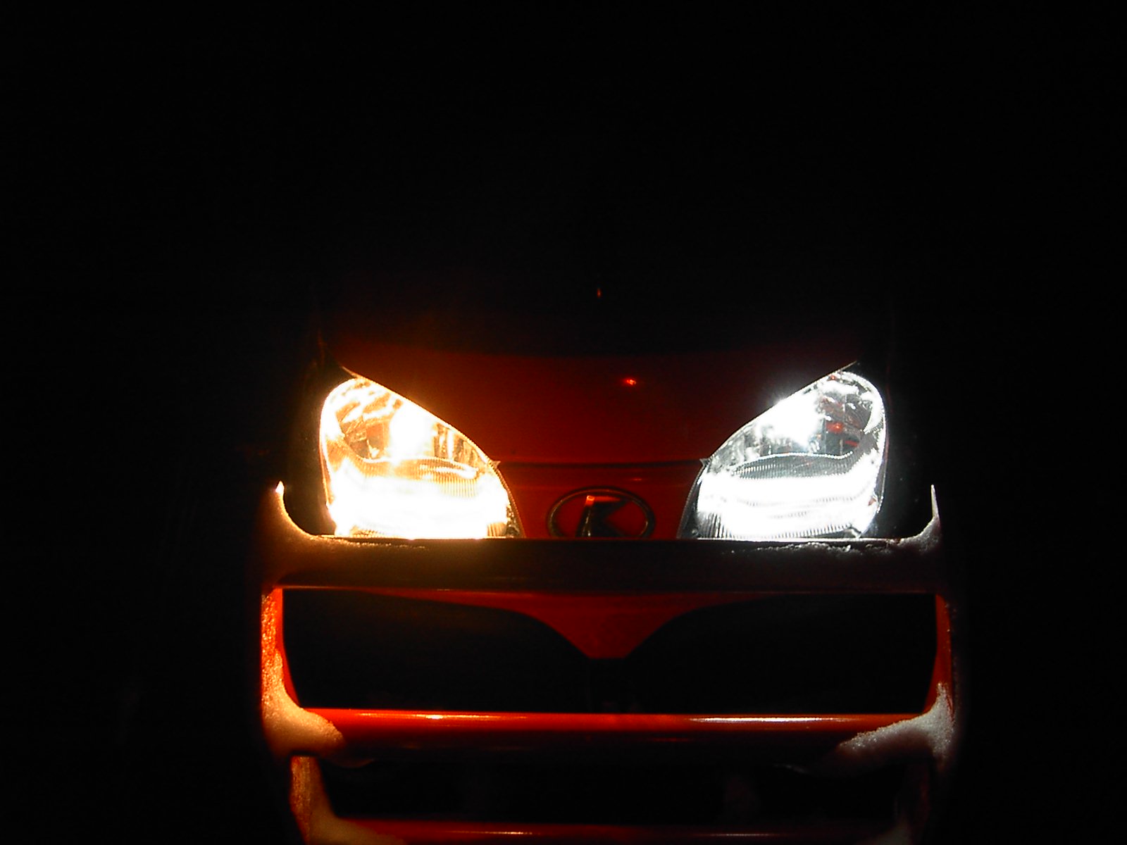

I ordered a pair of the 360 degree 18 LED bulbs and installed them. (B7510) One photo shows the direct straight forward LED bulb on the right and the newer 360 on the left. The second picture shows both 360's installed. The picure doesn't really show the difference in illumination, but I can tell the difference. As we suspected, the utilization of the reflector is the key.
One thing I noticed. The LED configuration is different as far as, instead of the little round globes, these are little square wafer emitters. The LED's in the new Mag-lite flashlights are the same wafer type. BTW, those new Mag-lites fill the ticket!!!
bigdad
I can see a difference in the two photo's.
(I agree that photo's don't really show everything you see in real time)
I think I was actually looking at those same 360 LED on the web site
SUPER BRIGHT LEDS - LED Lights & Accessories I think it is ?
From what I was seeing on the web site, I really couldn't figure out how the leds were arranged. But now that you mention wafers, I can now see what's going on.
I see they are two white bulbs listed a 1156-CW18-T Cool White
and a 1156-WW18-T Warm White
Which ones did you get ?

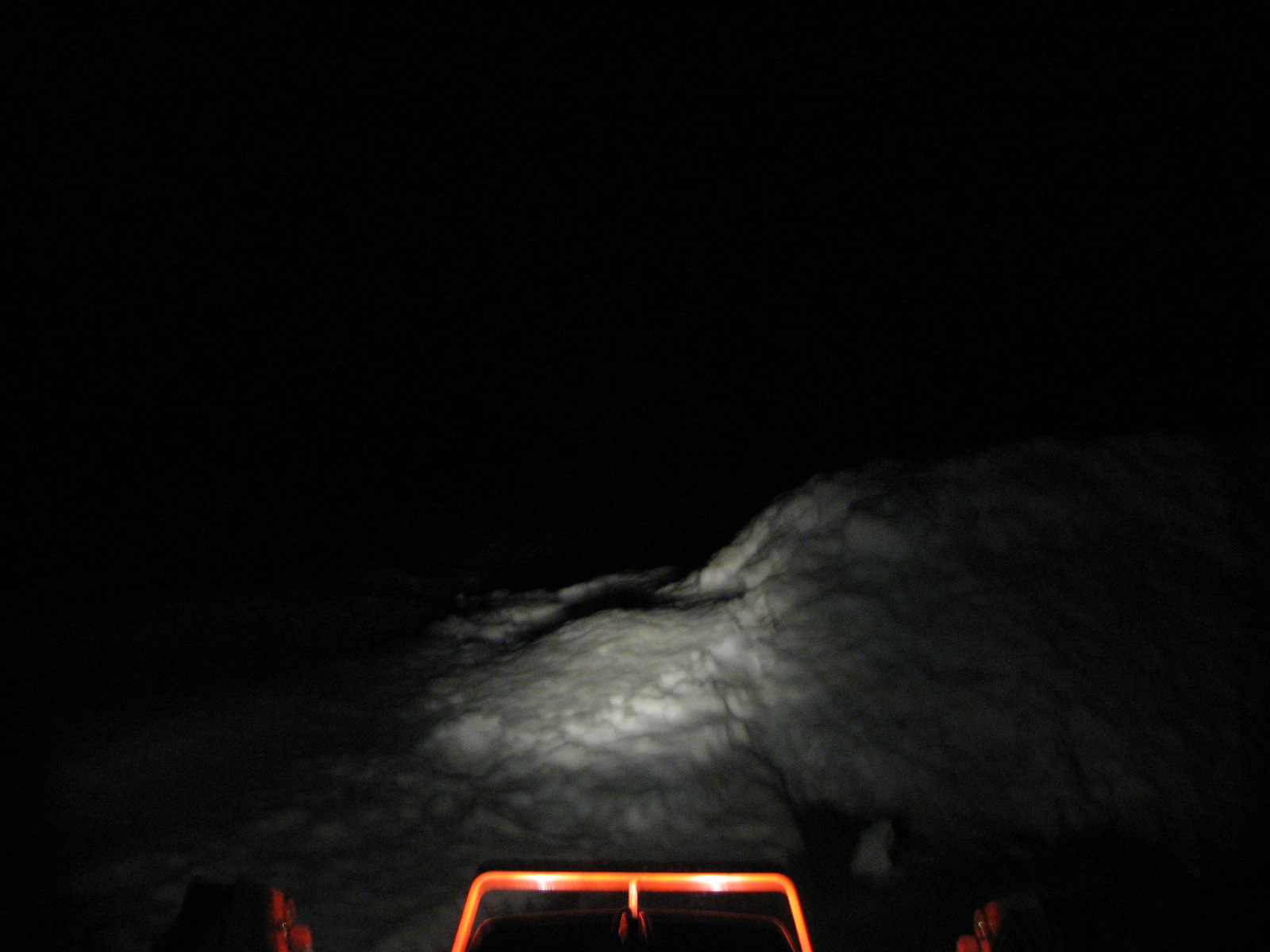

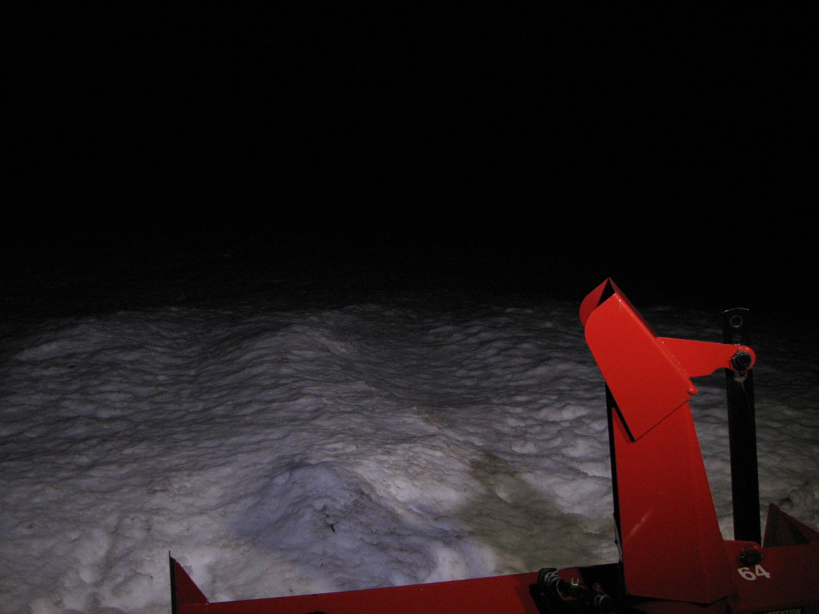

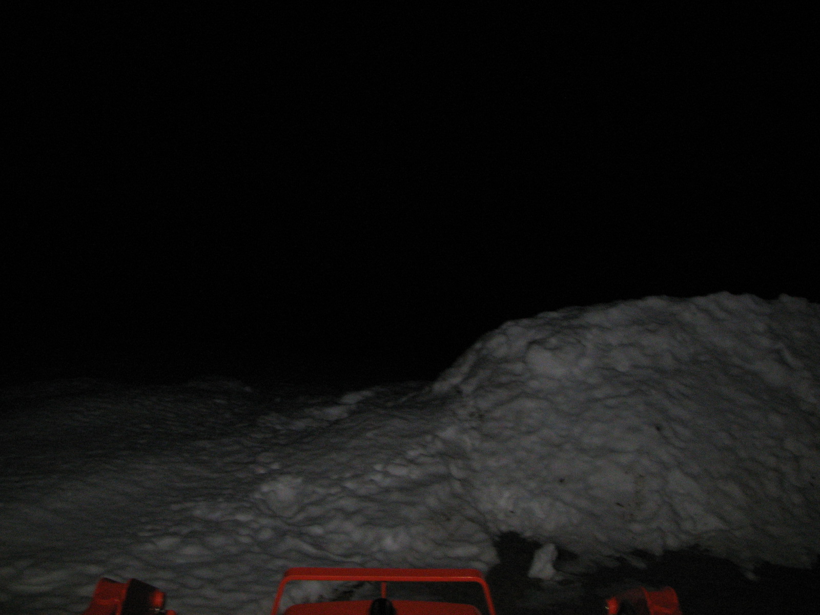

I finally got my Led work lights installed.
I originally ordered 4 and 2 were messed up.
I got my 2 replacements.
My old rearward 30 watt incandesants had more of a spot in them than do these Led.
So with the incandesants I could see farther but at a narrower field.
The Leds really spread out the light, really wide field, but I don't see as far.
Which is ok, better actually
I really like the wide field much better and the light has a brighter hue.
It'll be interesting to see how well this wide bright field is in a snowstorm.
I hope it's not too bright.
The 4th picture is the stock B7800 incandesant headlights.
All the others are Led.
Real world looks better than photo's.
Could be the dirty winshield too.
dhd
