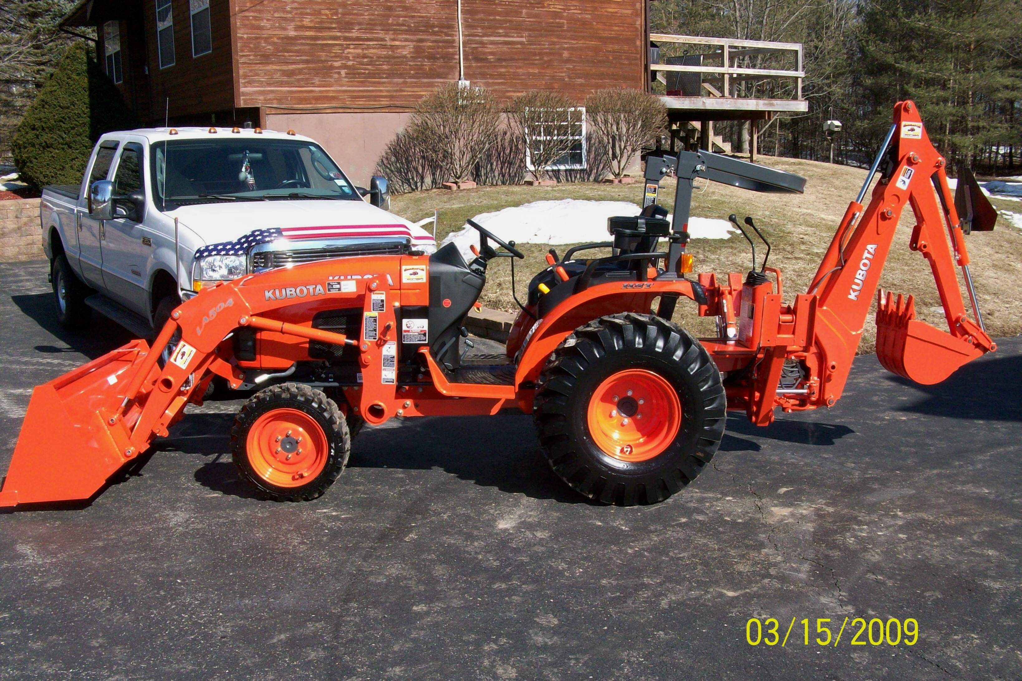

What would be a good price for a B3200 with loader? 60" MMM? Backhoe w/12" bucket?
/ Kubota B3200?? #20
You mean like this? Go to Kubota. com and do a build my Kubota, you can add most options and see the price. Perfect size Tractor for me, right size and power, Good Luck
